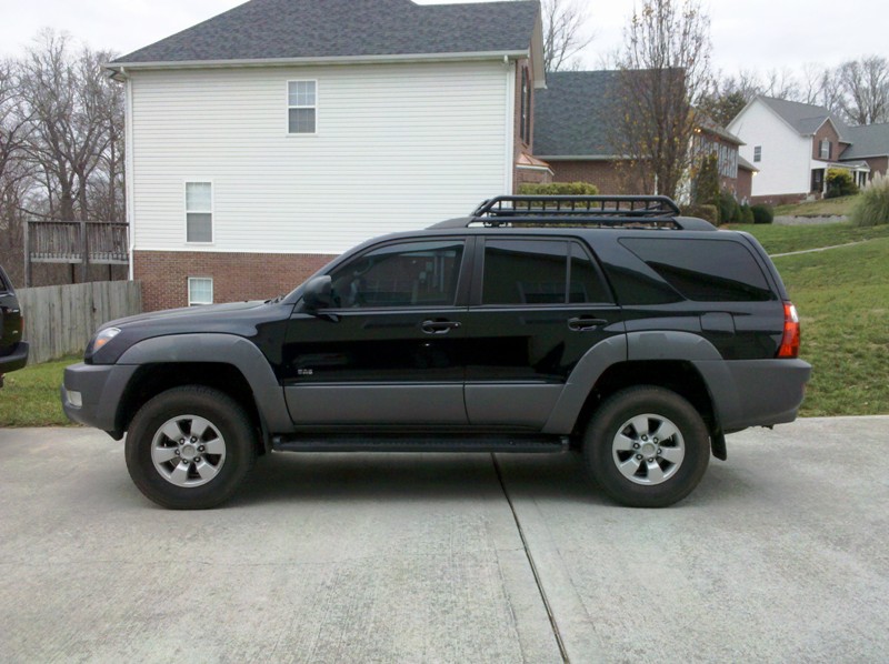

It turned out good, I wish the front was just a hair higher but I really think 1.75" would have been too much if I ever had any gear in the trunk or people in the rear seats.
The truck rides so much better too. Very happy.
Currently running 265/65 Revos, I'm going to step up to 265/70s when they wear out.

You should put FJC coils on it and move to 1.75" setting. I love it.
Looks good though, rides way better doesn't it?

Yeah I thought this was one nimble SUV before the 5100s ... they just give it a more solid and controlled feel.
I realize this is one of the more stockish looking rigs on this site... Yeah I did think about trying to track down some FJ springs or doing a 1.5" spacer for the rear and going the full 2.5 up front but...
These 5 Revos I have are lasting FOREVER and will still likely go another year possibly 2 and I hate the way a lifted rig looks on little tires, so maybe down the road I'll bump it up more. Really this whole upgrade started with just wanting to replace 1 leaky front strut... lol

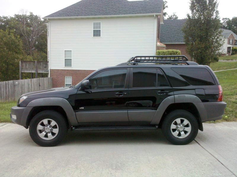

I also installed my 5100s yesterday on the .85" setting with stock springs. Same result here - I wish it was just slightly higher in the front. I'll save that for another day with FJ springs and larger tires.
The difference in ride was amazing. I was getting a lot of bump steer and now that is totally gone. Truck corners better too.

Installed a set of FJ springs over the Thanksgiving break. Kept the 5100s at the .85" setting and now I am sitting a little high in the front. Probably due to my truck being a V6 and 2wd. Will live with it for a week or so and see if it grows on me - otherwise I will lower the shock setting or throw a small spacer on the back.
Unfortunately my dad had the truck up in the air before I could take some measurements, but it did gain some good lift - and is much firmer going around corners which I really like!

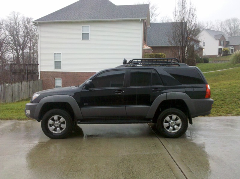

I had my 5100s in the garage for a month and I was going back and forth trying to decide between .8 and 1.75. I installed them this weekend and I ended up setting the fronts at 1.75 with the stock springs. I'm going to go get it aligned tomorrow. The front camber is a bit off now, but everything else feels fine on the road, and it rides and handles much better. All the wallowing is gone.
I'll be getting bigger wheels and 1 inch taller tires next week (265/65/18).

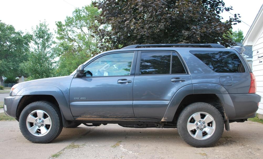

I threw on a set of Daystar 1.5" rear spacers on the FJ coils to raise up the back. If you will see the pic I posted earlier in this thread, my 2wd V6 was a little nose high after I installed the 5100s at .85" and a set of FJ coils. What do you think? My dad teases me the truck is playing seesaw with me...front down, front up, front down. I think I am getting close though and it rides great. Just need a set of tires to go with the lift.
That looks just right to me. I like a little rake. I think you may have it :bravo:
