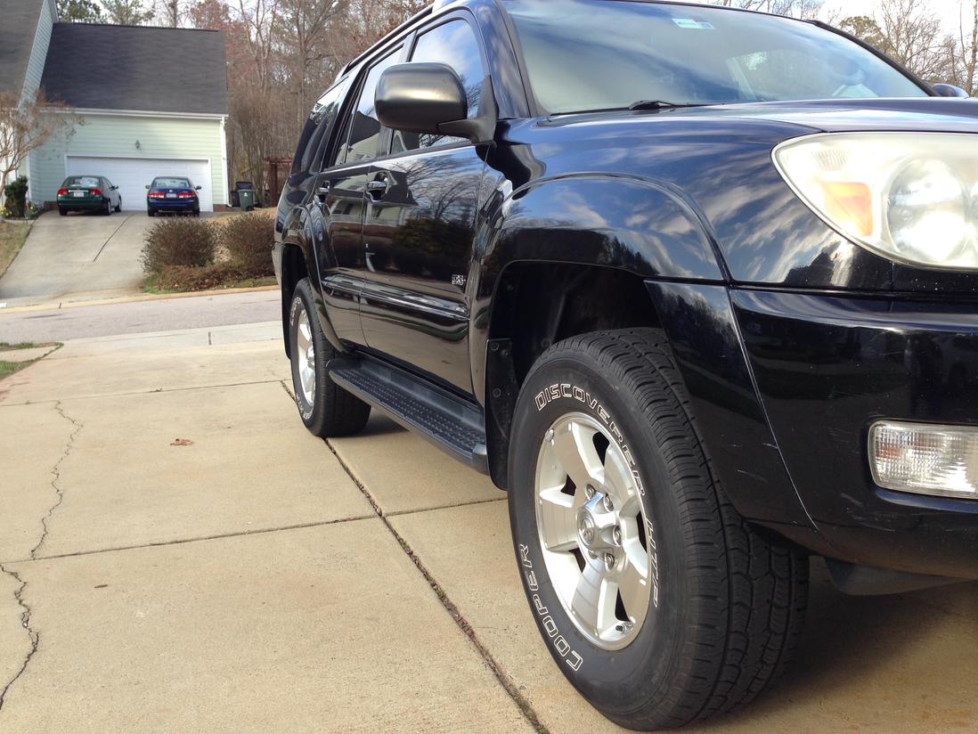

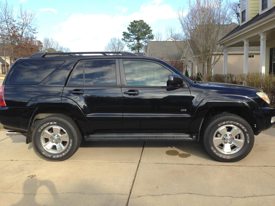

Here are the Pics I promised. Black makes it hard to see wheel wells in the side pic.
Installed a set of FJ springs over the Thanksgiving break. Kept the 5100s at the .85" setting and now I am sitting a little high in the front. Probably due to my truck being a V6 and 2wd. Will live with it for a week or so and see if it grows on me - otherwise I will lower the shock setting or throw a small spacer on the back.
Unfortunately my dad had the truck up in the air before I could take some measurements, but it did gain some good lift - and is much firmer going around corners which I really like!
Is this picture with the daystar 1.5 space in the rear?
It turned out good, I wish the front was just a hair higher but I really think 1.75" would have been too much if I ever had any gear in the trunk or people in the rear seats.
The truck rides so much better too. Very happy.

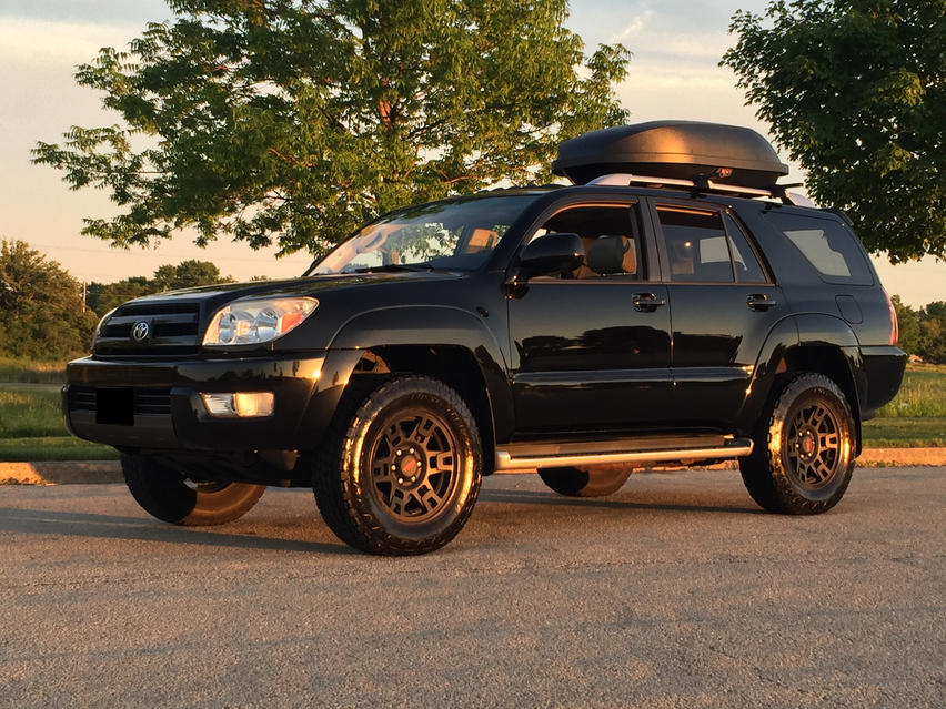

Currently running 265/65 Revos, I'm going to step up to 265/70s when they wear out.
If you ever consider the fj springs, Herr they are at 1.75" setting with 5100's and a 1" cornfrd spacer. Rides great.
