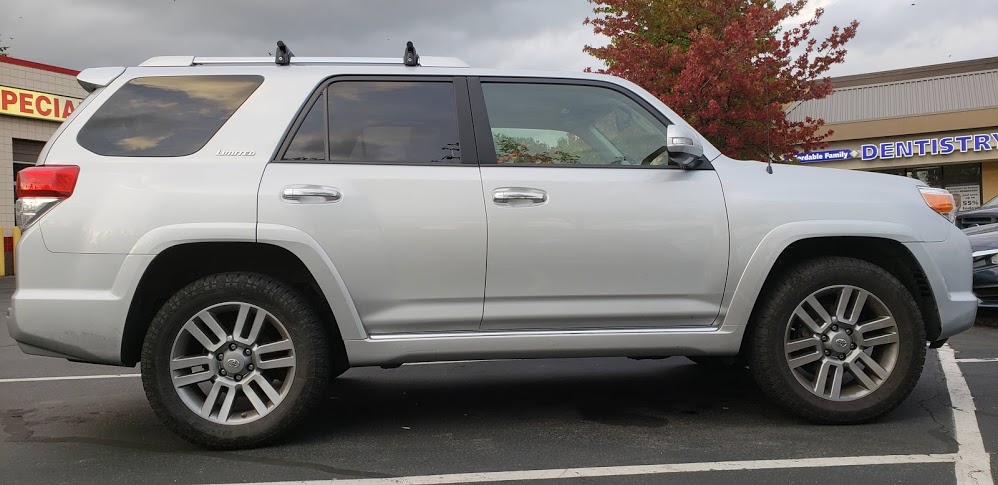

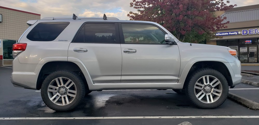

Swap done. I used Toyota Specialists of Bothell (north of Seattle). Here are some before/after pics. Overall VERY happy with the look. Its a DD, so I wasn't looking for monster truck. Just a "more proud" stance. I would say the ride is good. Haven't had it out a lot yet. Cornering is not as nice as the XREAS, but ride over potholes/bumps seems better than the blown XREAS for sure. The Bilsteins are a stiff shock, but not too stiff. Gave a new car type feel. I will definitely need to have the alignment done as both front wheels have some toe out camber. But it looks soooooo much better and overall was about 1150 CHEAPER than having the dealership replace the XREAS. Plus the guy said if I ever wanted it put back on that all the lines are there and it could be reconnected. I'm assuming he disconnected at the most distal check valves. 90k service done too!
