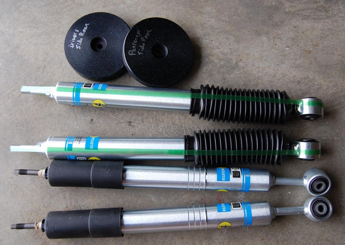

Bilstein 5100's & Cornfed spacers arrived

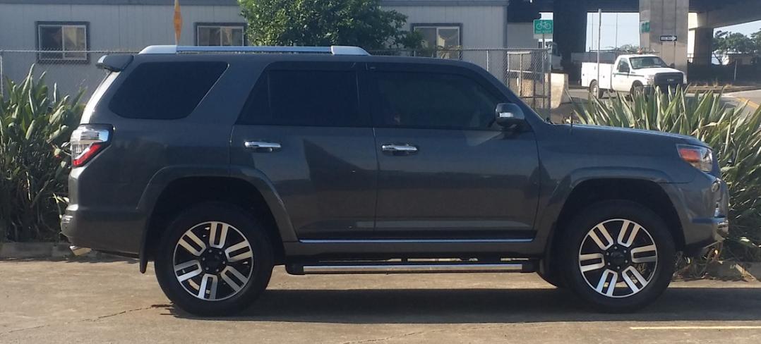

Pic above also appears to have more rake than the red one on the first page with the same setup.
Pic above also appears to have more rake than the red one one the first page with the same setup.
Thats what i wasnt to sure about either one has more rake than the other. The red one looks perfectly leveled and the gray has a rake. The reason i ask is im going with the same set up and i like how the red looks with the set up, then i see the gray same set up and it has a rake.

Heres the end result with bilstein 5100s all around [email protected] & 1"cornfeds rears.

Looking good.

Received all the parts.
The cornfed spacers arrived Thursday, took only a week on the nose. Cornfed was great! I emailed them and had a reply in minutes with their PAYPAL links for ordering.

blue15 - Good choice - That is the same set up I have, and the ride is so much better than stock. Couldn't tell from your photo the size of the rear cornfed's though?
I have 1" rear cornfed spacers and the front 5100's 1.75". I also have spidertrax spacers. jbstrd - too bad you weren't in Colo, would have enjoyed learning how to DIY as I am looking at small top plate spacers for the front rather than setting them at 2.5" - fun to ponder different configurations, and actually doing that at home would be even better.
No intent to hijack, but since some are asking what this configuration looks like. this is a little uphill and have about 1" rake when on level ground -

Yes, both front and rear have Bilstein's, spacers in the rear. The fronts set at 1.75", but I did add a wheelers 3/8" top spacer later in front and now have about 2.75" total lift from stock in the front.
Thanks for the info. I have ordered the front set 5100. I think im going to order the rear too and get the 1" rear lift.
