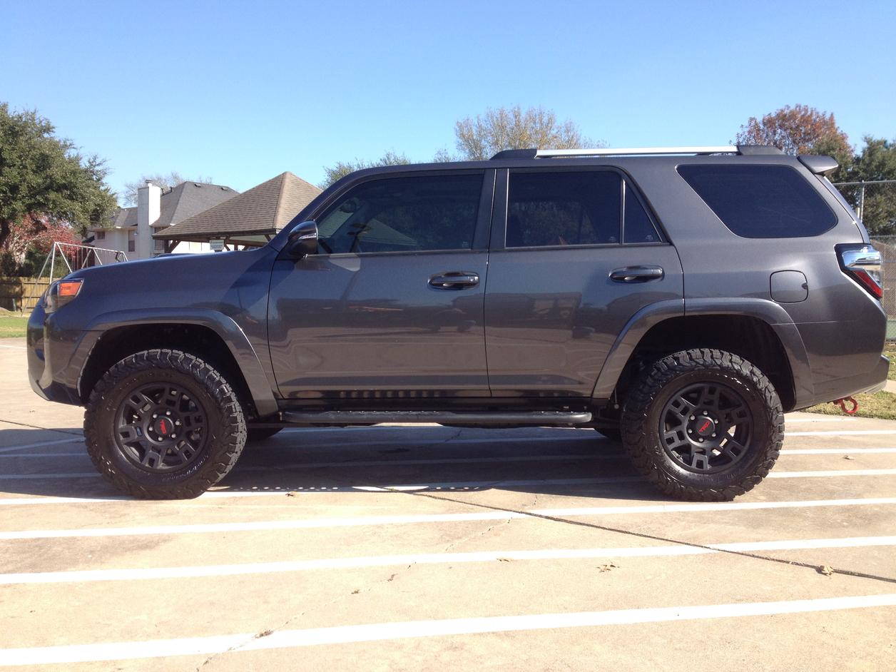

Bilstein 5100's & Cornfed spacers arrived
Trucks looking great, man! Tires Toyo AT2's - what size are you running and have any rubbing?
thanks - yes toyo at2's - 265/70/17. had some rubbing, but moved the fender liners in and relocated a couple of the fender pins, and took a dremel/sanding bit and took 1/2" or so off the below fender edge on each side - would never know and the edge sanded super quick. I had the spacers put on at the same time so not sure what or how much effect the spacers had, if any.
Had to do the same thing with my (soon to be sold to my son) 2003 4runner on the fender liners. Same size tires, but OME front shocks/coils, rear shocks and toytec rear coil spring - definitely rides stiffer than the 5100's, and I so miss that V8 though...For my driving, no regrets with the 5100's and cornfed set up and so much better than stock - enjoy that set up, especially for the price.

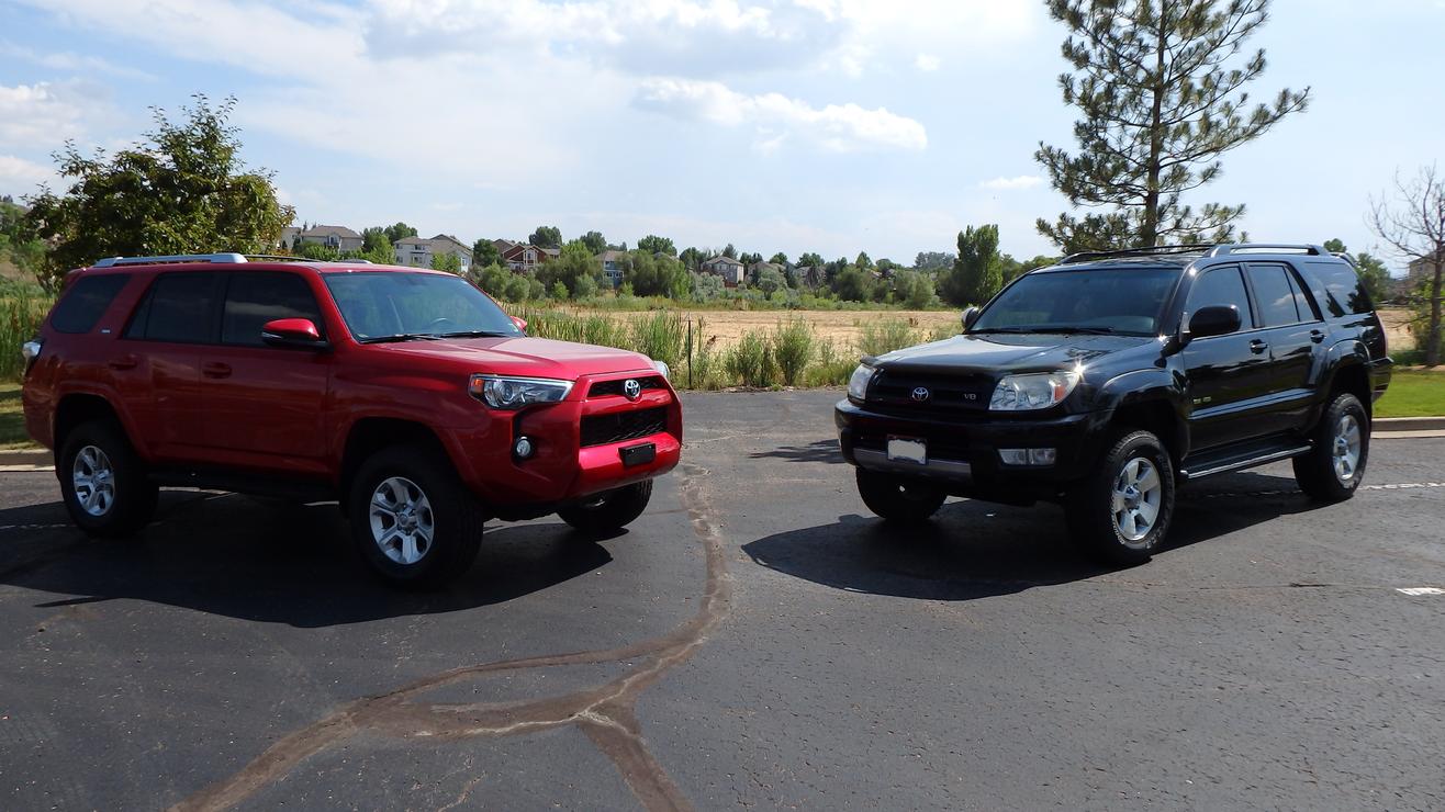

the rear in that photo (red 4runner- if that is what you are referring to) had the 1" cornfed spacers, and the top spacers contemplated were for the fronts in addition to/with the 5100's set at 1.75" (rather than setting them at 2.5").
as a side note - I did end up adding the wheelers 3/8 inch top spacer for the front, and left the front 5100's set at 1.75", and also used 1 1/4" rear cornfed spacer on the driver side and 1" rear on the passenger. I was anticipating about 3/4" additional lift in front with the top spacer (twice the 3/8" top spacer width), but got almost an inch - glad it did - lifted the front to my liking, no change in ride, etc. Still have about 1/2" of rake measured from ground to wheel well. The rear could still be another 1/2" higher for a future change- personal preference though

i am running this setup as well. i would say there is a little more than 1" of fender gap difference front to rear. i think i have more around 1.5" difference. yes it's to accommodate loading, but also personal preference. aesthetically i like the look, also "level" fender gaps usually makes the frame/rockers look negatively raked.

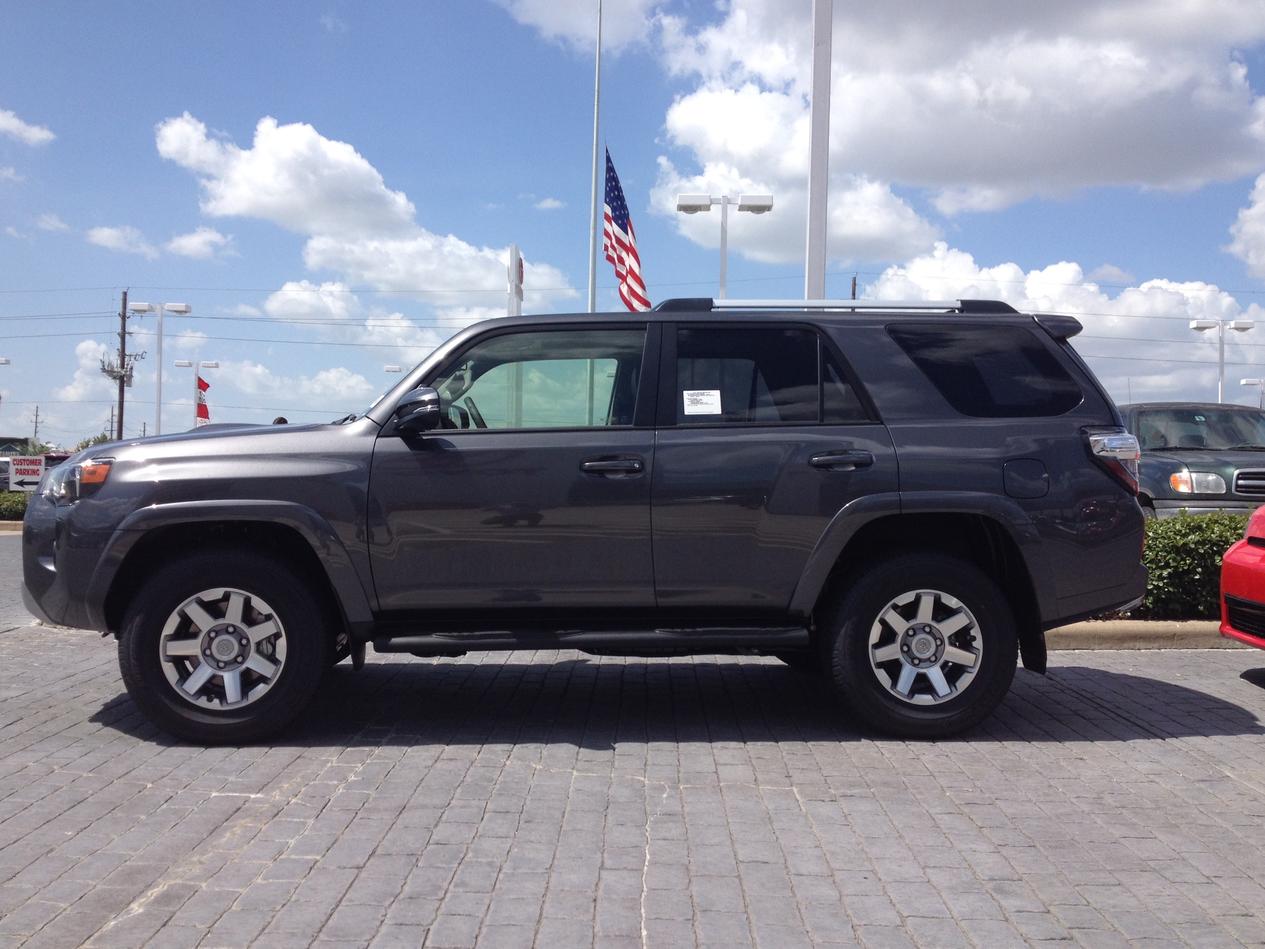

before and after from day -2 to day 180-ish?
thanks for the comparison there. Love that look too, i'll definitely go with that!
