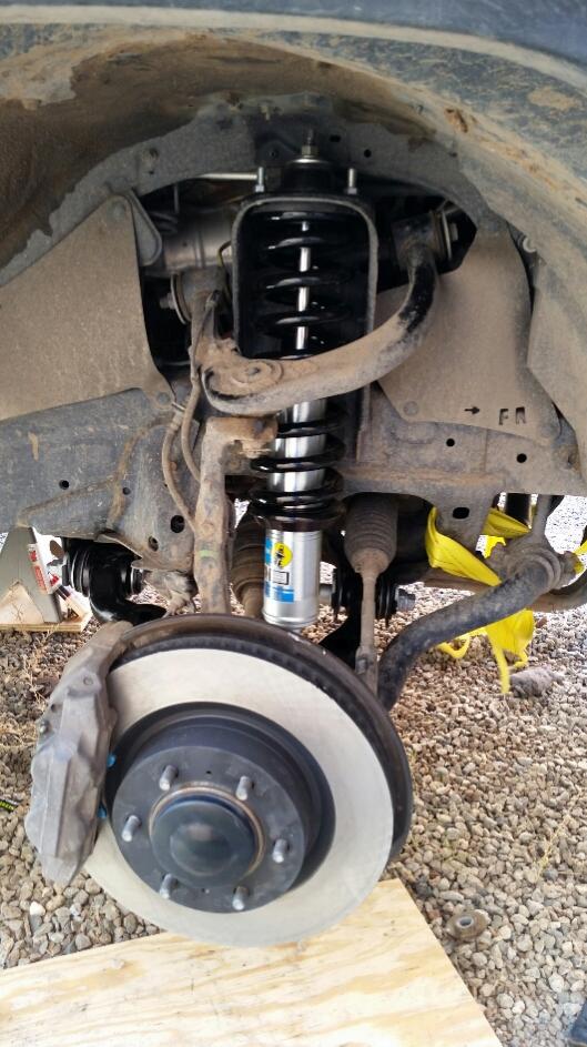

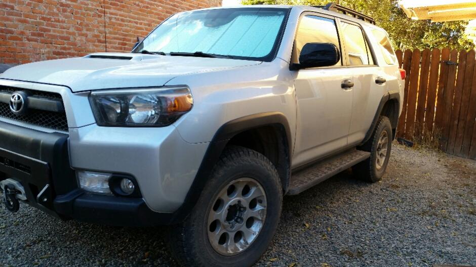

I have done it and may be the first ever, maybe not, to have installed Bilstein 6112/5160 with their new Bilstein B12 springs.
47-259768 6112 front
25-227611 5160 Rear
53-291387 Front strut Spring. This is supposed to be 14" 650b spring for an additional 80-140 pounds of front weight. It only works with the 6112 strut. Some info states it lifts an additional 0.5" but when I called Bilstein they said it does not lift an additional 0.5". I was told to use the original clip settings so get the desired lift height with the additional front weight. I wanted 2" with additional weight so that's circlip #4 for my kdss vehicle per the instructions. I have stock 6112 coils which are 600lb and 14" i think that I try to sell off later.
36-281824 Rear springs. These are supposed to lift an additional 1.5" in the rear without additional weight. They have a 1" lift spring option but no one has it and its on back order until nov or something.

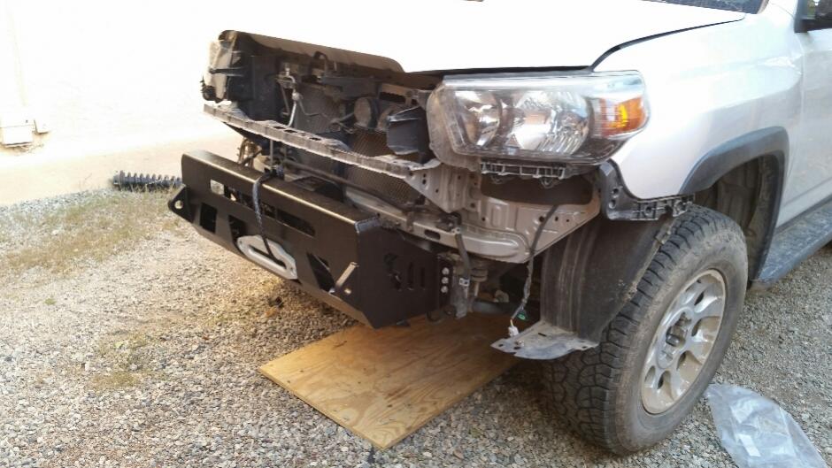

I just finished the lift and no weight on the front yet but the rear seems to have gained 2"+ eyeballing it. The front with out the winch and winch bumper is also super high about 3in. The winch and winch bumper should be about 130lb total. I haven't driven the vehicle as it still needs to be aligned but ill provide some feed back on ride quality. I have been told that the suspension needs to "settle" or "break in". Is this true? I did realize that I don't have pre-lift height measurements, I was too excited to get started I totally forgot. Ill get measurements post alignment and post winch/winch bumper plate install, then measurements again 500-1000 miles later to see the difference. I hope it does settle, it looks like I have 3" front and back now. Im keeping stock 265/70/17 tires, and stock UCA. Ill get some pics up.
winch bumper- C4 Fab lo pro, bed lined in black, all sides.
Winch- Smittybuilt X02 comp 10K, synthetic line

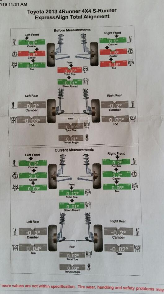

Just got back from vacation, up loaded some pictures and the alignment specs. Caster is close enough to 4 degrees on stock uco and it handles better than pre aligment. Did have to replace the lca, had to be cut out due to frozen bolts, what a bich.
I took post lift height measurement and post 200 off road mile measurement but I can't find the paper I wrote them on!!!! The height did settle down after the 200 miles and it looks very nice now. I'm much happier than immediately after lifting with no miles. It handles better than before and it rides smoother than stock. On the washroom board I didn't even have to air down like before due to harshness. Tires are at 36-38 psi on the road on p rated dynapros. I was very surprised how much smoother the ride is offroad even at street pressures. Once I find my paper with the measurements, I'll post it.

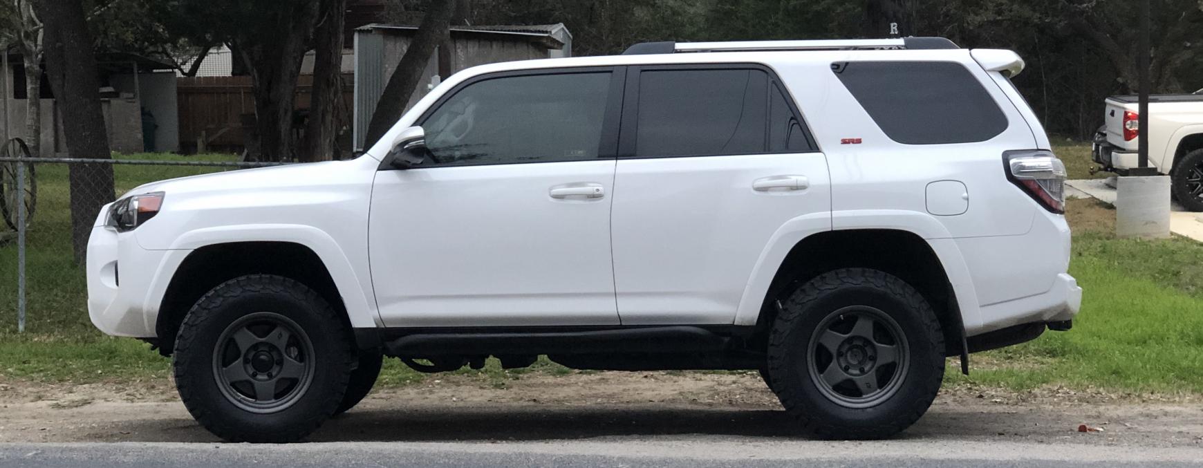

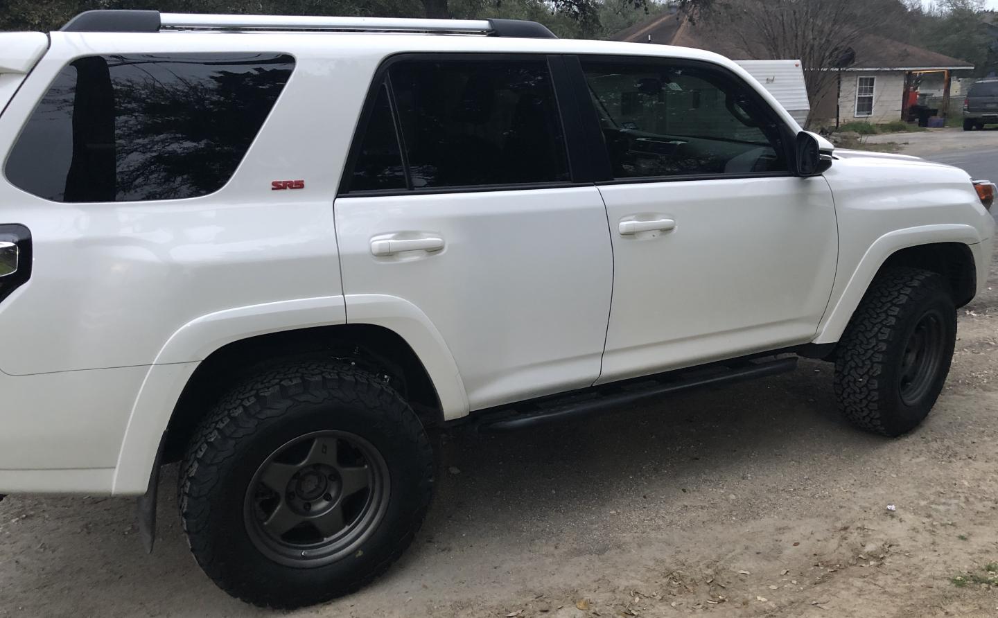

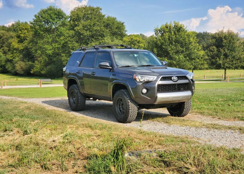

Just had 6112/5160 installed yesterday! I stuck with Bilstein springs. Love the ride. Night and day over stock.

I wanted to bump this thread to ask a question. I just bought the 6112/5160 setup. I’m going between the 1.2” and 1.6” setting for the front. If I do the 1.6” setting, will I need the B12 1” coil springs to keep the slight forward rake? I have a 2018 SR5 4wd non KDSS. If anyone has a done this setup or have another rear spring idea to get the 1.6” lift in the front do you mind sharing some pictures? Thanks in advance. I’m also planning on KO2 tires but torn between 265 vs 275.
I did the 2" setting (6/4 for non-kdss), and used the Eibach 1" in the rear. Sits pretty level with 275 ko2.
That looks awesome. a couple questions for you:
1) what setting did you use for the front? 1.6" or 2"
2) which Bilstein springs did you use - 1" or 1.5"
3) are you running 265 size tires?
thanks for sharing.
your truck looks clean. i think 2" is too high for what i need. so if i did the 5/3 setting for non-kdss, then do you think ill get significant forward rake with the 1" rear springs?
Maybe a little bit of rake with that setup, if you can live with it I say go for it. You could instead do a 1/2" spacer in the rear
All good questions!....but I don't know! I'll call the shop and ask. I told them I just wanted 2.5-ish of lift and they set it up.
Tires are 255/75, just to be different
