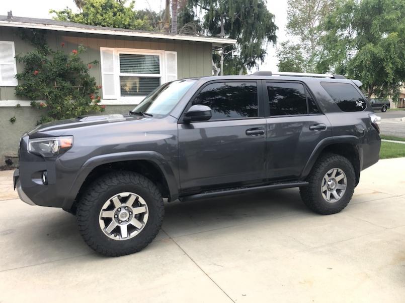

Thought I'd add to the thread... Installed 6112s(6th circlip)/5160s with B12 1.5" springs in the rear on my 2016 Trail Edition (w/KDSS). Gained ~2.5" up front and ~1.25" in the rear. I initially installed the 1" B12 rear springs (only gave ~3/4" lift), and wanted a little more so I swapped them out for the 1.5".

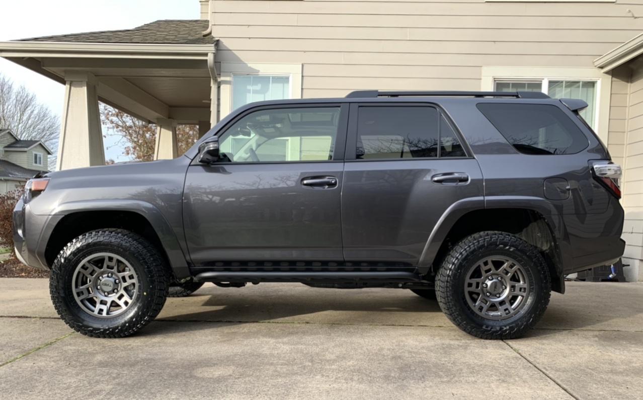

Completed install and reporting back in the event it helps someone else. There are conflicting reports of actual lift achieved with different circleclip settings. I almost went with 1.6” setting based on reports of getting more than expected. I ended up choosing 6/4 for 2” and glad I did.
** 2 days and a few miles of settling in, I’m very pleased with the result. Front lean leveled perfectly and ended up 2” up front and 1.125” in the rear. Below are specs and parts used:
Front- Bilstein 6112 set at circle clip 6/4 for 2” on non-KDSS
Rear- Bilstein 5100 and Bilstein 1” coils
Measurements, taken from base of rim to wheel well, full tank.
Before:
DF- 28.625”
PF- 29”
DR- 30.875”
PR- 31”
After:
DF- 31” (+ 2.375”)
PF- 31” (+2”)
DR- 32.125” (+1.25”)
PR- 32.125” (+1.125”)

So you ended up getting 1.25'' lift in the rear with the 1'' coils? Interesting.
Correct, 1.25” with B12’s in the rear. I will report back after a few weeks should things settle further after more time and miles.

Looks great, thanks for sharing! So your total lift in front was 2.0-2.5'' and rear was ~1.25''? Looks like there is still about 1'' of rake. Did it align alright without UCA?
Glad to help. Yes, Bilstein 2” setting of 6/4 compensated for drivers side lean perfectly. Lifted 2” on passenger side and brought drivers side up 2.375” to level.
Stock UCA’s- My alignment tech got caster to 2.9 on both sides. All is within spec and drives great.

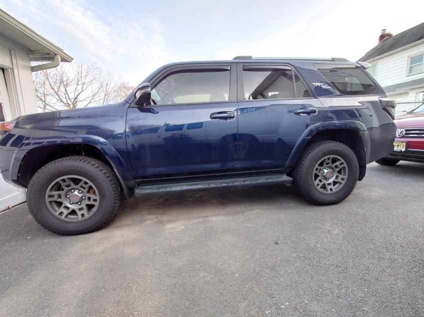

6112 with 5150 rear and original rear springs
Looking for input from the thread... recently upgraded my suspension from factory stock to: Bilstein 6112's at 1.2" (4/2) setting in front and Bilstein 5160 in the rear but left the factory stock springs untouched. Both front and back level at 21.5" center of wheel to fender, but it seems that the truck tends to have a reverse rake at times, especially when 100 to 200lbs are added, or the truck sits on an incline. I'm considering upgrading the rear springs to Bilstein B12's to get an extra 3/4" to 1" in the rear, for just a slight forward rake and I figure the B12's are better able to support the occasional 100-200lbs vs factory springs, when adding weight without having a reverse rake.
Anyone have any similar experience and how did you correct any reverse rake?

Sounds like you potentially got more than 1.2”. Recommend that you measure ground to frame behind front tires and in front of rears. I also suggest bottom of wheel to fender (as finding center of hub can be difficult to get an accurate reading).
Those measurements will help you find true rake under different loads. From there, you can consider rear spring and/or different setting up front.
