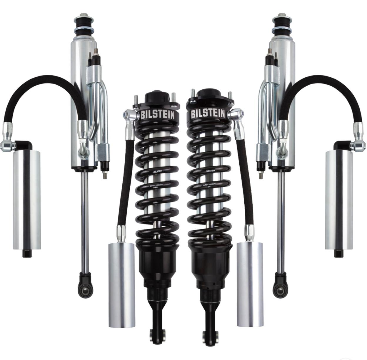

The Tacoma crowd seem to like these badboys, I can see that they aren't available for the 4runners yet but FJ's etc. They do look pretty badass though
Thoughts?
I can see the perk of not having to rebuild every 30k

Been keeping an eye on these. Pretty sweet. Time will tell how well they hold up to the real world abuse. It’s about time Bilstein step up their game to get some competition going in the high end segment.
I know noting about these, but based on the rod ends and what I presume are spherical bearings, at least some parts will require regular maintenance. If not
I’d be super curious how.

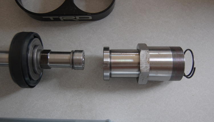

The front shock is internally very similar to the Tundra TRD Pro Bilstein. Here is a picture of the Zone Controller from a TRD shock that I dissected a couple years back. It only lacks the rebound top-out of the 8112.

These will be similar in performance as to the 2.5” dampers from Kings, Fox and Icon. However, you’ll benefit by having double bypasses on these 8112 rear shocks. The ability to adjust both the rebound and compression. You can get this bypass option from the other manufacturers as an upgrade or custom shock.

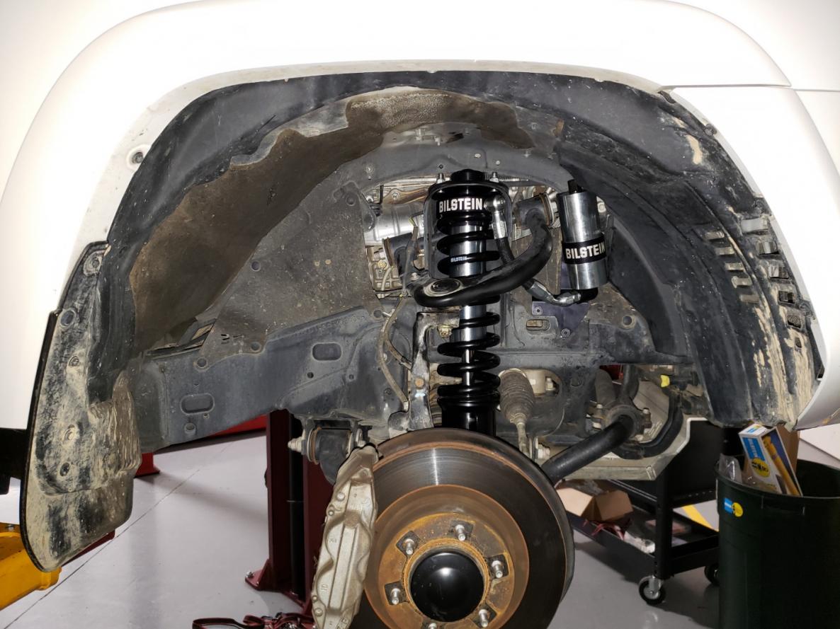

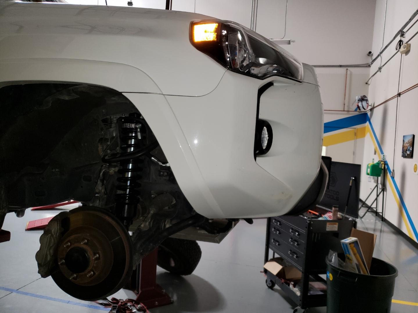

I don’t have an ETA, but they are coming...
*edit* I’ve attached the pictures in case they got blocked on your browser.
