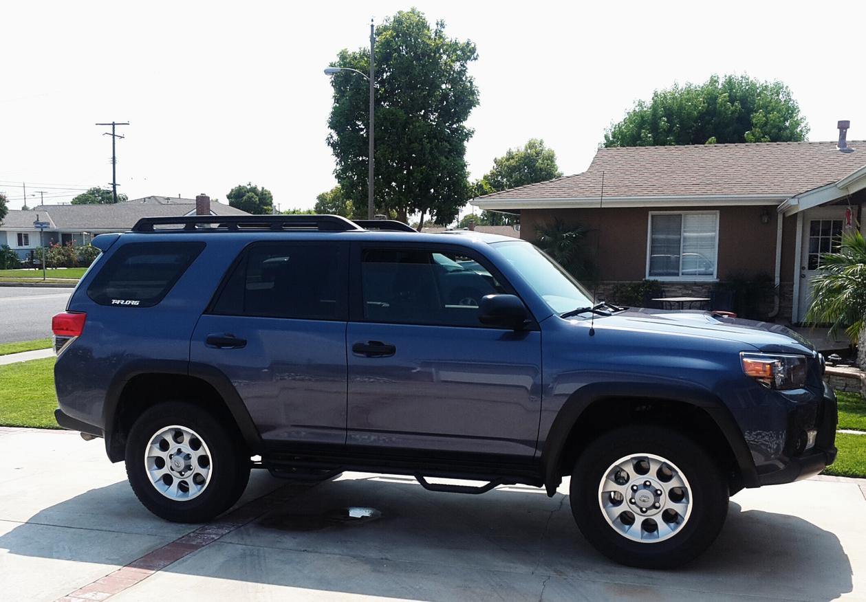

I went with 0.85 and like the look - it's 1 inch higher in the rear. No spacers.
5100s on all four makes it firmer on-road and helps the off- road a lot for a feeling of better control.
