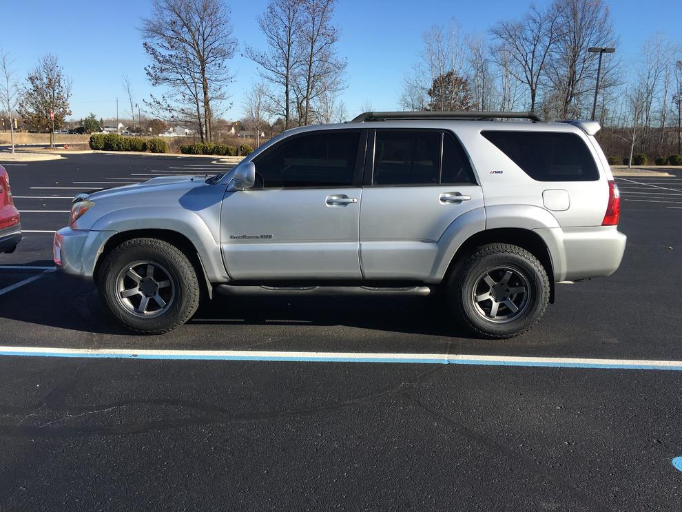

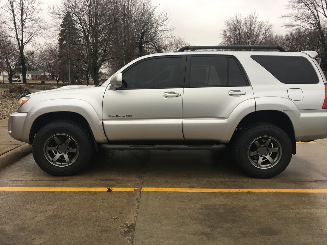

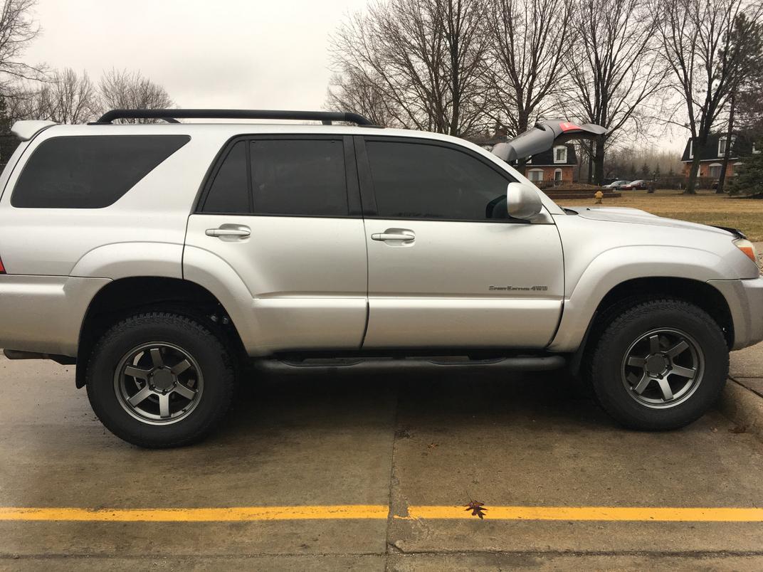

Pics
Both front shocks on 2nd perch and c59-599 rear (for sale). no spacers added
