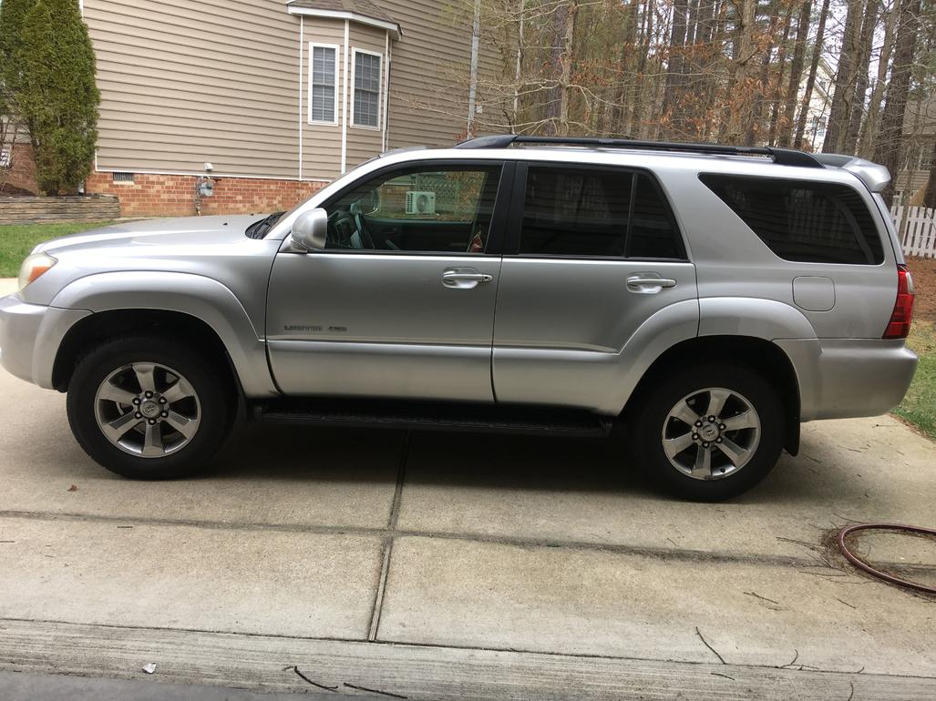

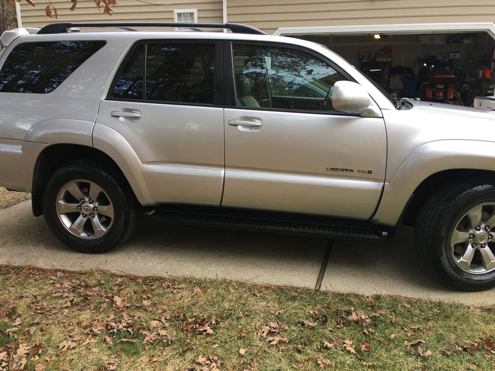

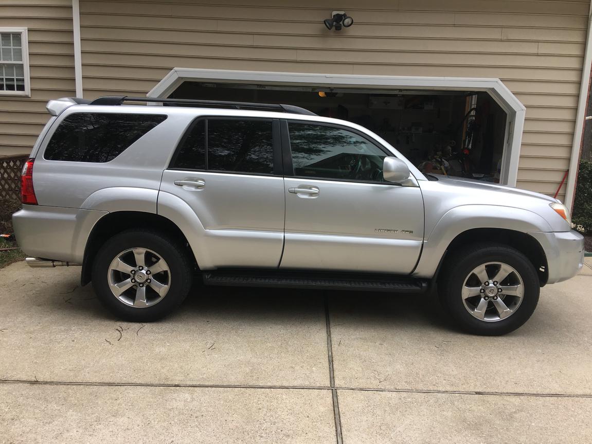

Kit Installed. I forgot to take some before measurements as well of before. However, I do have a single Before pic to share. I went with the 1/4'' toytec spacer on the front. There is still a slight rake with the measurements being:
FL and FR: 21''
BL and BR: 21.25"
Overall, yes it is a better ride with less body roll. Original setup had 163k on them. I'm not the original owner. I purchased her in December and it was previously a 1 Owner Runner.
Next debate; do i downsize from the 18" rims to 17's once its time to purchase some new shoes.

Looks great! Happy to hear it rides better.
Looks like the rear is unchanged. Did you keep the stock coils?
I was thinking the rear was gonna lift another inch, but you are right it was unchanged because I didn't change out the rear springs. I might do it down the road.

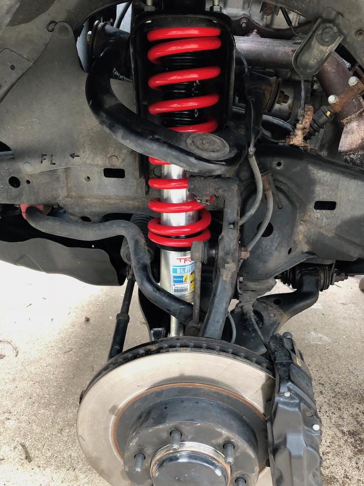

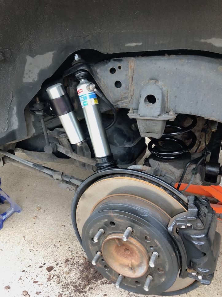

Since you seem to be one of the first to actually get the kit installed on a 4th gen can you confirm some of the previous concerns mentioned:
• Did you have to widen out the holes for the rear upper shock mount? Was a step bit the best method?
• How did you go about making the front shock width fit? Grinder, lathe? How much material had to be shaved?
• What was the mounting procedure for the rear reservoir, did it bolt directly to the frame hole or was a threaded insert of some sort needed?

I actually did not do the work myself. I recently had rotator cuff surgery and was eager to get it done. But yes the front struts were trimmed with a grinder and the rear mounting holes were reamed out using a 3/4'' drip bit. I'm not sure if there are existing holes in the frame to secure the clamp, since I did not do the work myself.
I hope this helps.

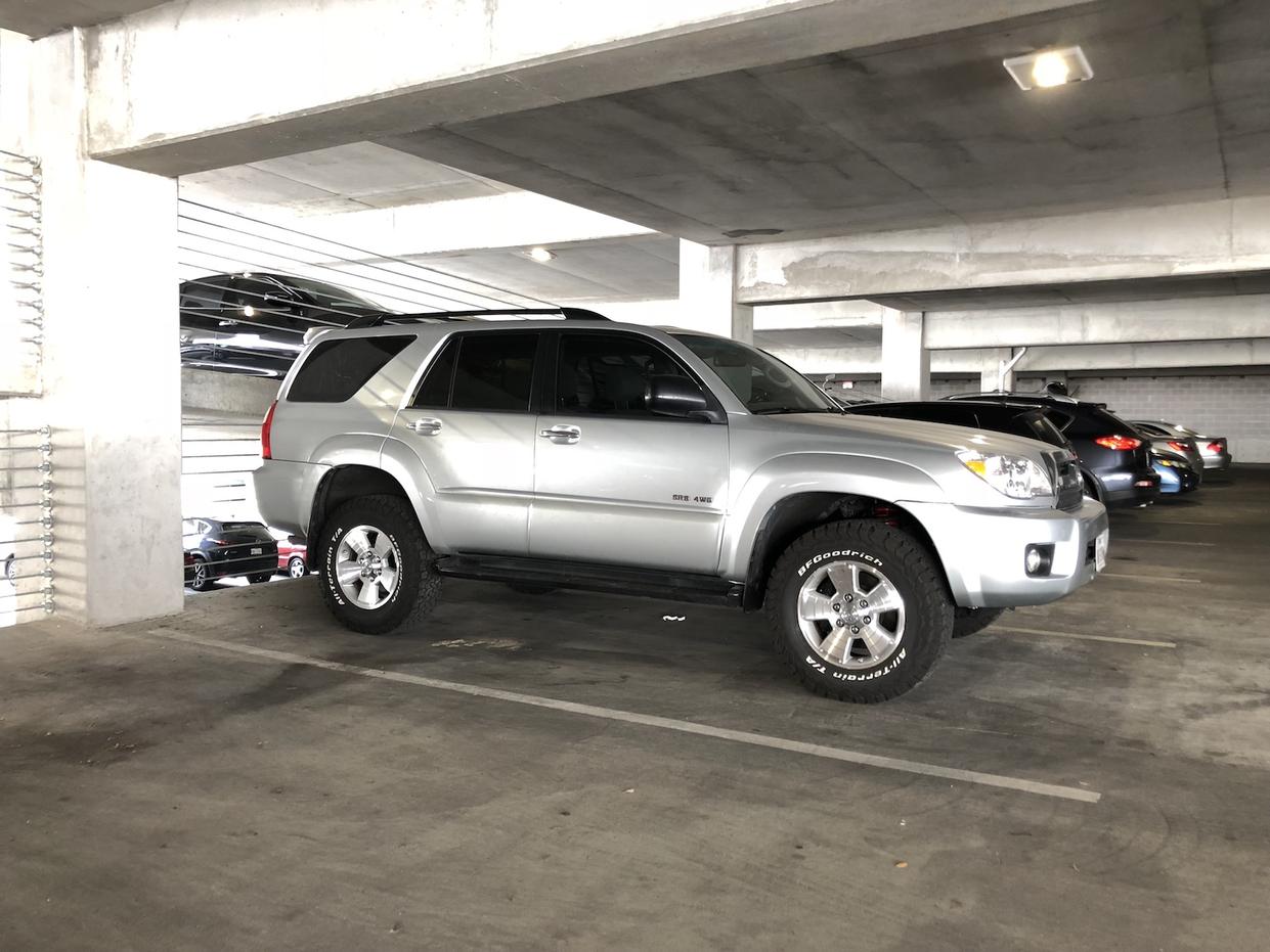

I got mine today. I used a vin I found online. So ready to put these on!
Installed my kit today. Nose dive and body roll are both significantly reduced. Large high-speed highway bumps no longer cause excessive undulations.
The ride: 07 SR5 4WD V6
The setup: PTR13-35140 and Moog fj rear springs. 265/70/17 K02s
I'm lazy and tired from wrenching so measurements will have to wait until tomorrow.
If you have the means and the availability to source it, I highly recommend this setup.
