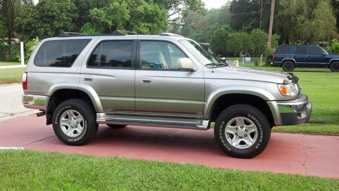

here is a photo of mine. my sig states what combo i have. rides great. i will eventually get TRD coils for the front.

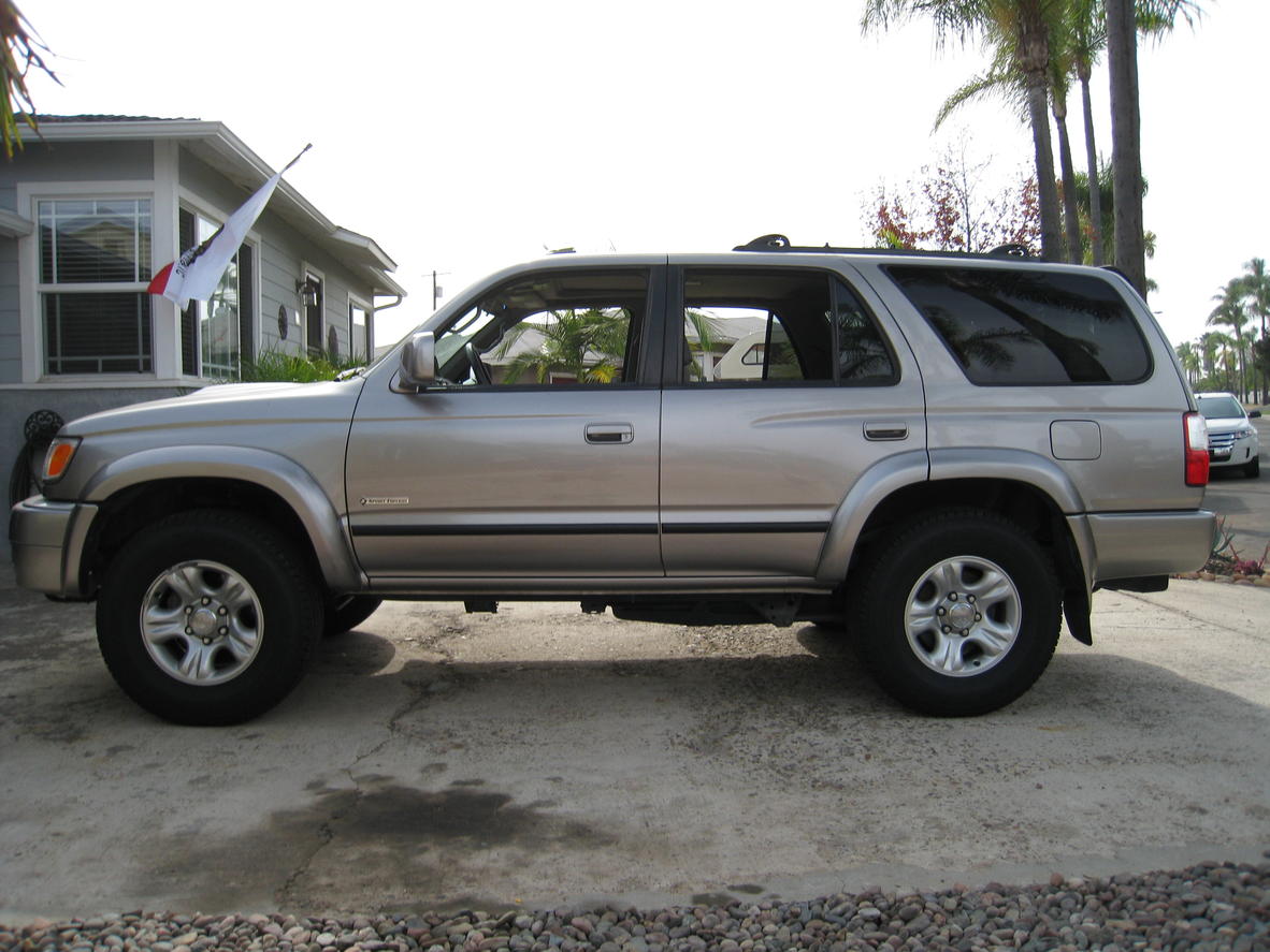

Heres a pic of my 02 sport. Stock springs front and rear with Billlie Tundra 5100's set on the third perch.
