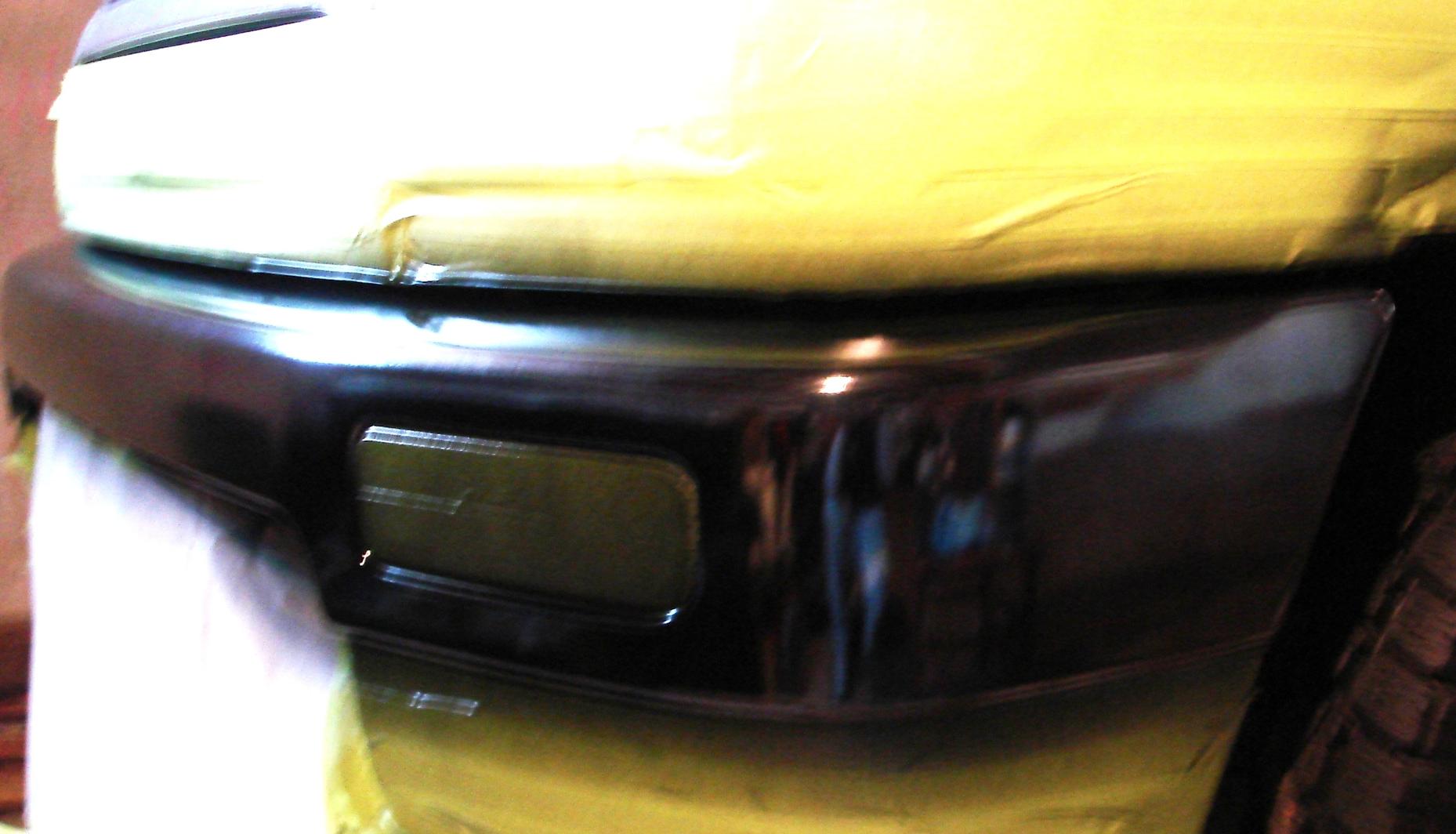

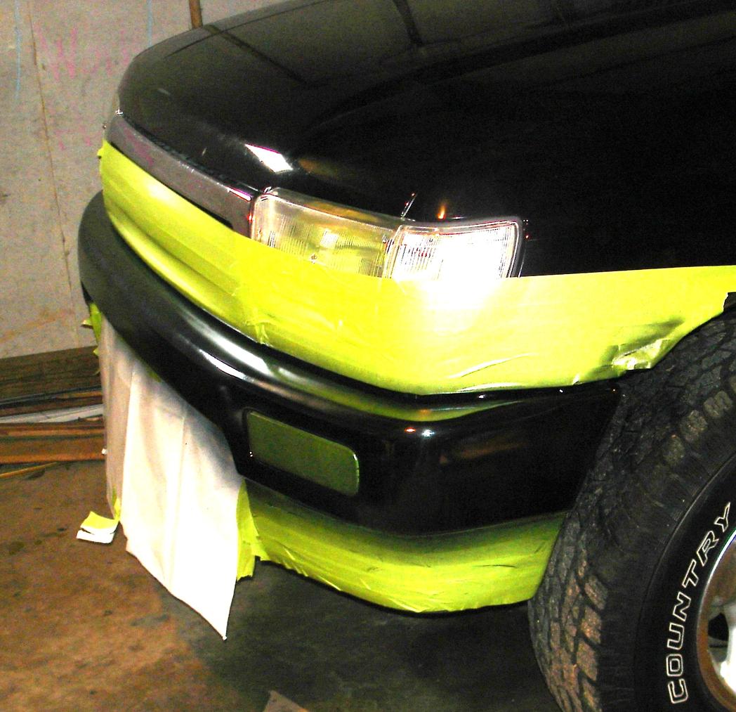

Black Chroming my bumpers today.
Dupli-Color posted my 4Runner on their website.
Dupli-Color :: Success Story - Black Chromed bumpers
i mean it, that's kind of cool !

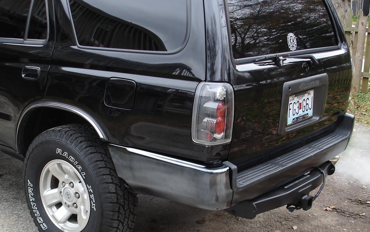

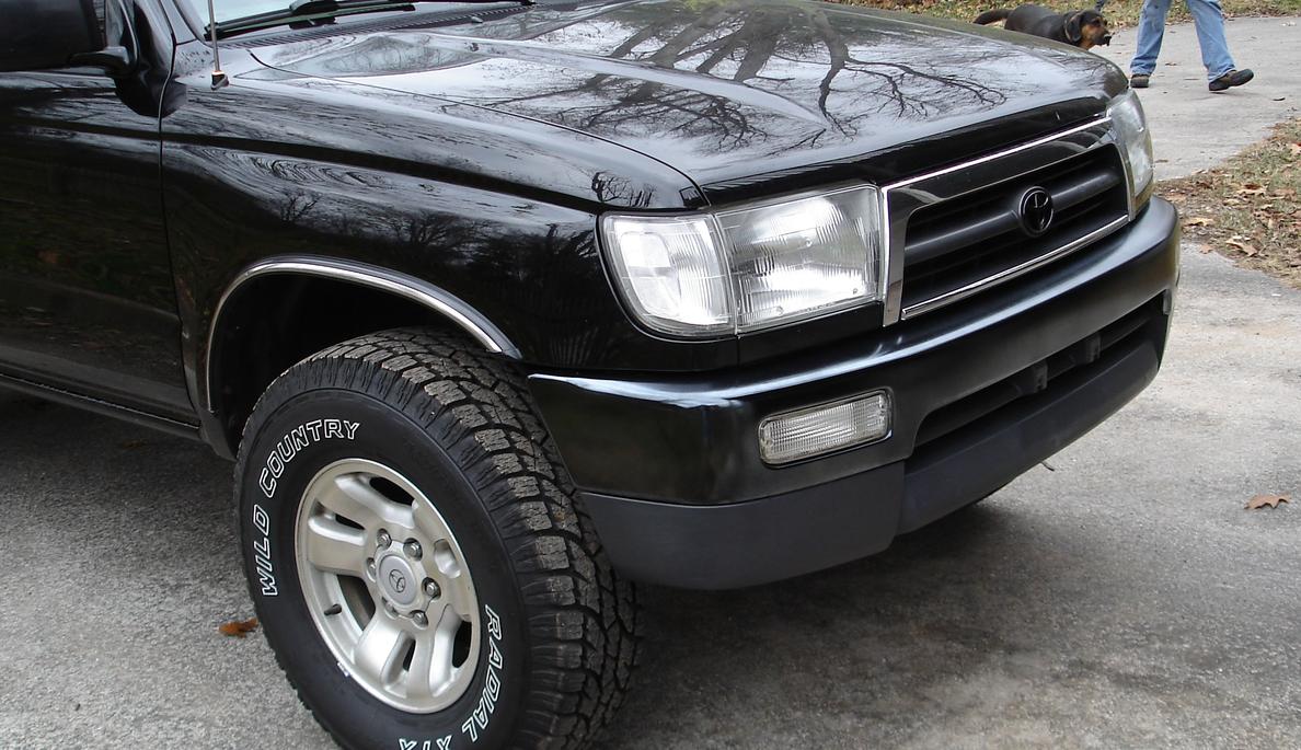

Got the fender flares done.
No more chrome!!!!!!!!!
Nothing left to paint. :guitar2:

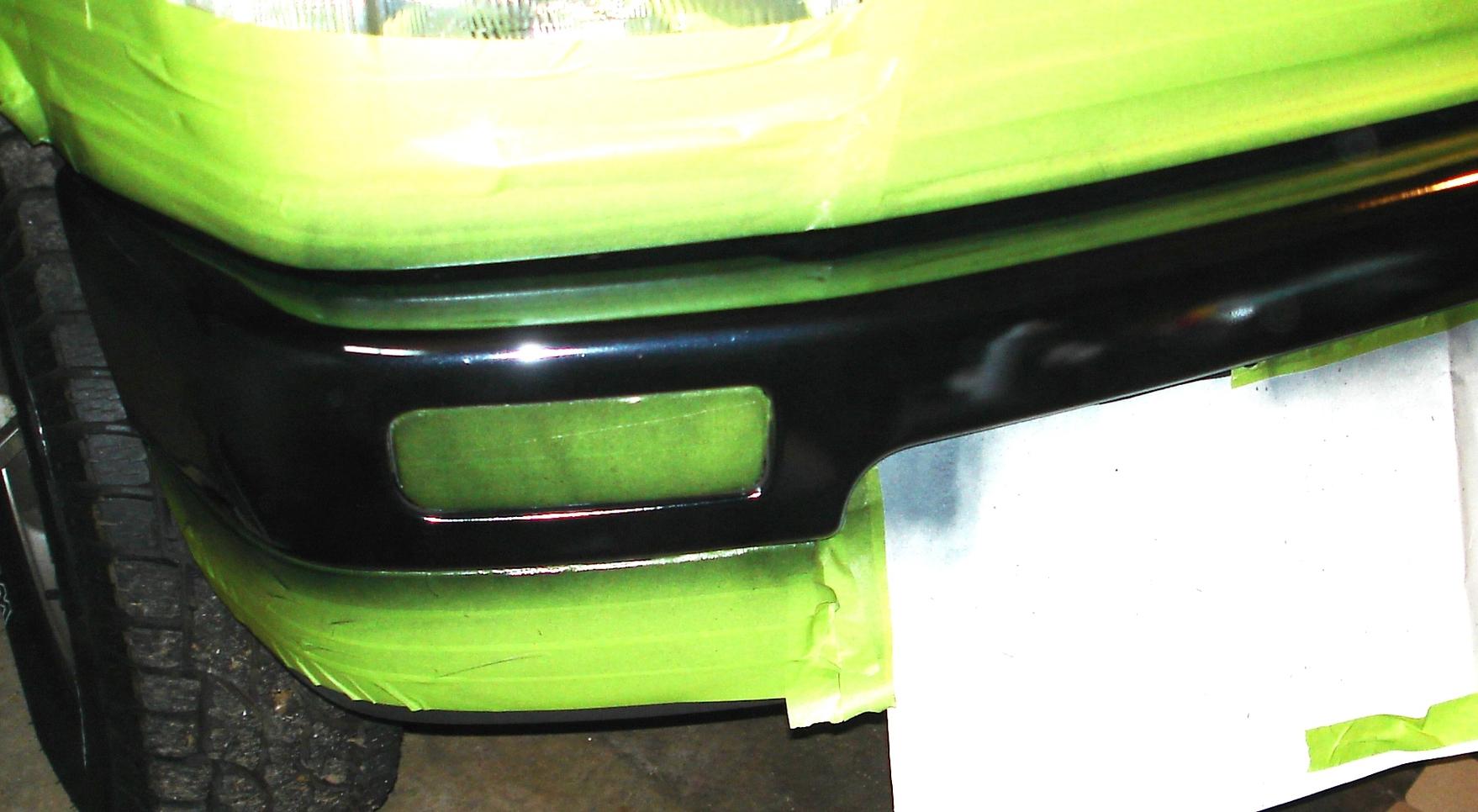

:redbrick::redbrick:OK guys it's been awhile and have some bad news. About 3 weeks after I completed the de-chroming of my Runner I was heading down the highway and got stuck behind a salt truck who decided not to tarp his load. Needless to say I got hit with salt for few minutes pretty good. The paint on the front bumpers and grille now have chips bringing the chrome through. It's not too bad but I'm still pissed. It can be fixed though I just have to redo the front. It looks like glitter on the front of my truck. It looks like a stripper rubbed her ass on the front of my rig
:redbrick:
That is why I don't recommend painting over anything chromed.....Not much out there can stop that from happening.....the surface of a quality Chrome piece will outlast any paint.....any day.
That being said, I like the look of a monochromatic paint scheme on the 4Runner, but in order to do it right, you'd have to replace the chrome pieces with just bare steel pieces, prime, base coat, and then tons of clear.
Hope it wasn't too much work to re-do........
I have painted my bumper twice now (thread up) and if I didn't have the Limited Flares which are a PIA to remove safely, I would take my bumper to get powder coated next time.
You have one of the sickest Runners i've seen. I'm gonna start heading in your direction as far as the front bumper and flares, roof rack, etc. Will the "limited" flares fit my SR5 without wanting to kill myself with frustration?
Here are the pics
Not real bad but bad enough

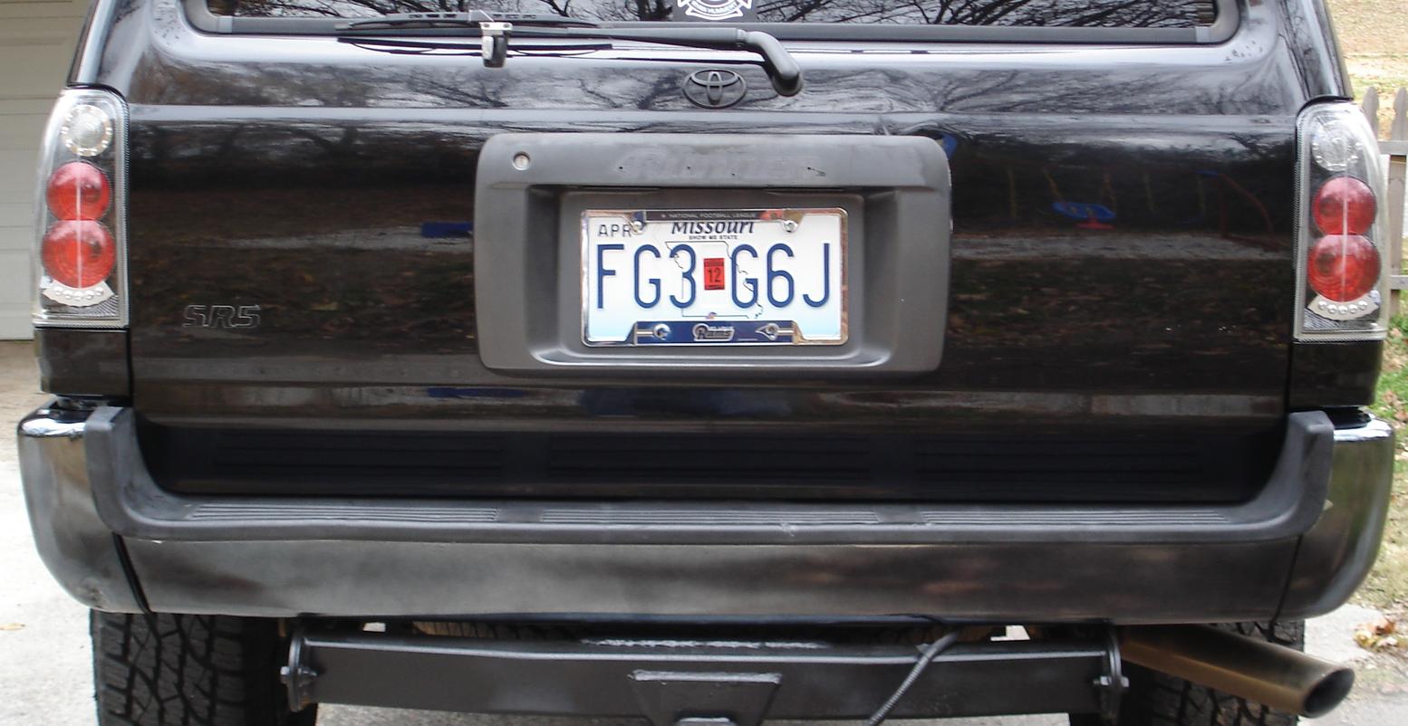

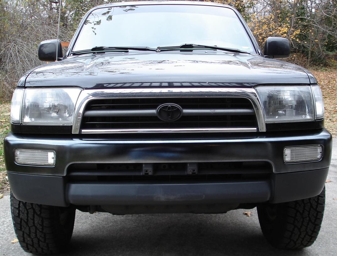

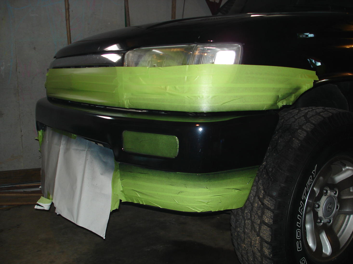

After shots I never posted
Can't see the bumper imperfections from a distance. If it's cloudy out.
