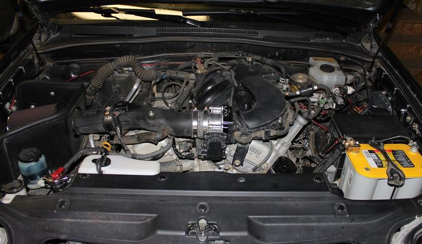

2014 T4R 10k miles, 70mm throttle body and a URD 70mm adapter.
car-part.com

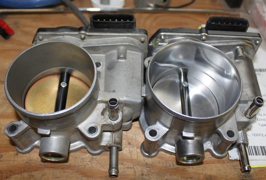

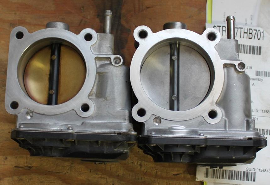

2004 TB is 65mm (63mm at smallest)...was way dirty, like oil blow back from the intake manifold.
The K&N is 68mm tube, the 70mm TB is actually 68mm at its smallest diameter and the URD 70mm spacer is 68mm.

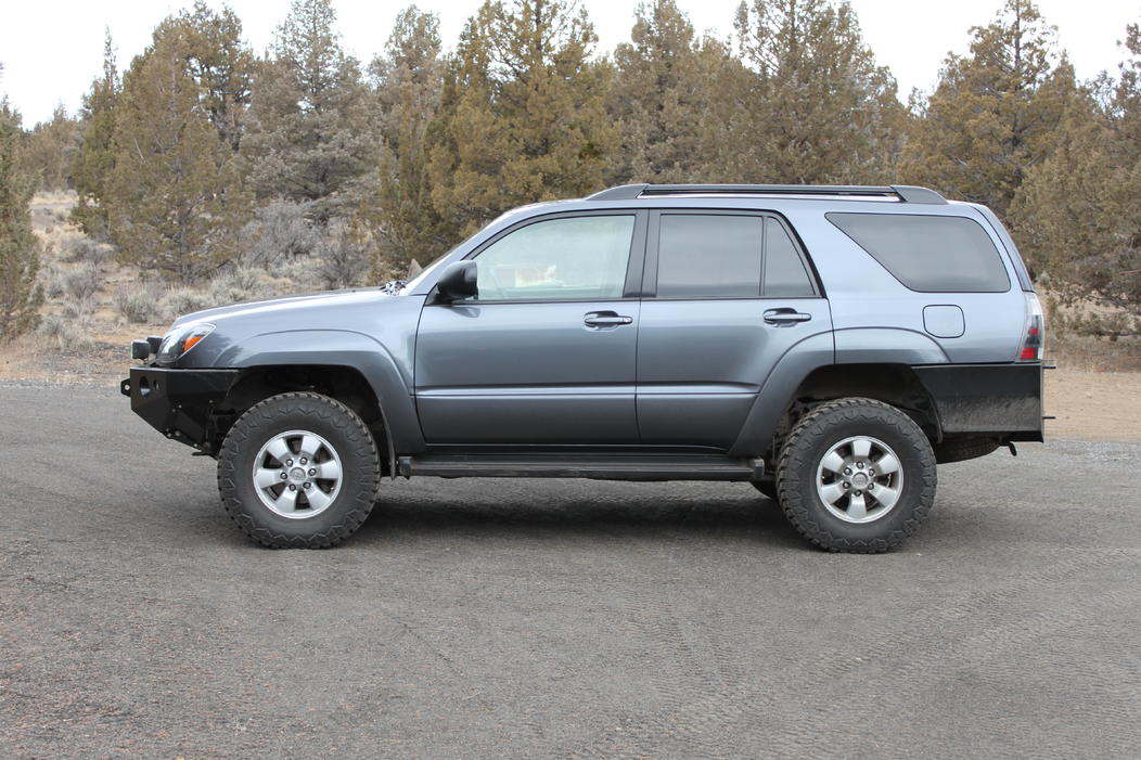

265/75/16
Great tires.
I had to do a little trimming on the front after the 285's.
Ooo. Yeah i had duratrac on my crv and they were reaaly great tires. Just sucks they dont come 255/80 size i might end up switching my 285 for something thinner to save on gas money. Currently am getting 14 mpg and am not armored up like you only have sliders. You did almost all the power mods i though about doing. You think your going to do the intake manifold spacer?

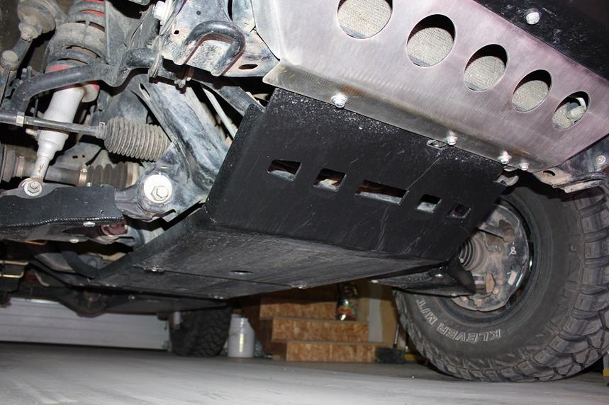

Got the RCI skids installed and was noticing how the sliders are already sandblasted to bare metal in a few spots due to the cinders on the road, may need to bedliner them or powdercoat at some point. Or put mud flaps on the front. Starting to regret that I didn't get the skids powdercoated. May turn into a yearly maintenance thing...hit it with some rattle can bed liner, WAY better!

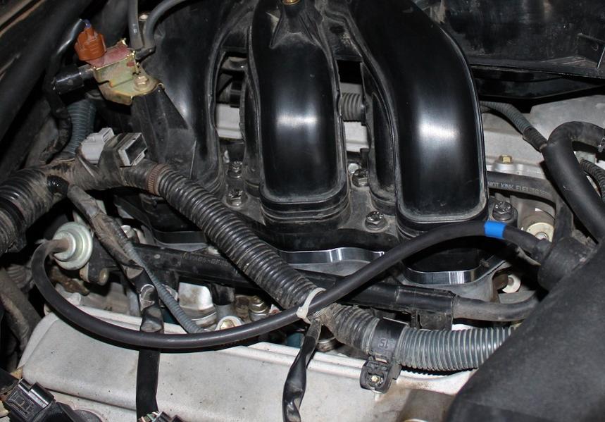

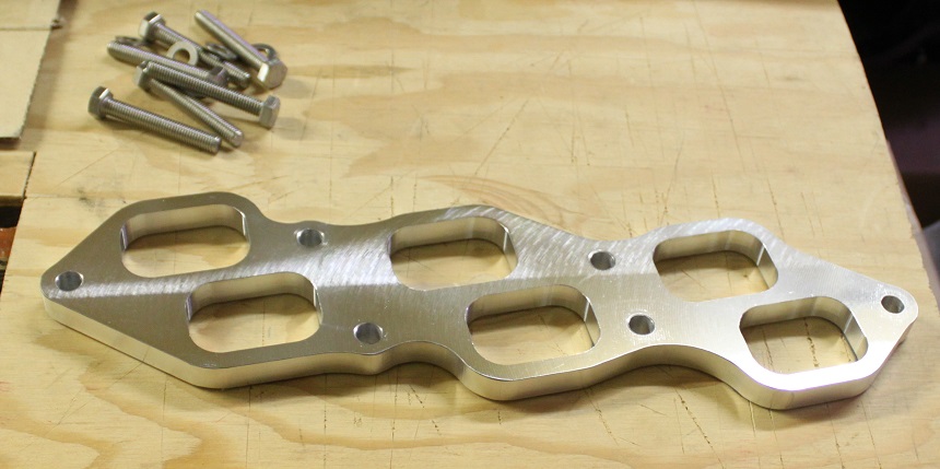

XTP intake manifold spacer installed, so far so good.

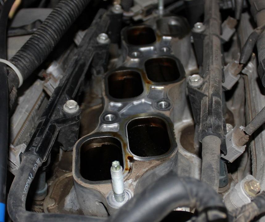

The intake manifold was not nearly as oil/dirty as I thought it would be considering how dirty the throttle body was.
The intake ports on the motor were all fairly dirty except the #6.

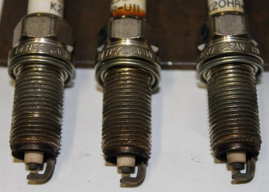

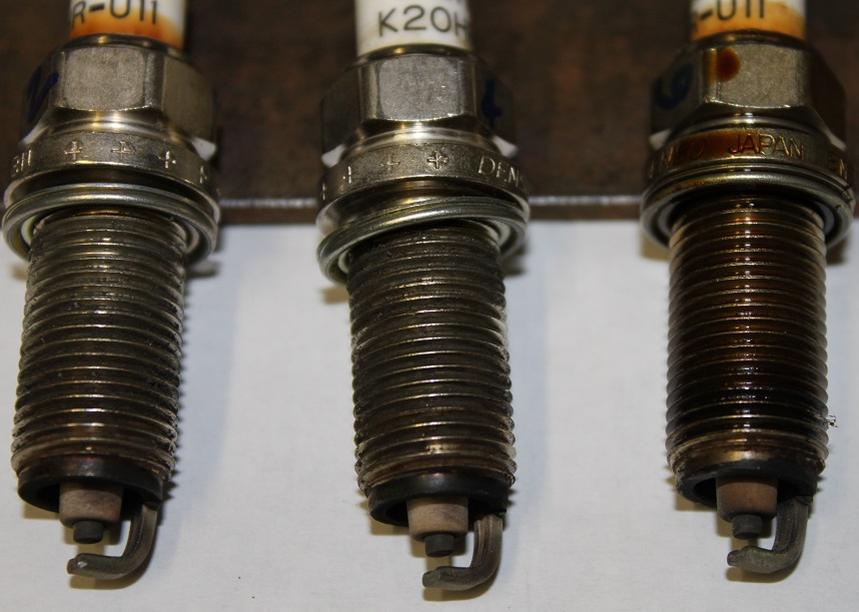

Changed the spark plugs and the #6 was a little darker and had oil on it. The others had no oil on them.
Blasted the PCV valve out with brake cleaner, it was dirty/oil.
Did the front and transfer case oil, the center looked like new, the front was dark and the magnetic drain plug was covered with metal.
Going to run it about 1k and change gear oil again just for the hell of it.

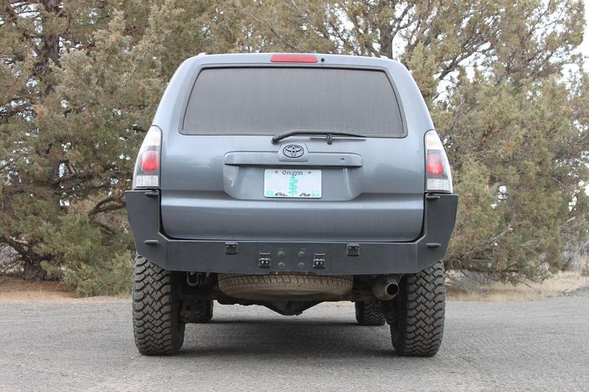

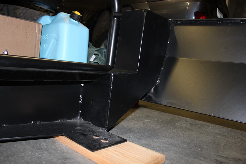

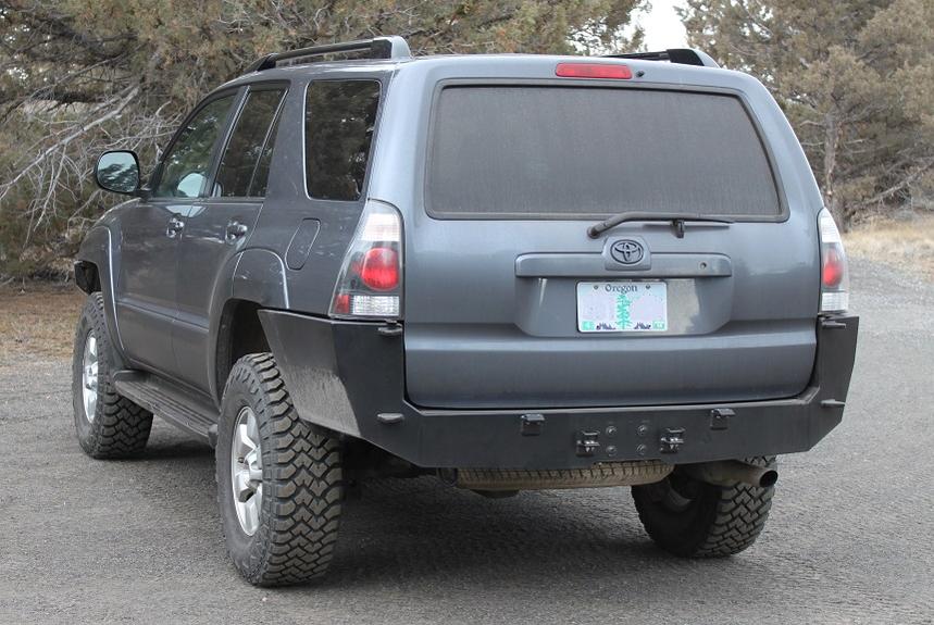

Going through this thread and jealous of your rear bumper, as I like how simplistic and functional it is. How have you liked it to date?
Also I really want your stereo/scanner setup, but my wiring skills are not quite up to snuff.
As always great rig and keep us updated!
loving the tires and rear bumper! hoping to throw the same size 285/75/16 on my 4runner once I fix my driver size needle bearing issue and save up some more funds!
Thanks, your Runner is looking good too, FJ 'phone dial' wheels are some of my favorite.

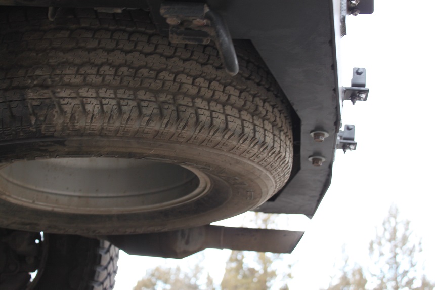

Rear bumper works good, only about 60lbs without the swing arms.
It would look better on a '06 or later because of the way the side wings stick out past the fender flare a bit. Be cool if the hitch mount was incorporated into the bumper so it would not hang down, but that would require cutting the rear x-member...would be better, more clearance.
Only gripe is no recovery points and the square-ness from the side, be nice to have another angle from the lower back towards the tire...that make sense?
Kind of a 45ish degree.

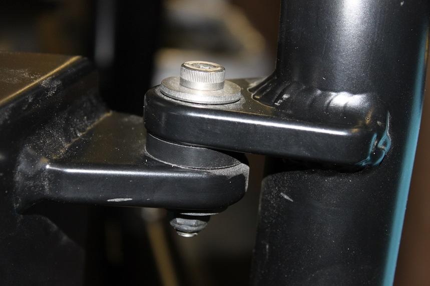

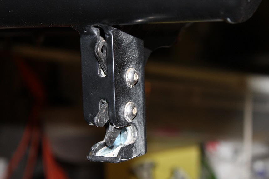

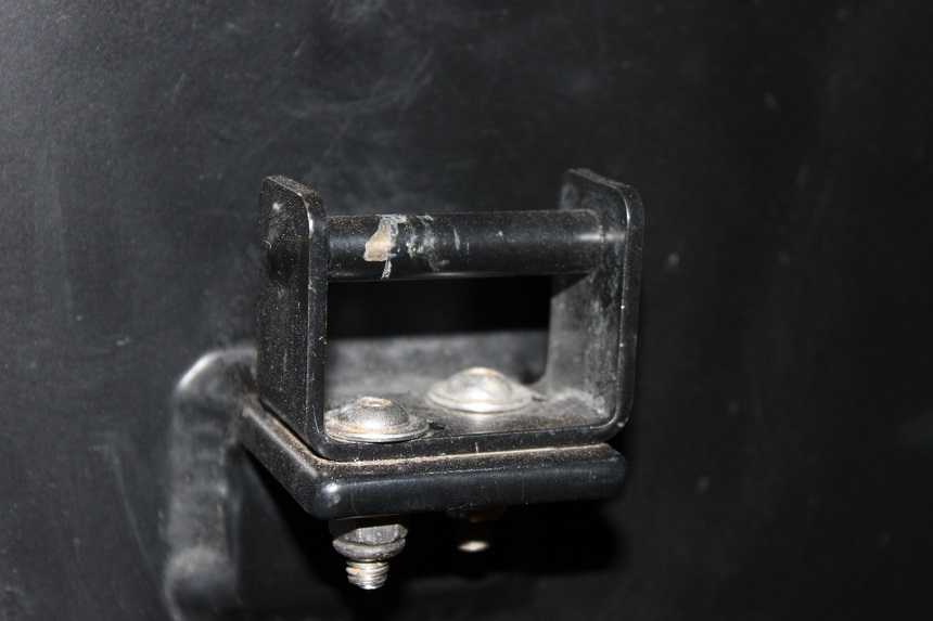

It has plastic bushings on the swingout, gets squeaky with dust (when you open it), but I just clean and dry film lube and its good for another 4 months or so. Makes it harder to see out the back, but now I have some form of extra metal behind me in case any one takes a shot at me.
The Aluminum hinge point at the bumper is starting to enlarge, where the bolt is, may have to figure out some sort of bushing.
Some of you guys, if your serious about a rear bumper, maybe send Aluminess a bunch of E-Mail. Was lack of interest that killed production.
As for the radio/scanner it is pretty straight forward, start at the center console and start pulling, only a couple screws holding it all together. Some trimming, really not to bad.
I think with that PhotoBucket SNAFU I may have deleted a number of the Aluminess pics.
Dropped some here.

I am having issues with the tires, I love the look and the clearance and the traction, was great in the deep snow this last winter they really hookup.
I need more room, I am going to end up ripping the front fenders off with the tires in the whoops at speed.
Slow its OK but fast I slam the fenders. I need firmer coils and more room(bodylift). I need to do the body mount chop and cut some more of the fender/mudflap area. The Rancho Quick-Lift is advertised as 2.5"/1.5" and 285 but I think that's pushing it, 275 would have worked better, less issues. But hey I allways thought these 4th gen look the best with 285's.
A little less offset would be nice these are -16 on a 7" rim. Wish they were closer to a -10.( would help some with the rub, I think).
So I need an extra 1/2" BL or coils.

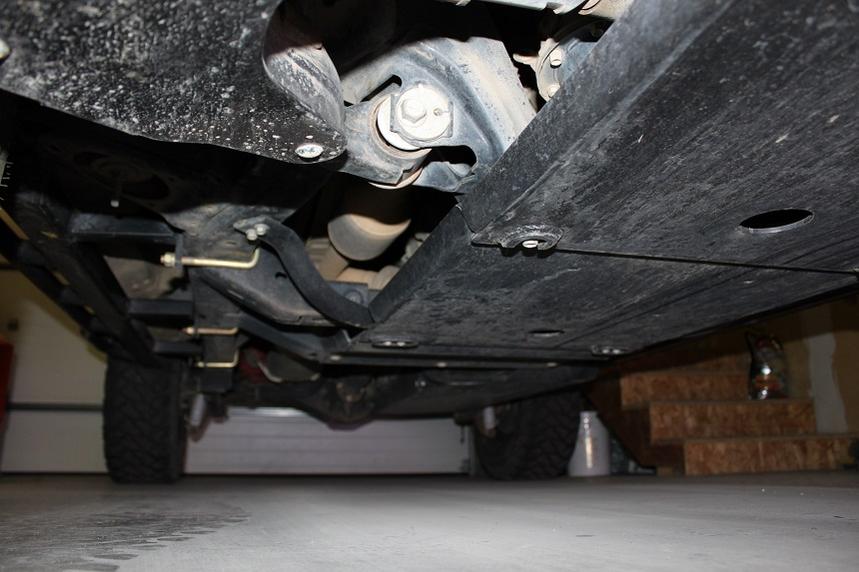

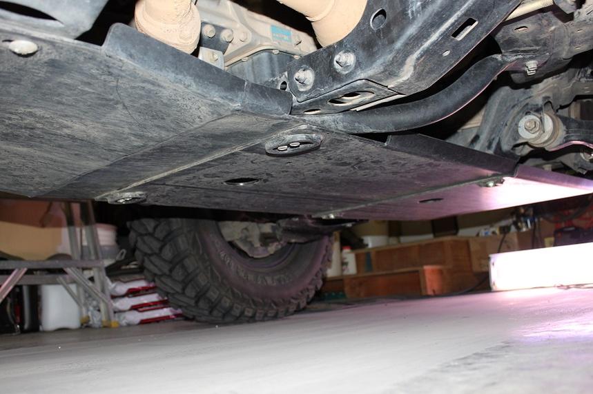

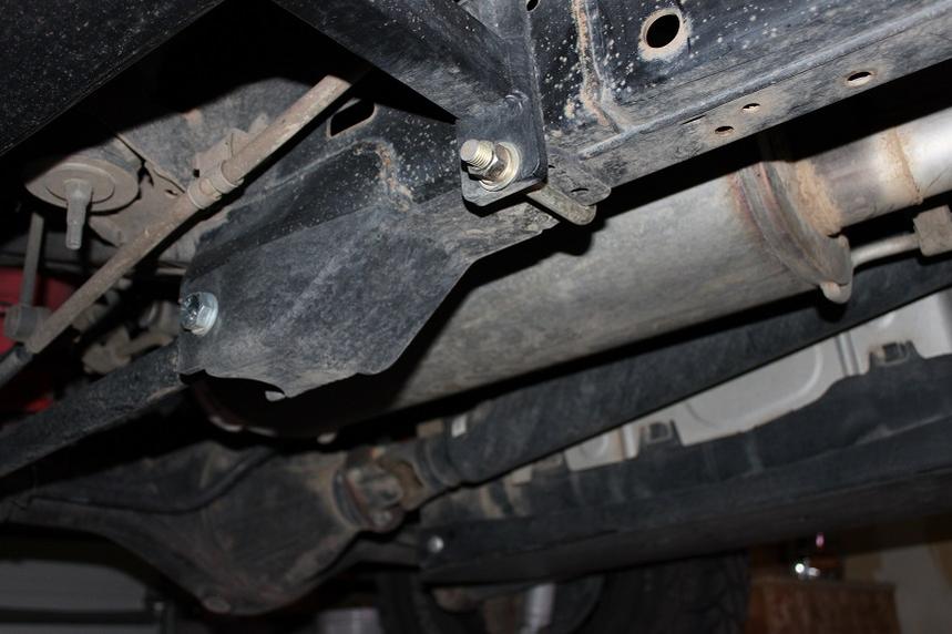

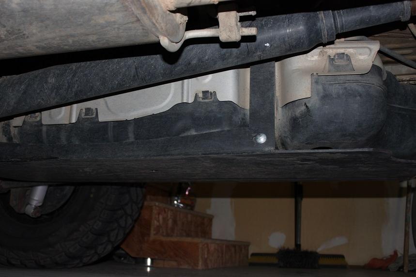

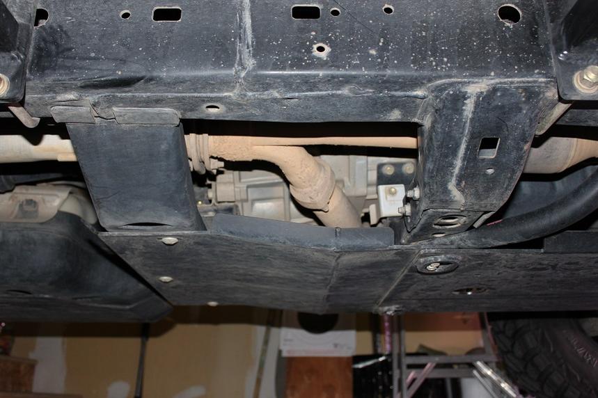

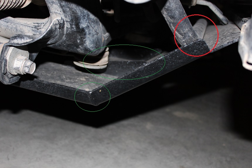

Thought I would add a couple RCI skid pics, installed at the end of Feb. Seems to be all the rage. These are steel painted with rattle can.
Set them on a floor jack to maneuver and lift into place.
Cut the RCI logo out, I am not into advertising.
The sway bar is probably 1/4 to 1/16" clearance.
Looking at another T4R members RCI front skid, has 4 round holes and the RCI logo is at an angle, looks like they braced the front skid with 2 triangles and welded the edge/angle (front to bottom). That was a V8 to so don't know is they are different.
The rear upper link skids wedged in under the U-bolt for the White Knuckle sliders, perfect, keeps the sliders from moving up.
Added some Icon LCA skids and removed logos too.
