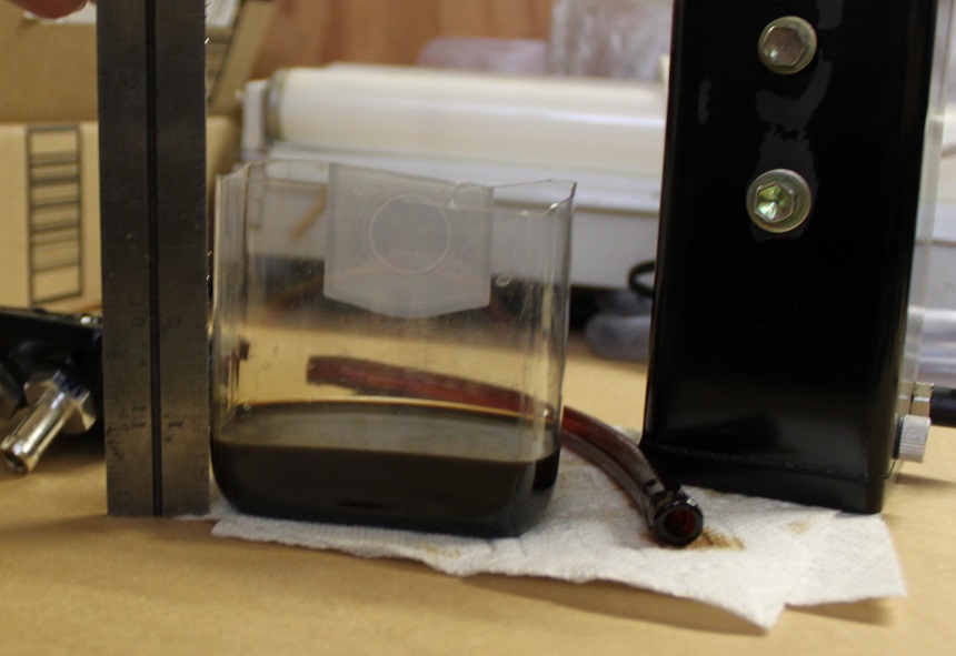

10 months after the oil catch can install...it looks like it works.
Yes that came out of the oil catch can.
This is one of those...I wish I had done earlier mods.
I guess Toyota thinks its a good thing to have motor oil spraying into your air intake?
This is indicative to the motor design not just a Toyota deal...

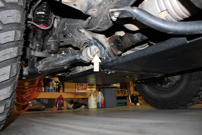

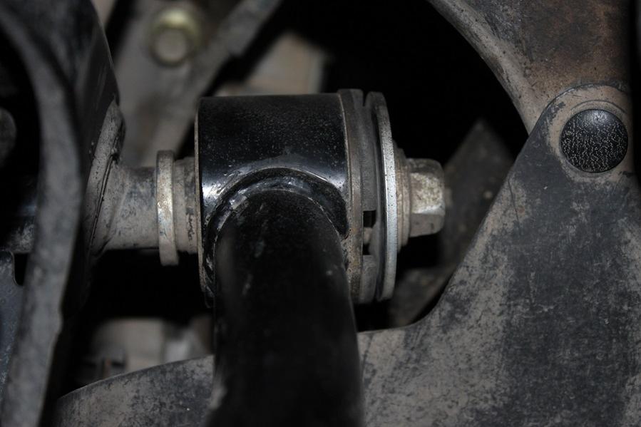

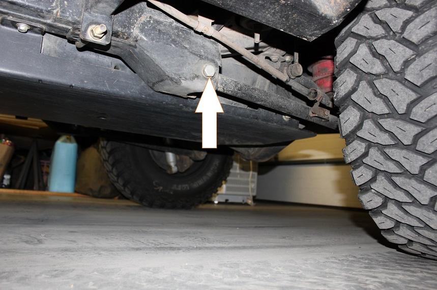

Was getting a weird 'click or pop' sound going thru 'S' corners, as the weight shifted from one side to the other. Tightened up the Alignment Cam Bolts and it seems to have fixed it. pic 1
Was getting a single 'clunk' after backing out of the garage. Just a one time deal, some times right away, sometimes it would wait about a mile at the first stop sign...then give one 'clunk'.
A little bit of wrench to the rear upper mount on the lower trailing arms seems to have fixed that...again...cant seem to keep that thing tight. pic 2

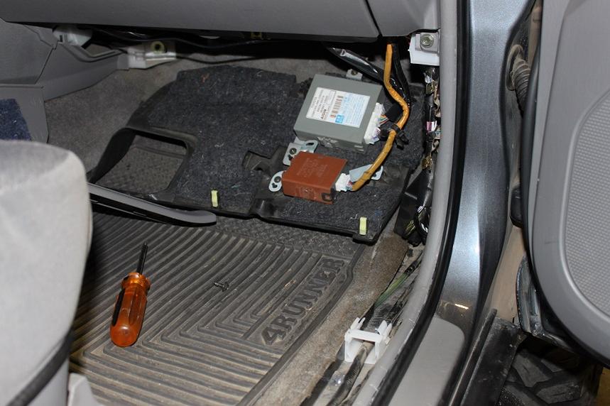

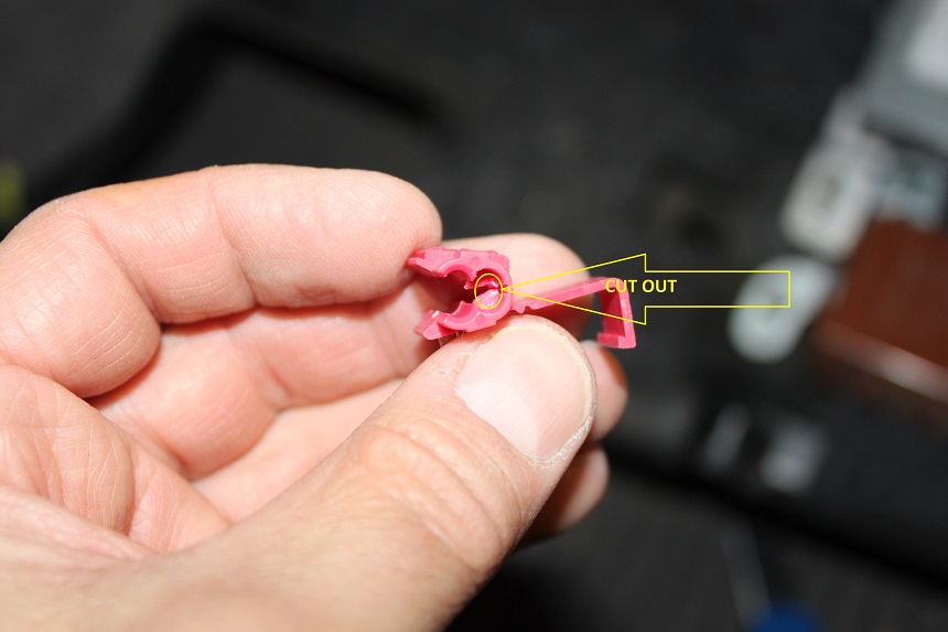

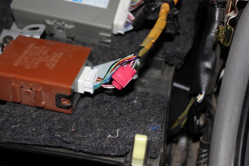

Followed the TPMS delete thread...cant find the post now...there it is...
Write-up: How to Disable (Bypass) the TPMS - Toyota 4Runner Forum - Largest 4Runner Forum ,fixed that pesky tire light thats been on for the last year...it would reset from the original wheel set I had sitting in the garage, on the other side of the old 1992 T4R...guess the sensors finally died after 14+ years.
Pink/black and white/black.
Later I see some of you are just pulling the plug and running a little jumper wire to the two wires at the plug end...leaving it unplugged... the no splice method.

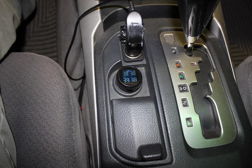

Do share the info. And why do you have tape on your charger?
TPMS
junk Ebay thing...dont bother.
That's the dashcam charger plug, it has a blue light on it that is way to bright so I just put a piece of tape to block the blue glow.

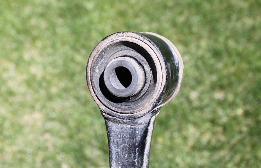

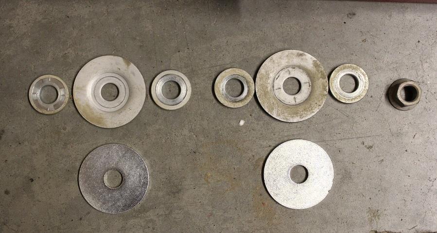

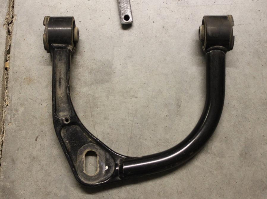

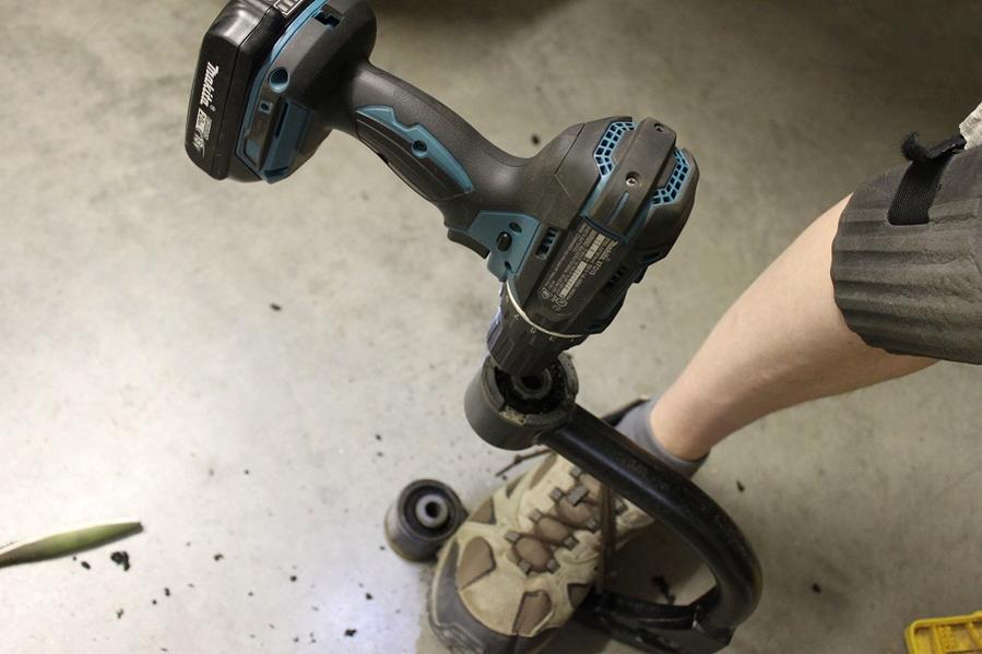

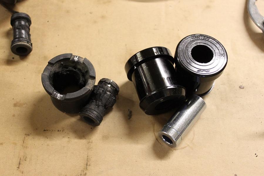

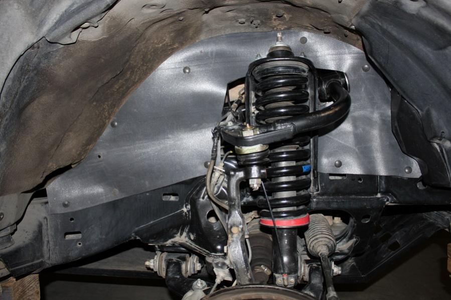

After getting motivated by a couple posts about SPC UCAs I finally installed new ball joints and bushings (SpecRide). Been sitting on the parts for a year.
I was not looking forward to doing the bushings, had read it was a pain...it is.
So this is just a refresh of the old UCAs.
I guess there has been various versions over the years, mine was the 1st version with rubber bushings, they were starting to look a little rotted after 7 years. 6 washers.
Original style no Zerk ball joints too.

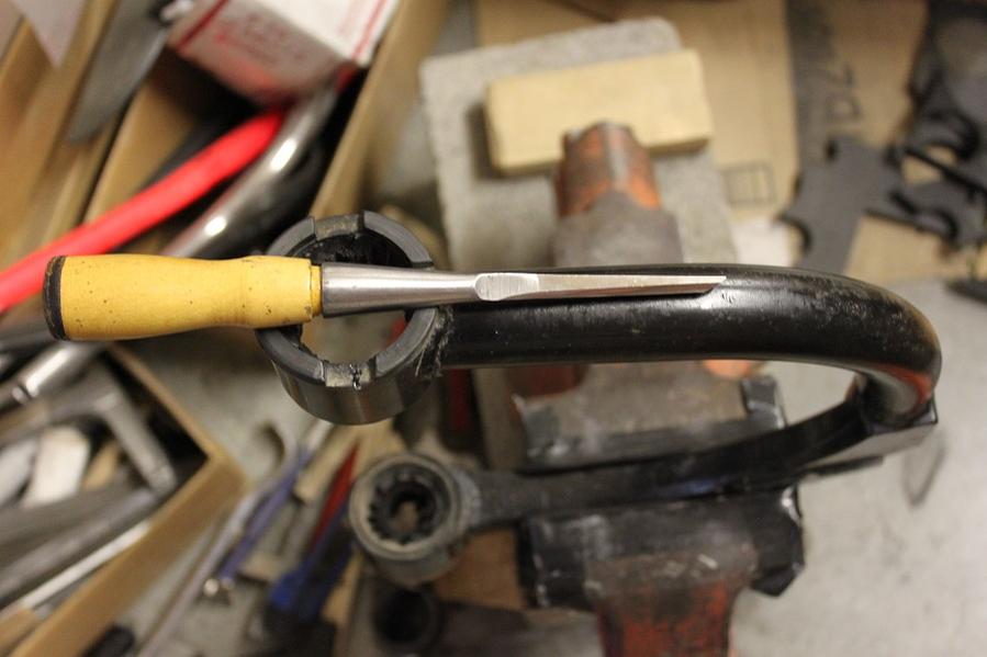

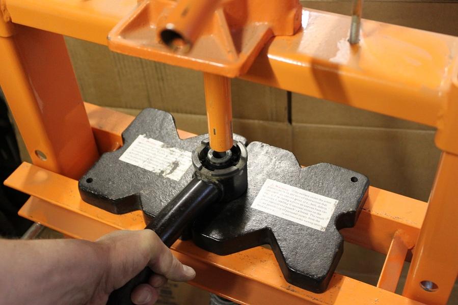

I used a drill to loosen up the old bushings then a press to push out the old inner sleeve.
Used a small wood chisel to cut out the old rubber bushing enough to get a saw blade in.
Started cutting the bushing sleeve with a reciprocating saw then finished with a hacksaw. That was the worst part of the whole project, cutting out the bushing sleeve without cutting the control arm. Each UCA ended up with a 1/16th inch cut in the edge of the inside bushing area...damn. No matter how careful I was I couldn't not cut the UCA.
Pressed new SpecRide bushings in with the floor press, starting them at an angle so as not to cut the new bushing. Can cut them if you try and install them straight I have read, seems counter intuitive.
Some Dawn Platinum, supper slippery soap to ease them in.
Also rounded the inner edge of the bushing area on the UCA so it would have less to hang up on.
Holy Hanna! 4 hours per side...I am whipped. UCA off and on is not bad but getting the metal bushing sleeves out was a serious pain in the butt.
If you dont get all the way through it you can hammer on it all you want and it wont budge, have to cut the sleeve completely...and not cut the control arm.

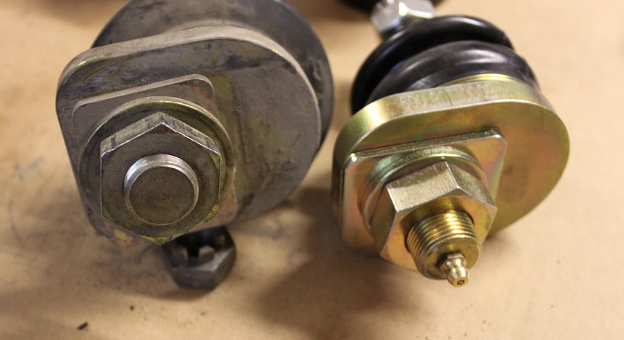

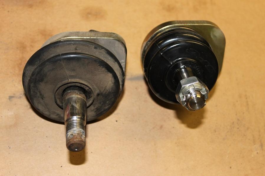

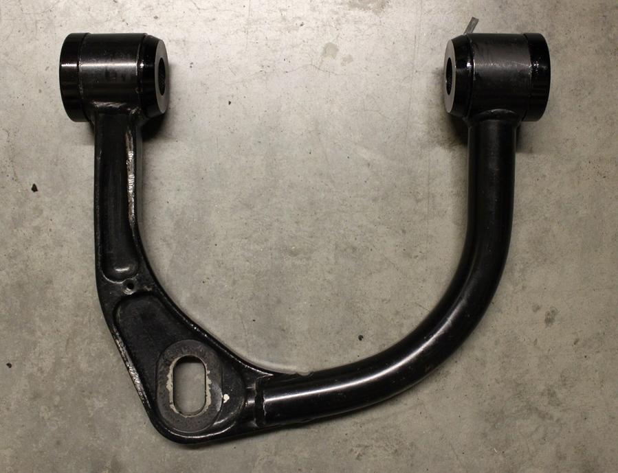

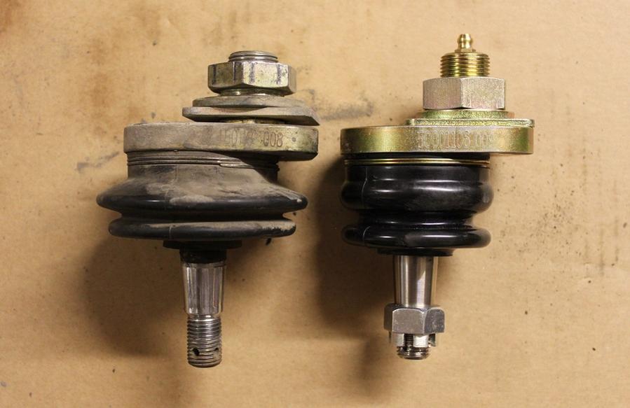

Couple compares of the ball joints and arms.

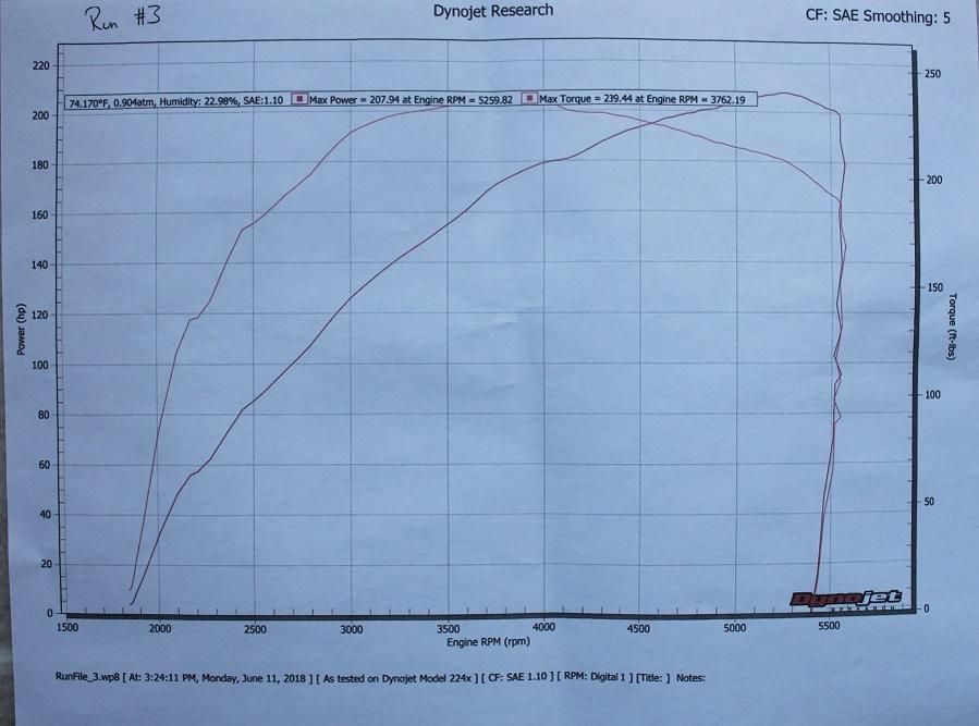

Finally had the T4R on a Dynojet engine dyno.
Not sure if I should be disappointed or not?
So, on the ScanGauge2... I started out seeing 272hp then 295hp then the best I ever saw was 305hp...mashing the skinny pedal to the floor.
The Dynojet saw 207hp at the rear wheels...sigh.
They did say that driveline can eat 30%...that's 62hp so maybe getting 269hp if I am lucky, closer to the original estimate.
I do love the way this T4R sounds now, slightly aggressive but not obnoxious at all...no ricer this. It is louder than stock.
It is the first time I have heard it winding up, not me behind the wheel.
The guys at the shop seemed to like it...American muscle hot rod type guys.
I guess I am happy...its no supercharger but its got a little more juice to it than OEM.

I didn't dyno it stock so I don't really know if I went backwards or not.
It feels faster/better in the butt dyno, for what that's worth.
I wanted it to read out at least 272hp...lol :wacko:
The 207hp that the Dyno spit out was a bit discouraging.
So according to it I lost ponies...245 to 207. They did say that the drive-line can eat 30%...tires/transmission.
Maybe they said that just to make me feel better?
The guy at the shop mentioned that they had a K&N on a car and it lost 5hp...kinda along the lines of what a few others have said here on the forum.

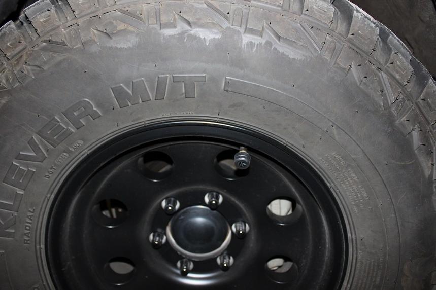

And the FAIL... that neat/cheap China TPMS...2 bad batteries...not 6 months... 15 years for the OEM...
I may look into replacing the batteries or just check it manual...most likely what I will do...like I allways did before these TPMS came along. Almost like we just add to the laziness of our culture with all these 'Great' features.

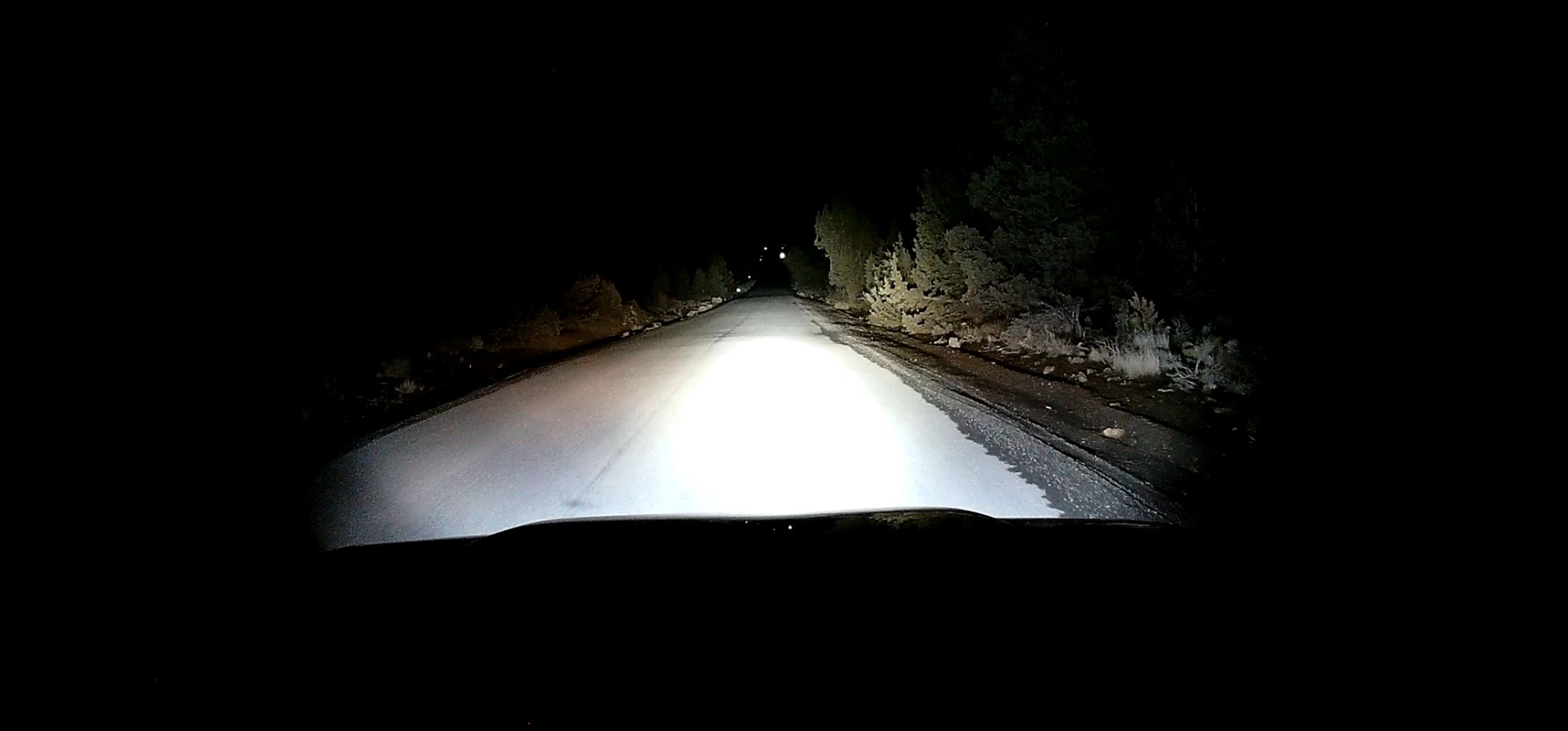

Here are a couple night light shots.
Furthest reflector is close to half a mile away.
Stock
Spot
Pods
All

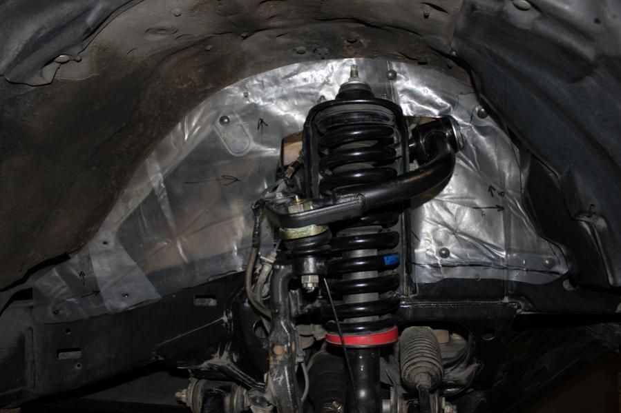

Added some full coverage splash guards.
Made from 1/16" rubber (leftover from a tile shower floor repair, similar to inner-tube material). Template made with clear sheet plastic.
So far no engine temperature increase...is winter here.

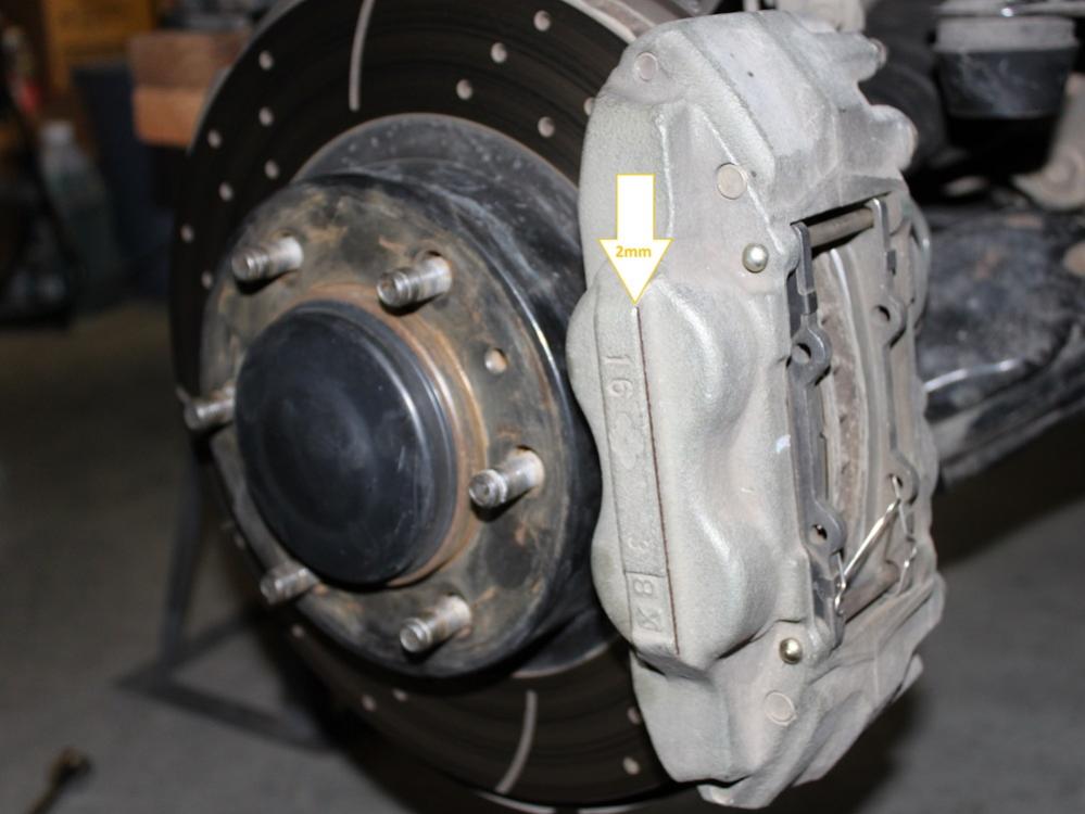

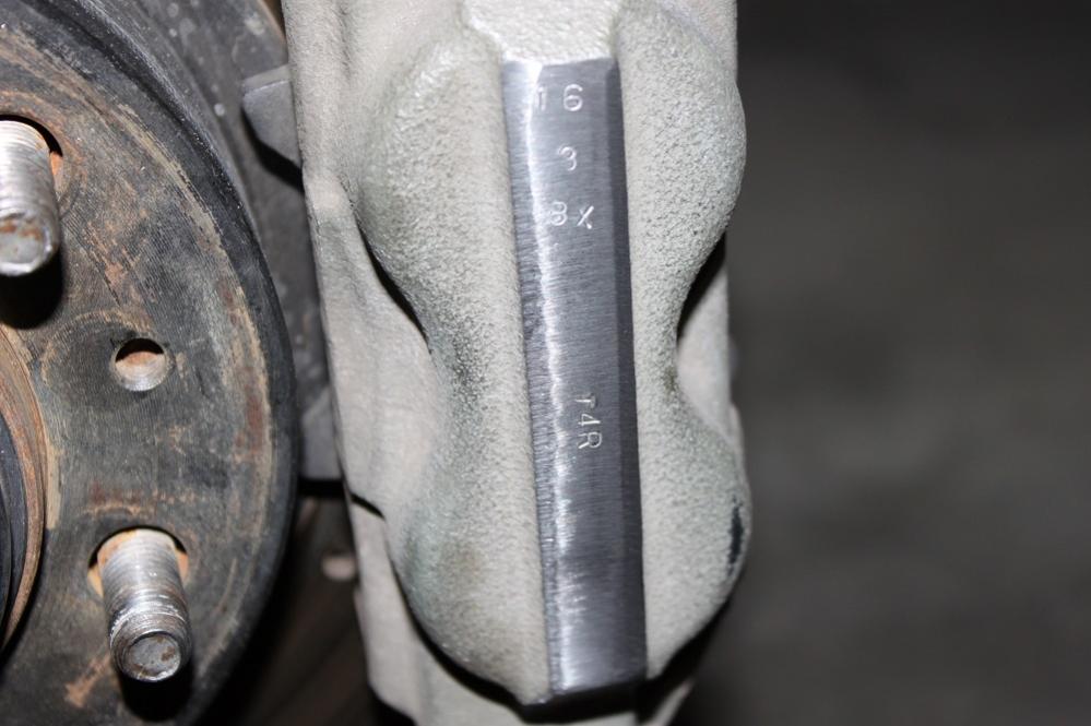

Got fed up with the 1/4" front wheel spacer, to clear the caliper/rub.
Took after it with a 5" sander disc on the drill, 50 grit made short work of it.
Shaved off 2mm, I will report in if anything blows up. Looks like its so far so good.

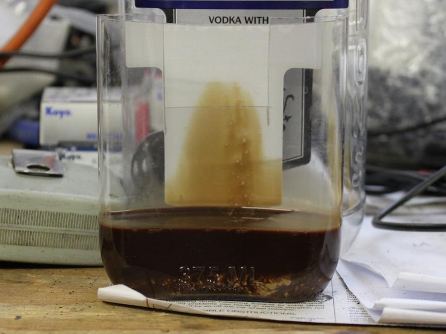

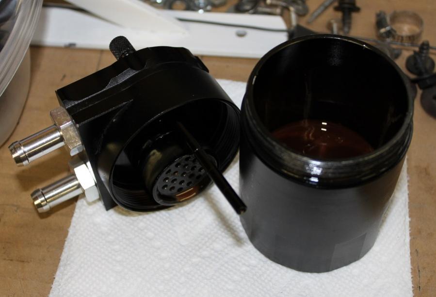

Added a knock-off ADD W1 oil catch can last year. Under $30 eBay.
Cleaned up the drilled holes, metal burs, I didn't want to get sucked into the intake, easy clean up with a drill bit. By hand.
Same amount of oil removed from the intake after 5k miles as the old one. I only put 5k miles a year on the T4R.
1" in the bottom of a pint container, more water look to it than the larger, previous oil catch can. That other can started to leak from the seal at the bottom of the can and the 'inspection tube' was turning dark and warping.
This is coming past the PCV valve, I must just be imagining it...
