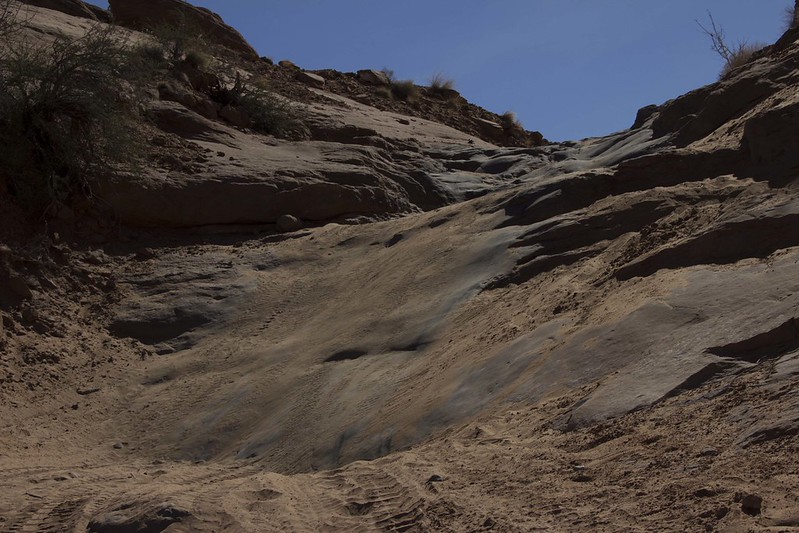

I absolutely loved them. They hooked up much better than I thought they would on all terrains and there was only one line I couldn't take because they lost traction (pre launch pad on poison spider). I think the waterfall on poison spider and top of the world in general really showed how well they grip and gave a very good mix of terrain. The second section of the waterfall has a very steep sandy section that I wasn't very confident about because I could hardly walk up it but the 4runner went right up without slipping a tire.
Overall the tires held up really well and I lost under 1/32nd of tread during the 1600 mile trip and they were just as quiet as the bridgestone duller highway tires I had before. I would highly recommend these tires for anyone looking for a good all terrain tire.
Heres that section i was referring to

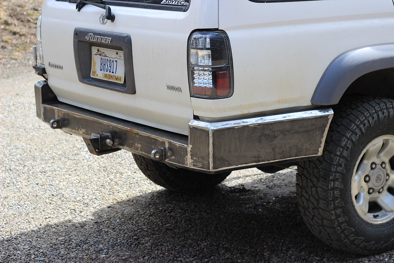

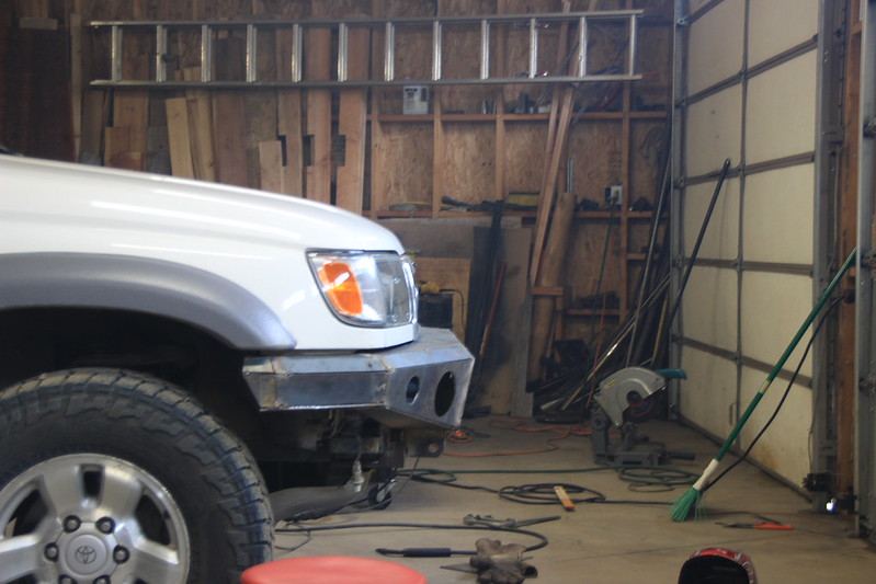

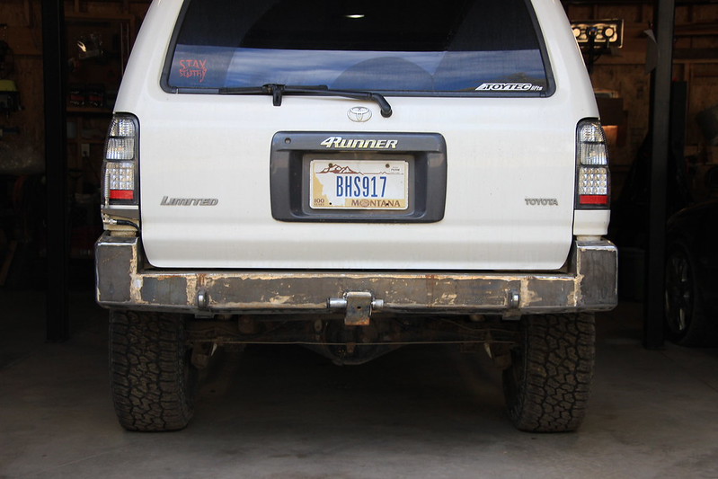

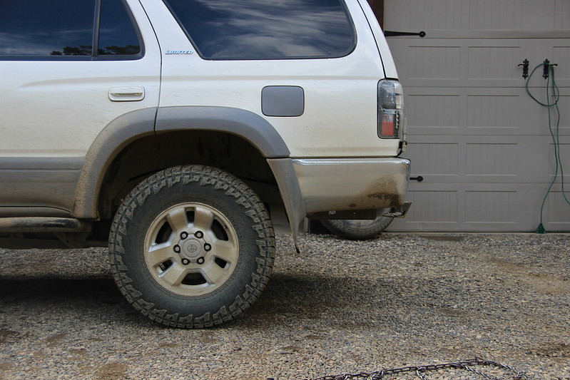

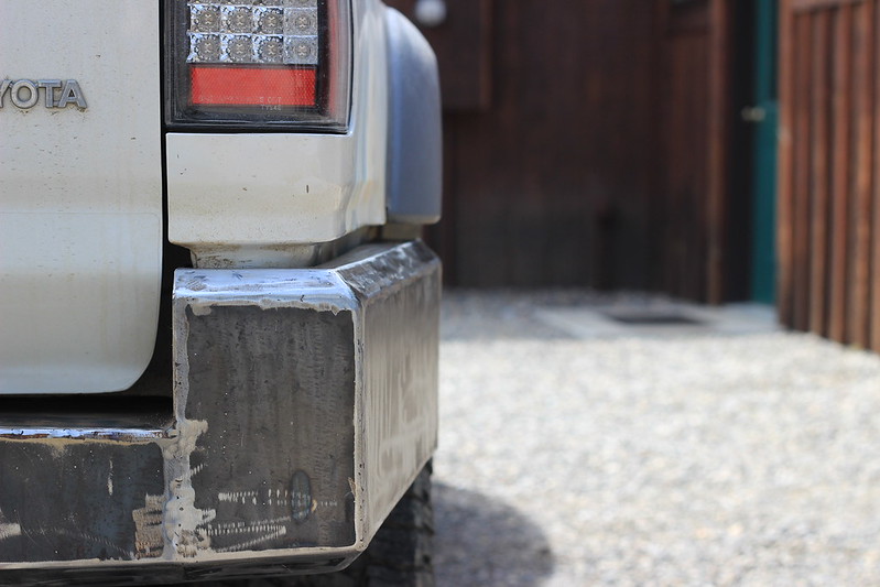

Rear Bumper
Finished up the fabrication on the rear bumper, still have some small holes to fill but good enough for now. It took the entirety of two weekends but Im super happy with the way it turned out. Eventually I will add a swing out but that will be later down the line. I also need to add some poly body mounts in the back from sonoran steel because I can see that being a problem already. Im also waiting untill I finish the front in the next few weeks to powder coat them. Im thinking a hammered grey/black to go with the grey flares.
Like this
IMG_3577 by Phoenix Black, on Flickr
Before...
IMG_3510 by Phoenix Black, on Flickr
IMG_3508 by Phoenix Black, on Flickr
After...
IMG_3566 by Phoenix Black, on Flickr
IMG_3557 by Phoenix Black, on Flickr
IMG_3559 by Phoenix Black, on Flickr
I didn't know you had a build thread! Moab looks like it was a success for you too. Too bad we didn't cross paths. I crossed paths with Derpiful and his group also, but out near Gemini Bridges. You're right those RZRs are the worst thing ever.
New rear bumper is looking good, you shouldn't have a problem dragging that one around. I drug mine pretty hard on Fins n Things and Top of the World. A little touch up and it's as good as new.

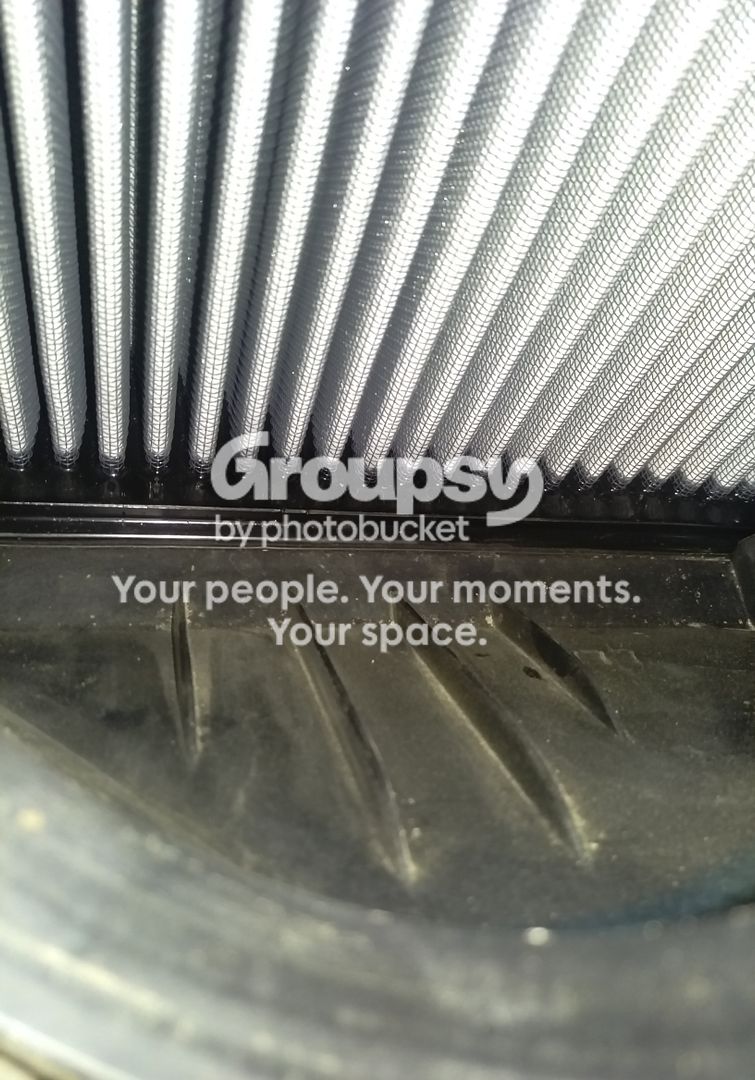

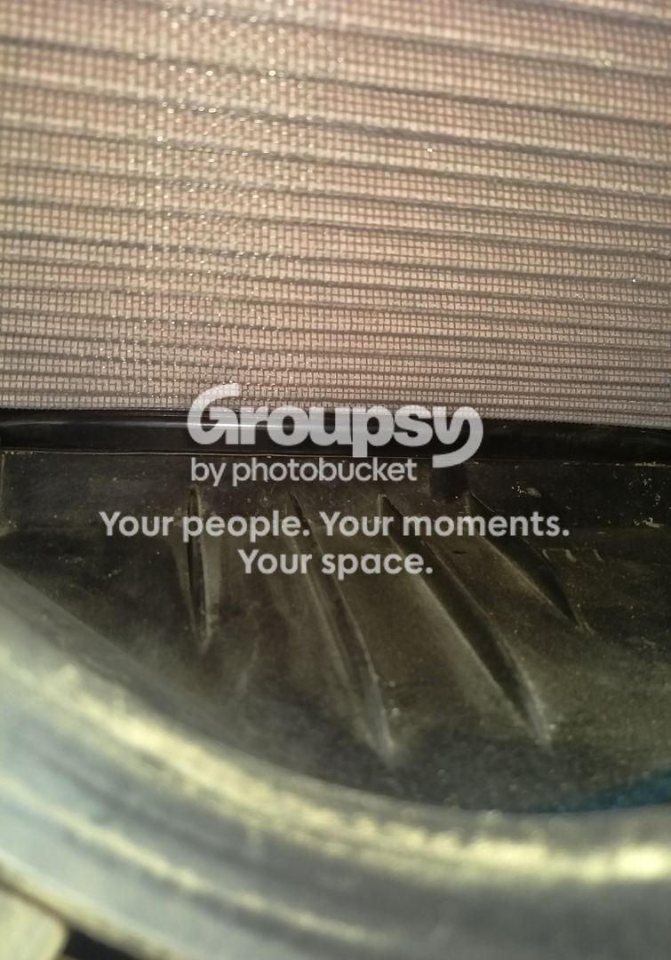

So my afe air filter showed up today so that I could get rid of the k&n. Overall the afe has a much better quality fit and finish. It blocks all the light when held up to a flashlight unlike the k&n which had little holes all over in the filter media. And the best part is it actually seals properly. I highly recommend the afe drop in filter and that anyone running a k&n check to make sure they're filter is actually sealing. I currently have a fitment issue filled with k&n but I dont see it really going anywhere. But I was able to get a full refund at autozone so I really dont care at this point.
afe seal
k&n, here you can see how the lower lip doesn't seat into the seal and creates a huge gap for dirt to get in.

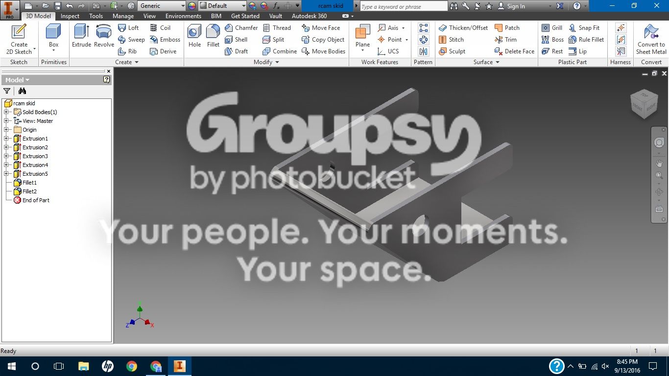

Also finished modeling the lower control arm mount skids so those will be getting built soon.

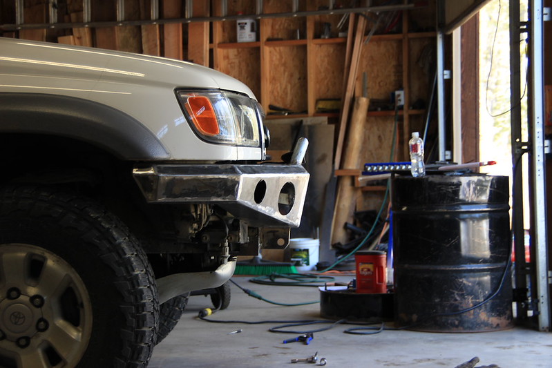

Front Bumper

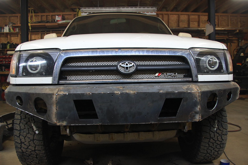

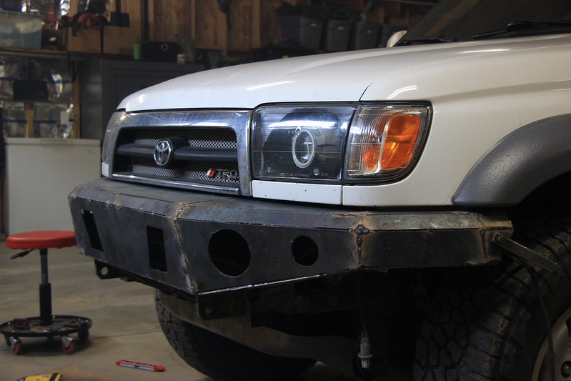

Well its not done but I had a three day weekend so I got to work on the front bumper and am really liking how it has come together. I still need to fully weld and grind all the seams, add the light bezels for the driving lights, enlarge the holes for the blinkers, and add a small pre runner bar on top to accommodate a single row light bar down the road. Sorry about the picture quality but it was snowing so I couldn't get out of the shop and keep everything dry
IMG_3606 by Phoenix Black, on Flickr
IMG_3607 by Phoenix Black, on Flickr
IMG_3608 by Phoenix Black, on Flickr

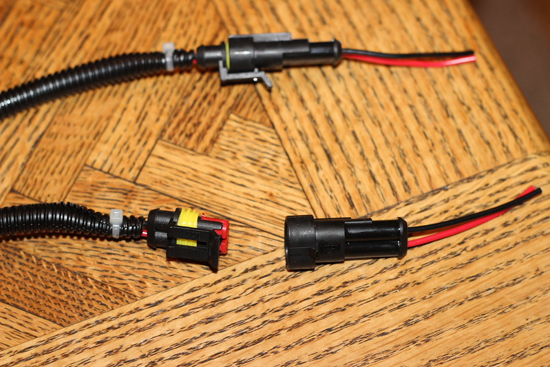

Also added these little waterproof connectors to the blinkers and driving lights to clean up the wiring.
IMG_3583 by Phoenix Black, on Flickr

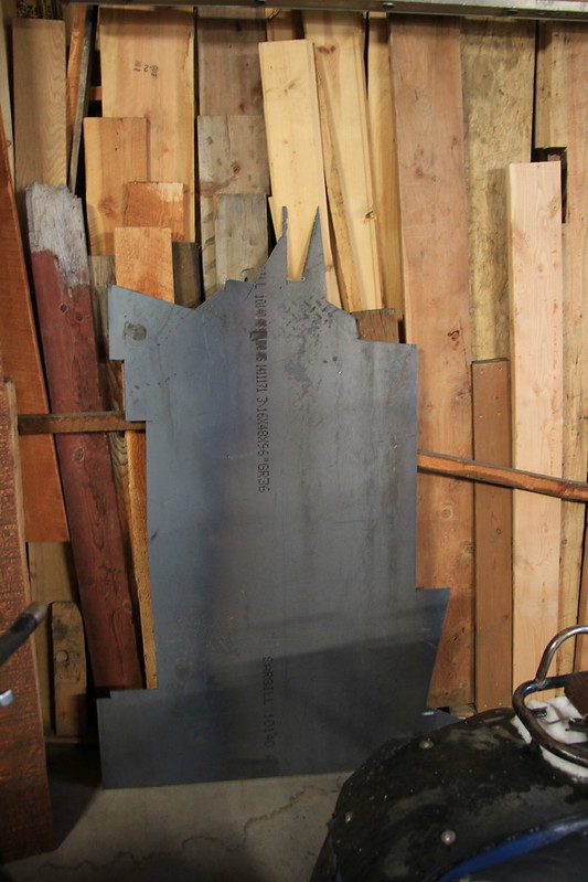

Oddly enough the left over steel from the 4x8 sheet I got looks an awful lot like a skid plate so that may be the next project....

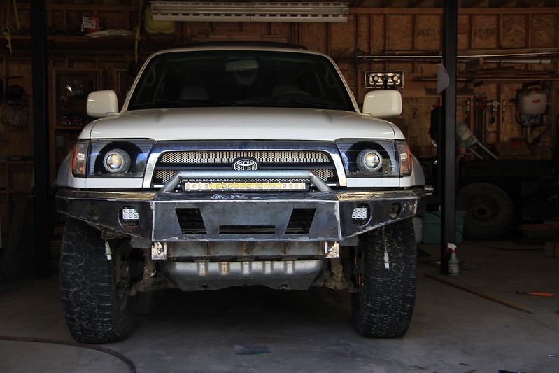

I managed to finish the front bumper this weekend and dropped them both off at the powder coater's this afternoon. Total I have about 110ish hours into building these but I really like how they came out and I'm pretty proud of what I was able to do with a plasma cutter, angle grinder, and tig/mig welder. Cant wait to get them back in a few weeks.
IMG_3616 by Phoenix Black, on Flickr
IMG_3617 by Phoenix Black, on Flickr
That front bumper turned out awesome! Having a plasma has got to make things much more convenient. I'm hoping to get one soon but I need a better compressor to keep up with it. Great job once again!
Looking good man! I like that bumper! Are you planning on painting it to match your grey flares? Would look sweet!

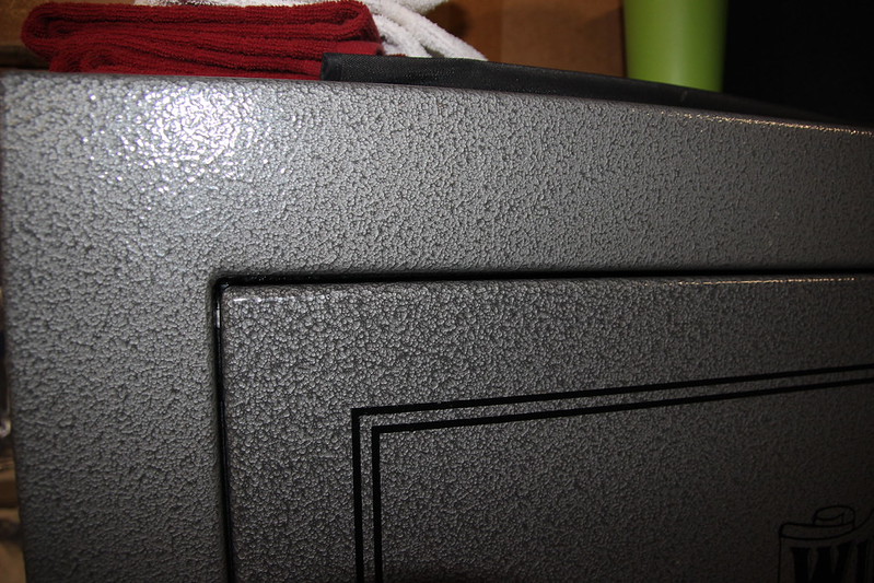

Thanks! Originally that was the plan to do them grey but after talking with the powder coater I decided on a hammered semi gloss black. He said it would be the easiest to touch up later and would hide abuse for the longest.
The plasma was a life saver. There's no way I could have done this without it
Looks great. Like a more refined 4x innovations and I'm sure better quality.
You should start producing
I did use the 4xinnovations bumper as a model, but mostly for the rear. For the front I was trying to get something similar to the allpro apex just without modifying the vehicle frame which I was able to do.
Unfortunately these will be one off customs. I dont have a way to effectively produce these since they were entirely in my head and built on the vehicle so the cost would just be too high.
