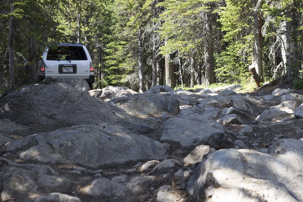

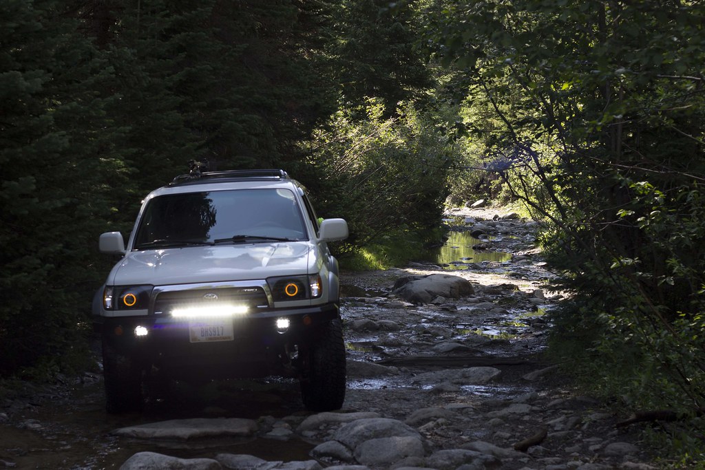

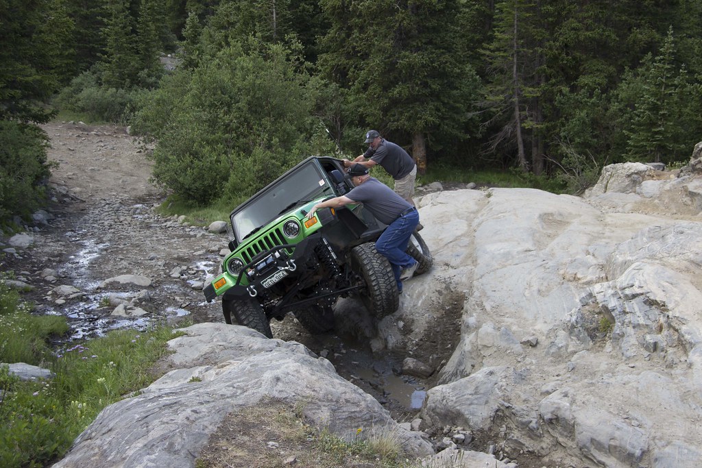

Yesterday my uncle and I headed up and ran wheeler lake. This was definitely the hardest trail Ive done to date. I made it up all the obstacles open open and my armor got a good workout, especially the sliders.
Didnt get any good pictures of the first obstacle but I did get some video that I will upload later.

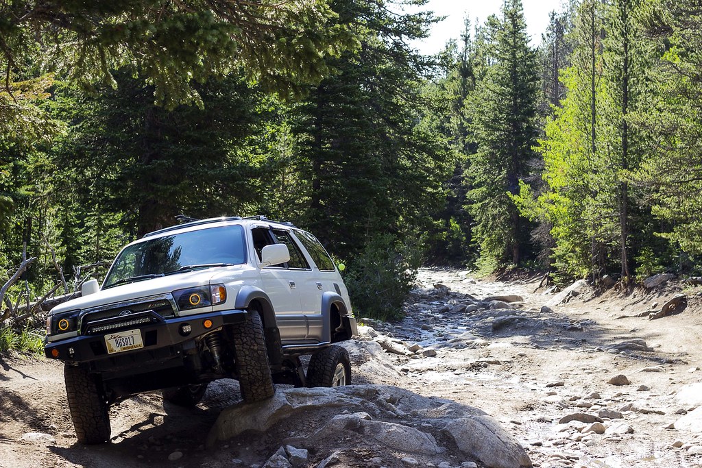

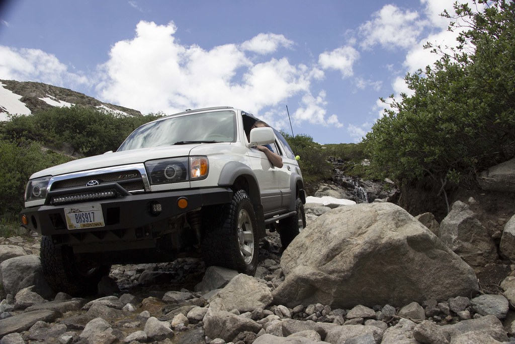

Coming up the V. I struggled a bit on this one and put a good dent in my gas tank but made it up under my own power.
IMG_4926 by Phoenix Black, on Flickr
Watched this jeep almost flop after he accidentally popped the clutch in reverse.
IMG_4968 by Phoenix Black, on Flickr

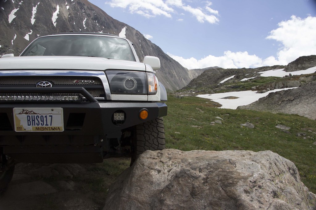

Posing up against a rock at the top of the trail
IMG_5063 by Phoenix Black, on Flickr

Coming back down the V, little bit of a pucker factor here
IMG_5111 by Phoenix Black, on Flickr

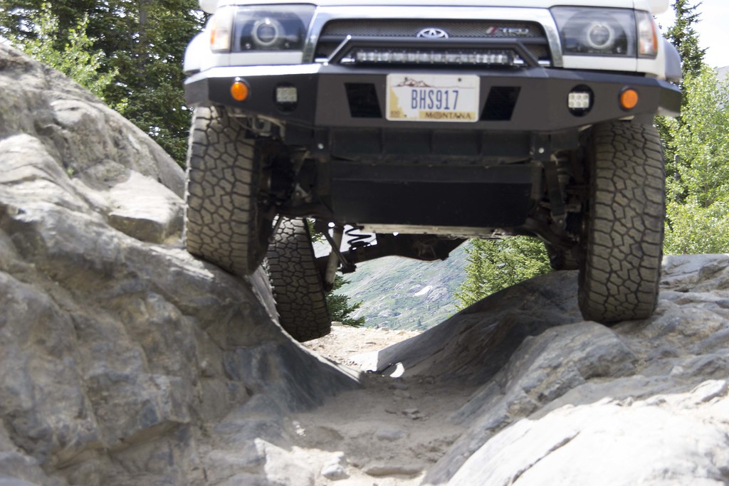

Got Flex?
IMG_5196 by Phoenix Black, on Flickr

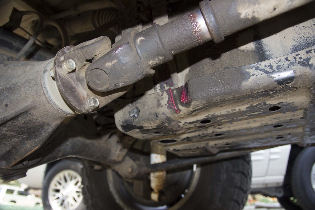

Absolutely one of my favorite trails, took a ton of pictures, these are just my favorites, and had a great time while not breaking anything major. My gas gauge is now stuck at 3/4 of a tank and my driveshaft rubbed the tank enough enough to shear the zerk off so I will be making a new tank skid soon and dropping the tank today to fix the gauge and the dent in it. [MENTION=118730]AssBurns[/MENTION] I take back what I said about feeling the need for a gas tank skid
IMG_5251 by Phoenix Black, on Flickr
Cant really see the dent here but

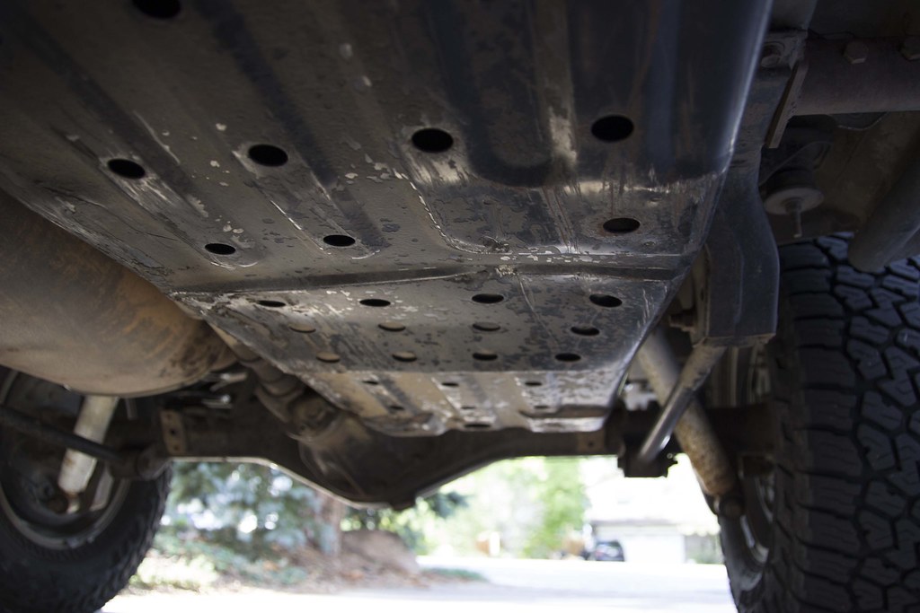

Hahah I was looking at the pictures thinking "This guy must be a really good driver if he is running these kinds of trails and doesn't hit his gas tank ever". Then I saw your comment. Our gas tanks are like rock magnets. I hit my gas tank more thank my diff I feel like. Actually on my way to pull a new tank to repair last weekends incident.
Great pics btw! I like that one from the front showing the rear flexing. [emoji1303]
You know it was weird, until yesterday I had only scraped it once or twice and then yesterday it seemed like every damn time I got hung up it was on the tank. I just got mine out and am working on pushing the dents out.
Love that flexed out, under-body shot. Looks like the rear control arms are getting a work out
Thanks man, its one of my favorites from the trip. Those rear arms have really put in a lot of work recently and the bushings are showing it a bit. Hopefully I can get another season out of them though before I upgrade to some beefier ones. Im trying to keep a tight budget right now because Id like to add a rear arb before next summer.

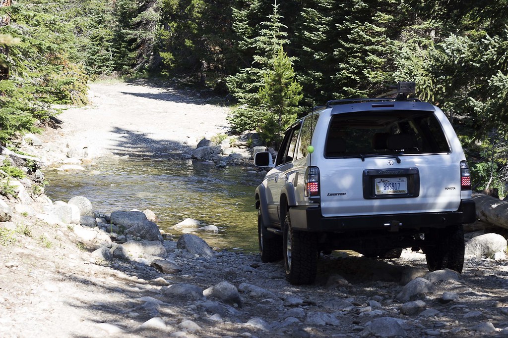

These trails had a lot of water crossings like this which I liked a lot. Especially the big "lake" at the top
IMG_5279 by Phoenix Black, on Flickr
IMG_5285 by Phoenix Black, on Flickr

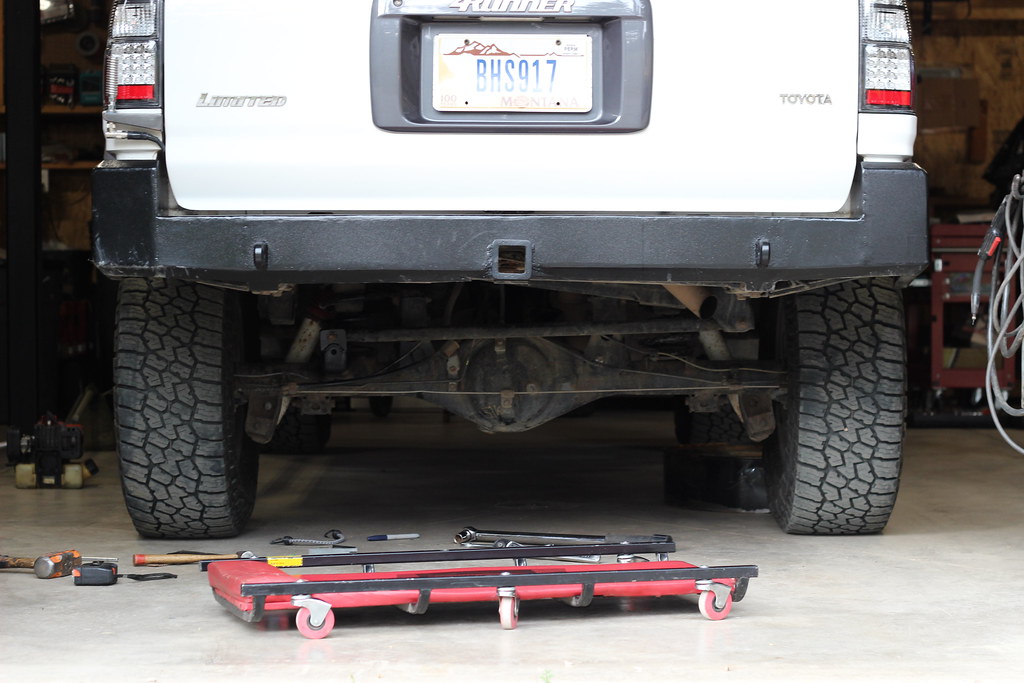

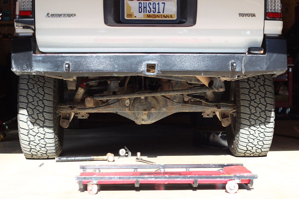

Panhard Lift

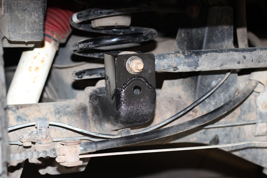

Today I used some left over 3/16 plate I had from the skids to make a panhard lift bracket. I haven't seen many people who have done the panhard lift so Ill give a brief explanation as to why I choose the lift over the drop.
Panhard drop vs lift
Theres a lot more science to this than I understand but the basics of it are your panhard travels in an arc as the axle moves inside of the suspension travel, this causes the axle to shift from side to side. In lifted applications such as this the stock bar rests at an angle rather than flat, there are two problems with this:
1.) it causes the axle to shift side to side more going over bumps since the bar is moving in a more severe arc
2.) having the bar at an angle effectively lowers the roll center which is the point the vehicle leans around going through turns.
One way to correct this angle is with a panhard drop, which in cases where the bump stops have not been extended is the only option, while the panhard drop corrects the angle. It moves the roll center down and away from the center of gravity which increases body roll.
The other way to correct this is with a panhard lift bracket on the axle end. This is only possible with extended bump stops, otherwise the bracket will contact the frame, but this both fixes the angle and raises the roll center bringing it closer to the COG effectively making the vehicle more stable in turns.
Here is a great thread that goes more in depth.
And another link explaining roll center
Onto the pictures.
This illustrates the change in roll center by lifting the bar by 1.75 inches in my case. I was able to take the bar angle from 6 degrees down to 1
The intersection of the orange lines is the approximate COG, I pulled those measurements off of a thread on yotatech and while these measurments are different for everyones rig its close enough to show the idea. The intersection of the two red lines was the before roll center, the intersection of the green and red are the new roll center. You can see how the roll center is roughly 1.75 inches higher
roll center by Phoenix Black, on Flickr
Before angle
IMG_5317 by Phoenix Black, on Flickr
After angle
IMG_5321 by Phoenix Black, on Flickr
It is best to look at the before and after in a seperate window side by side to see the difference the best due to the difference in picture framing, I should have set up a tripod.
Close up
IMG_5322 by Phoenix Black, on Flickr

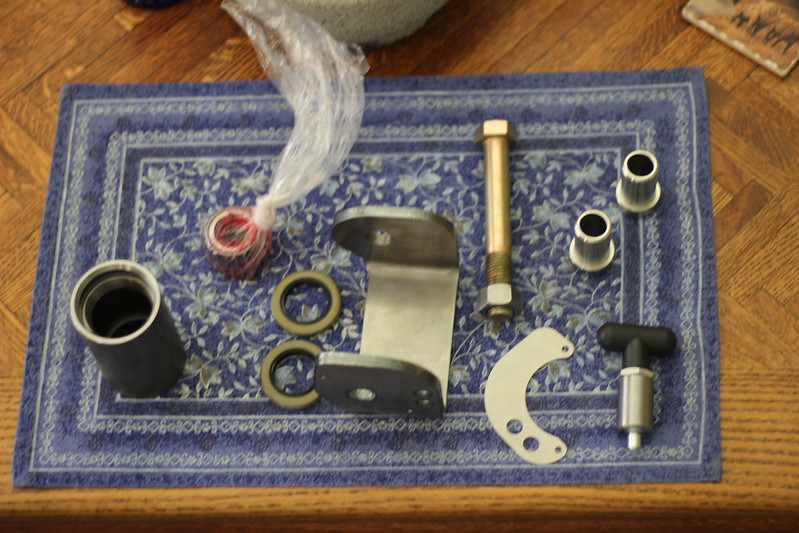

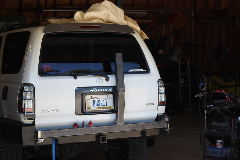

First thing was the hinge, I went with the 4xinnovations hinge because it has a double shear design and IMO is the best designed hinge for the money. All I have to say it is super beefy and that Adam did a great job designing it.
All the hinge parts
IMG_5348 by Phoenix Black, on Flickr

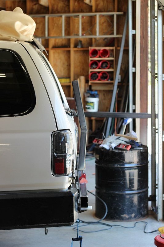

After I got that all welded on I started working on the main structure, its made out of 2x3 .120 wall tube. I wanted to keep the tire as tight and high as reasonably possible to keep from dragging it on obstacles.
IMG_5366 by Phoenix Black, on Flickr
IMG_5367 by Phoenix Black, on Flickr

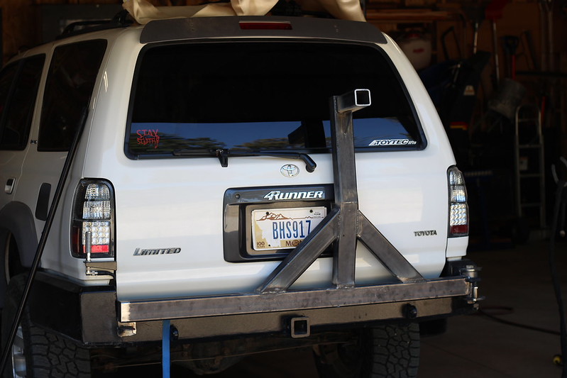

Added in some bracing and the mounting tube for the tire flange
IMG_5369 by Phoenix Black, on Flickr
This was as far as I got today with getting the tire mounted. So far Im pretty happy with the fitment and how it is all coming together. Theres still a lot more work to do though. To be continued...

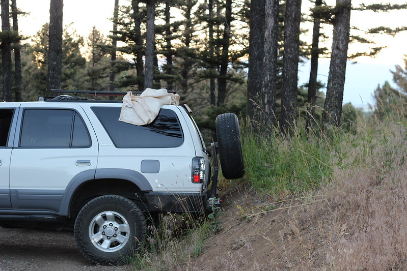

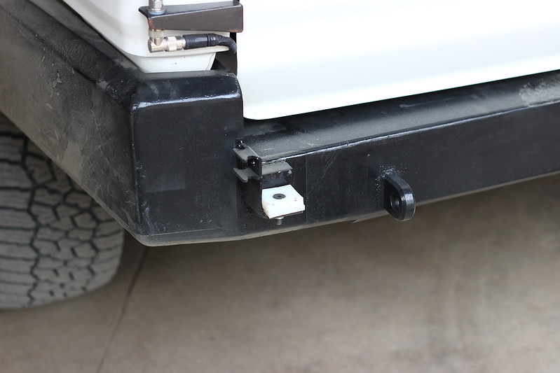

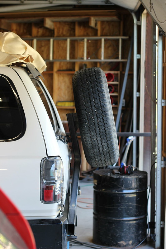

Tire Carrier pt. 2

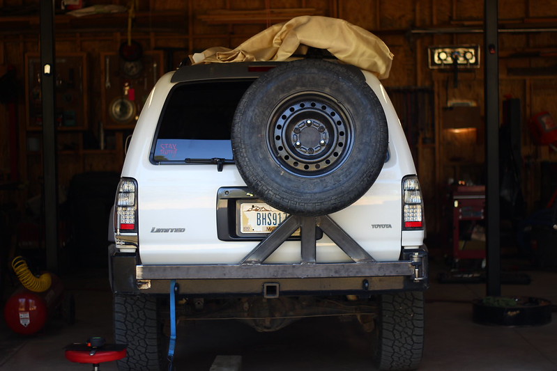

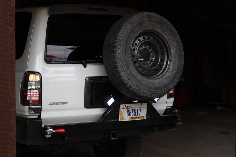

I finished the tire carrier this last weekend and am super pleased with the results. I had to add some more internal bracing to the bumper but the arm is super solid and doesnt move at all when going down the road. I didnt get to take many pictures because I was on a mission to get it done but heres a quick run down of what I did.
1st, I lowered the tires by 2 inches
2nd figured out the latch hook
3rd added the license plate frame and wiring guides
4th paint an old license plate to fill the stock location
5th paint and install.
For paint I tried something new, I used rustoleum professional gloss black enamel and I sprayed it through a cheap harbor freight hvlp paint gun. The finish came out decent but its a little soft, I think I can refine the technique and get much better results.
Pictures
Checking departure angle, should be sufficient
IMG_5394 by Phoenix Black, on Flickr
The latch catch. it preloads the arm up slightly so I am not wearing on the spindle.

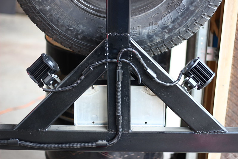

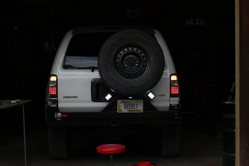

Reverse Light set up, I originally wanted the lights inside the triangles but they wouldn't fit, thank you BFAD for the mounting idea
IMG_5412 by Phoenix Black, on Flickr
Closed
IMG_5417 by Phoenix Black, on Flickr

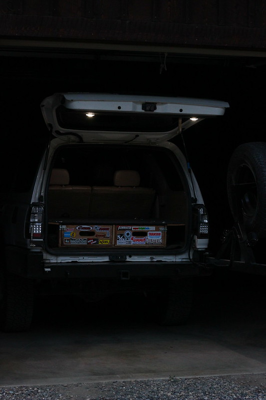

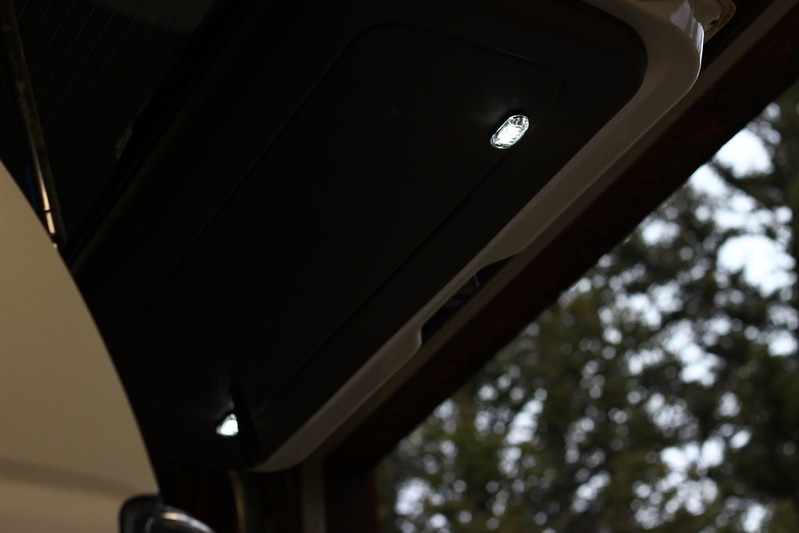

I also added some small lights in the hatch to put some more light into the area at night, I tied them straight into the regular dome light.
IMG_5429 by Phoenix Black, on Flickr
IMG_5444 by Phoenix Black, on Flickr
Theres still some little details to take care of but overall its done. Im also not the biggest fan of the stock spare look and I would like a full set of matching rims and as much as I love the stock 3 spokes I would like to upgrade and I really like the scs ray 10s. So a set of these in the matte gray variety may be in the somewhat near future....
Ray10_LINEUP_zpsvnmlwrnf by Phoenix Black, on Flickr

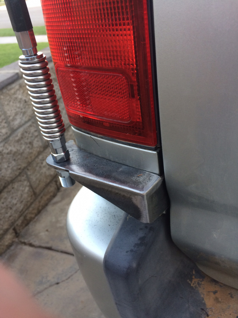

Looks great! I might be using the same spindle. Still not decided how I want to design my swing out. The double shear design is pretty sweet and easy to mount and looks awesome. There is a pretty beefy single shear one that a few big manufacturers use that I can get from the actual machine shop at a discount. Not sure exactly which way I'm going though yet.
Also my CB antenna mount looks almost exactly like yours. Great minds think alike [emoji6]
They for sure do haha. It's a great design because it looks relatively stock and is clean and simple. I do wish I had of made mine a tad bigger to add a little rigitity but otherwise it's worked perfect
