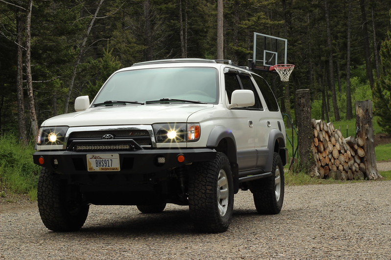

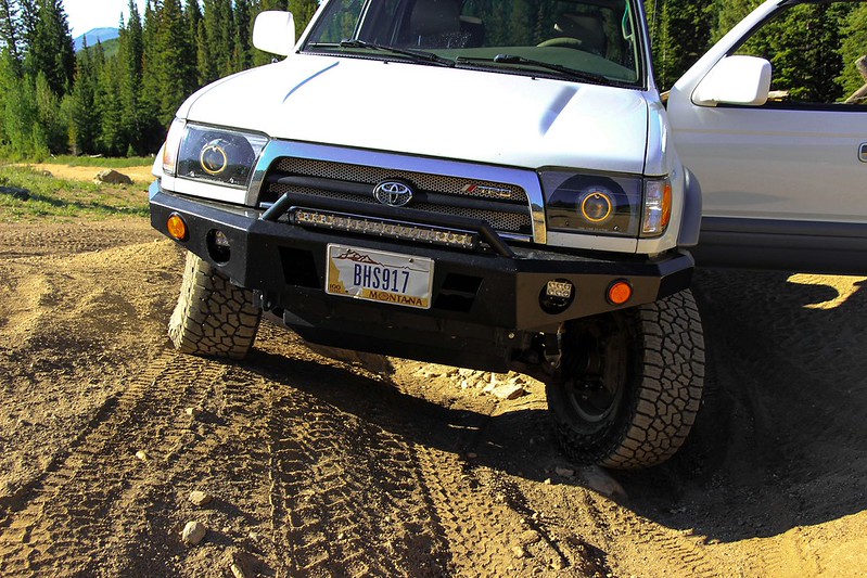

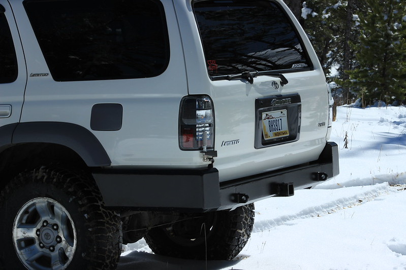

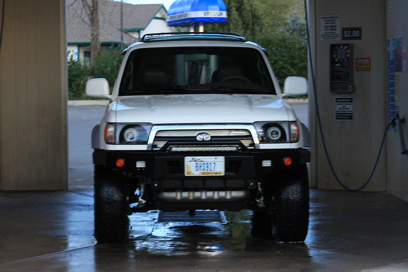

Bumpers installed
Got a call on Wednesday that the bumpers were done a week ahead of schedule so I picked them up and installed them last night. I really like how they turned out, especially the front.
IMG_3736 by Phoenix Black, on Flickr
Front bumber by Phoenix Black, on Flickr
IMG_3741 by Phoenix Black, on Flickr

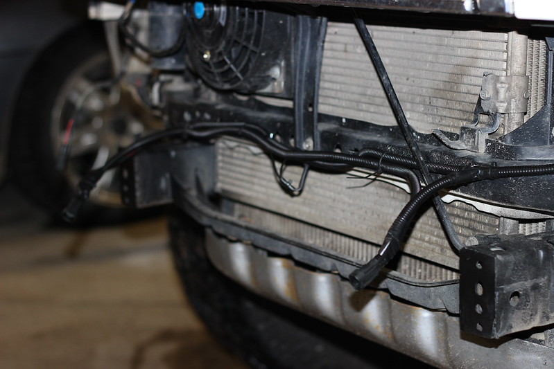

When I went to put the front bumper on I took one look at the driving light wiring and decided to rip it out and start from scratch. Ended up with this, much cleaner with waterproof connectors
IMG_3716 by Phoenix Black, on Flickr

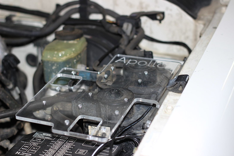

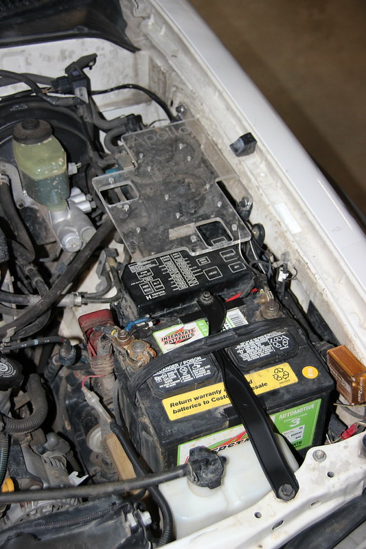

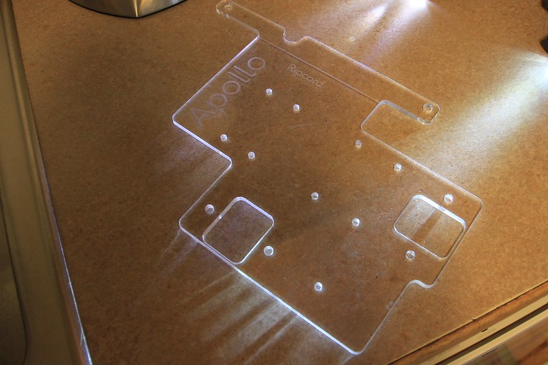

Also picked up a set of plans from [MENTION=57546]4-Ripcord[/MENTION] for a fuse box platform and cut it out on my school's laser. For those wondering Apollo is the name my parents have given the 4runner since the Moab trip. Now I just have to decided when I want to add all the blue sea goodies but Im really looking forward to cleaning up my wiring.
fuseblock platform (4) by Phoenix Black, on Flickr
fuseblock platform (1) by Phoenix Black, on Flickr
This is so far my favorite front bumper, looks beautiful!

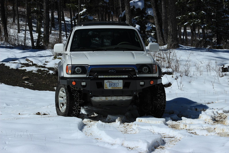

Went on a short evening run up Flathead pass last Friday with a couple friends, its about the only decent trail that is both open and close by. Not a very difficult trail but it was a fun time. Also had the awesome opportunity to meet the guys at Expedition Overland and tour their new shop and all the rigs. I saw their Tacoma sitting out front and couldn't help dropping in, sadly didn't get any pictures of it though.
IMG_3772 by Phoenix Black, on Flickr
This was about the most exciting part. I was staying on top of the snow pretty well till right here where I ended up burying the front end and getting high centered on the skids. Then about 5 minutes later my friend did the same thing trying to get to where I was to pull me out so out came the shovels and an hour later we were out and headed back down.

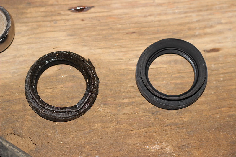

That being said the 4runner was in need of some attention before this trip. The front transfer case seal was leaking, the front diff was leaking on the driver side, the steering rack guide is clunking really bad (has been since Moab), the sway bar links were squeaking real bad, and the oil was right at 5000 miles. So I spent a good bit of time this weekend filling my eyes with dirt and catching up on maintenance. Rotated the tires, painted the center caps, replaced a couple seals, new steering rack guide, greased the driveshafts, and changed the oil.

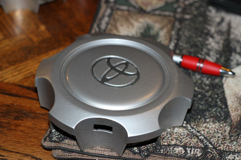

Painted center caps, look so much better
IMG_3826 by Phoenix Black, on Flickr
Old transfer case seal vs new oem
IMG_3878 by Phoenix Black, on Flickr

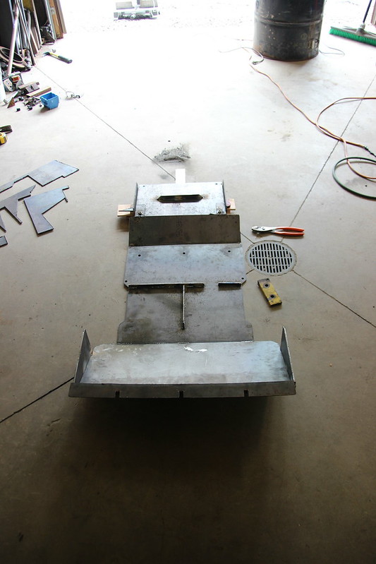

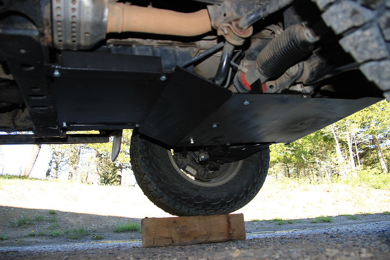

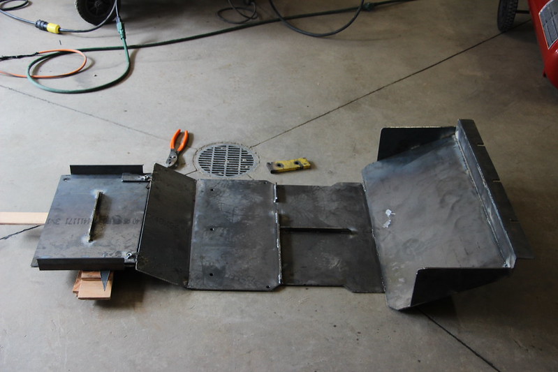

Custom Skid Plate

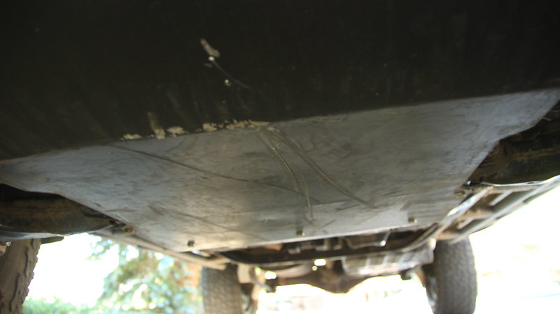

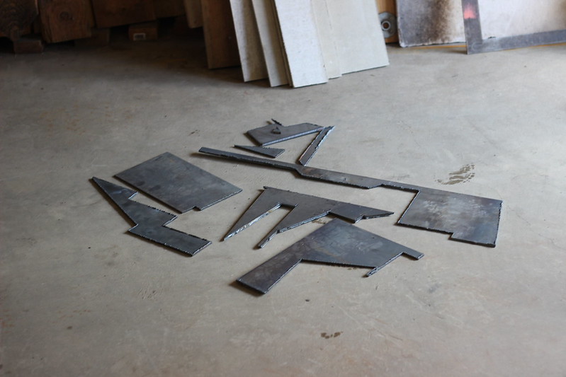

This last weekend I used up the last of my 4x8 sheet of steel and made a set of skids to cover both the area of the stock skids and continue back to the transmission. I was constantly paranoid about hitting the transmission in Moab so I figured that these will help put my mind at ease. Originally I was just going to reinforce the stock skids but after looking at it the time didnt seem worth the reward so I opted to just build a complete set and once again I was very pleased with the outcome. I can lift the whole truck off these and they dont even flinch at it
I am also offering the plans or these skids for sale here
IMG_3888 by Phoenix Black, on Flickr
IMG_3890 by Phoenix Black, on Flickr
skidplate finished (2) by Phoenix Black, on Flickr
skidplate finished (6) by Phoenix Black, on Flickr

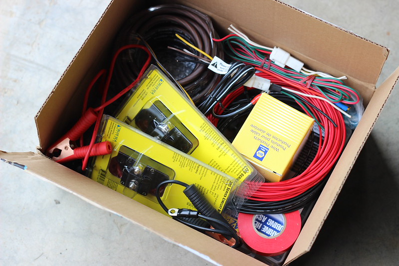

Also have this box of goodies to take with me. Hopefully by the end of the weekend I will have the big 3 and aux fuse box done.
IMG_4480 by Phoenix Black, on Flickr

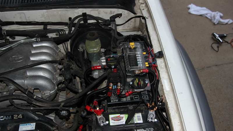

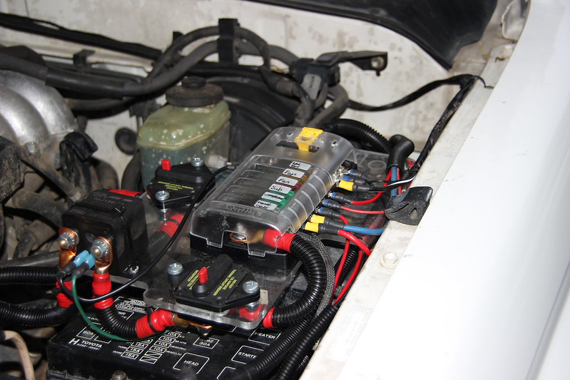

Fuseblock and big 3 mod
It took a long time but its done and I am really happy with the outcome. I started this morning and finished around 5. Big thanks to [MENTION=57546]4-Ripcord[/MENTION] for the wiring diagrams and [MENTION=44220]BigFishAllDay[/MENTION] for his excellent write up on preforming the big 3. I also added a small 400 watt bestek inverter under the driver seat that has constant power to have some 24 hour usb ports and power for charging cameras and what not when I am out camping. Now onto the pictures
Before...
IMG_4409 by Phoenix Black, on Flickr
After...
IMG_4491 by Phoenix Black, on Flickr
IMG_4492 by Phoenix Black, on Flickr

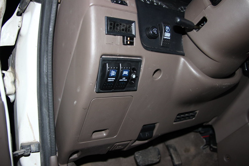

New switches and panel in the dash...
IMG_4495 by Phoenix Black, on Flickr

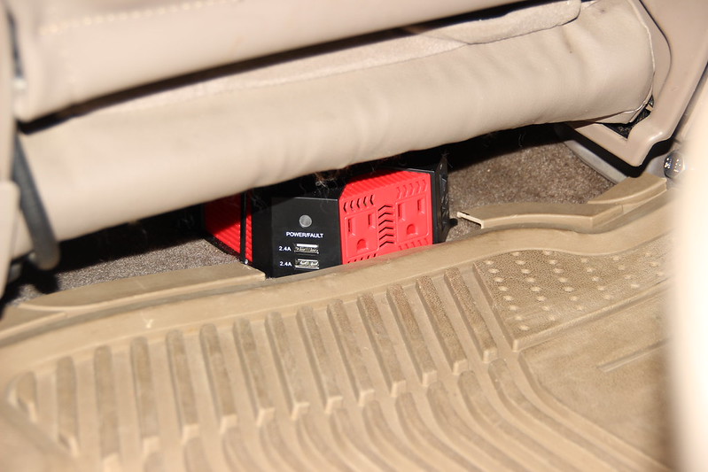

Inverter...
IMG_4489 by Phoenix Black, on Flickr

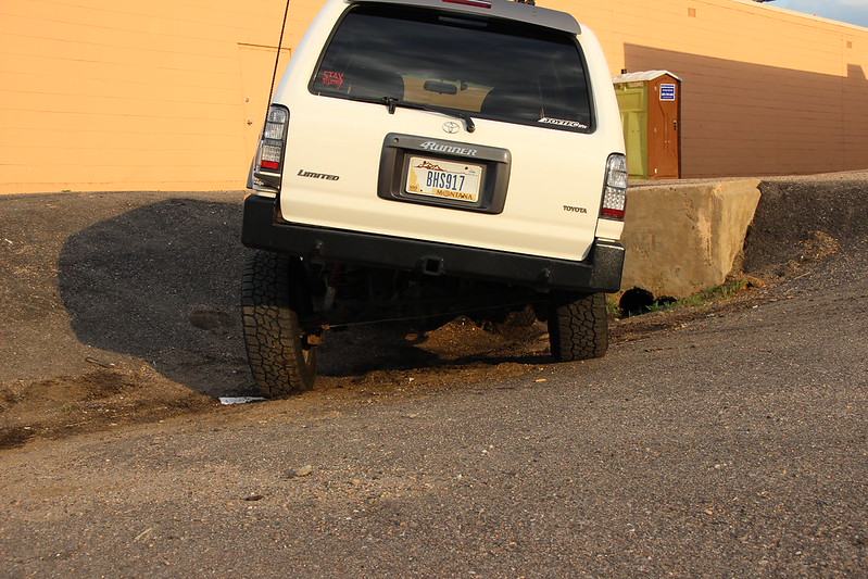

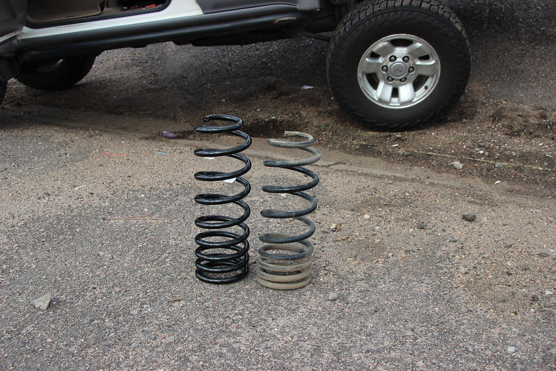

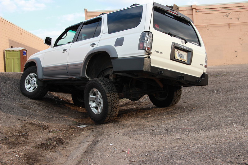

Also picked up a set of OME 891 coils to replace the current 906 coils. I then headed to the nearest king soopers parking lot to swap them out. I ended up taking the shocks loose backing up the hill and then lifting the truck about an inch with the hi lift on the slider.
Before...
IMG_4515 by Phoenix Black, on Flickr
After...
IMG_4536 by Phoenix Black, on Flickr
Old vs New...
IMG_4516 by Phoenix Black, on Flickr
Stretching the new legs...
IMG_4521 by Phoenix Black, on Flickr
IMG_4532 by Phoenix Black, on Flickr
My first impressions with these coils are good. They seem softer when unloaded than the 906s but arent too soft. Body roll increased slightly but I think I can correct that with a panhard bar lift, overall I am happy with the outcome.
Looks good! Glad to see someone paying attention to the panhard thread that went on forever. Or you just understand roll center works. I like the electrical setup you've done. Definitely looking to do the same thing soon.
I did watch that panhard thread for quite a while. I dont fully understand the roll center concept but I have a basic understanding of it and it makes sense. And I know thats why the body roll increased because it was totally fine without the rear sway bar on the old coils and now its feeling a bit more boat like, I could feel the difference within the first 500 feet. The electrical setup is for sure money well spent, its one of my favorite mods to look at on the truck. Makes my OCD happy

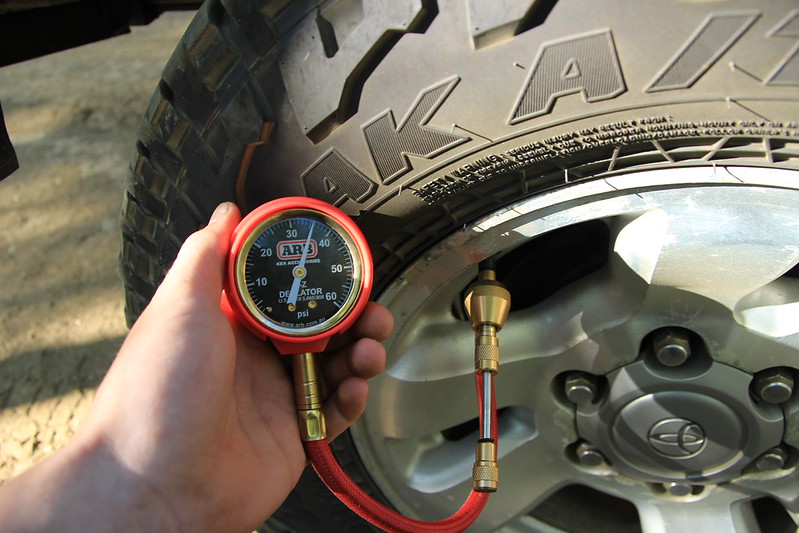

This morning I went on a solo run up Yankee Hill and had a blast. It wasn't a very difficult trail but had a lot of fun areas to play in.
Airing down, I got this thing off ebay for like 50% off and it's great. Makes airing down so fast.
IMG_4592 by Phoenix Black, on Flickr

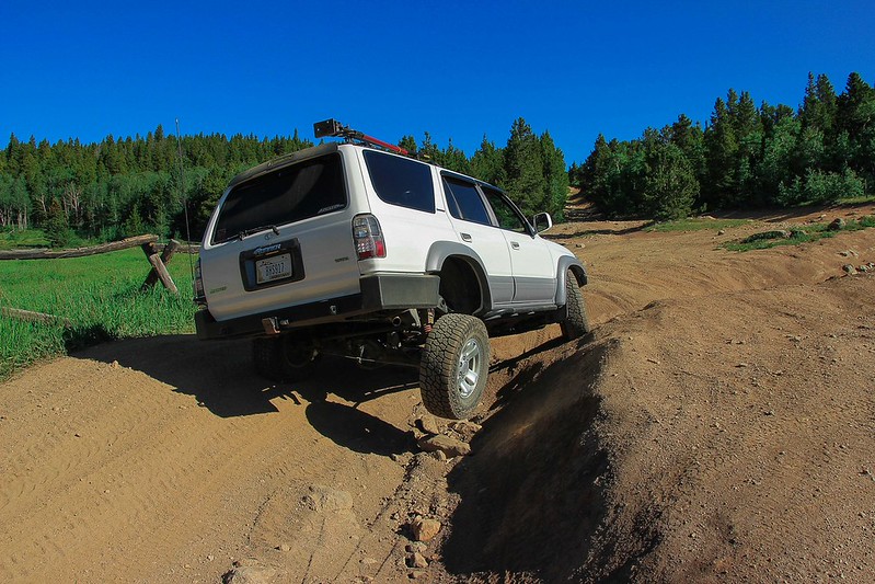

Stretching out the 4runner's legs early in the morning. Im loving these 891 coils more each day.
IMG_4594 by Phoenix Black, on Flickr

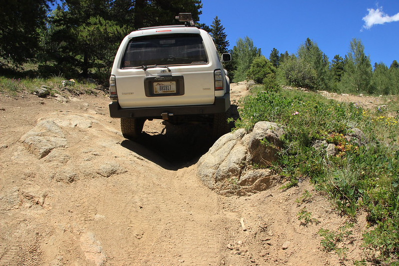

I also let some more slack out into the limit straps to see if I could get a little more droop without binding the cv joints
IMG_4593 by Phoenix Black, on Flickr

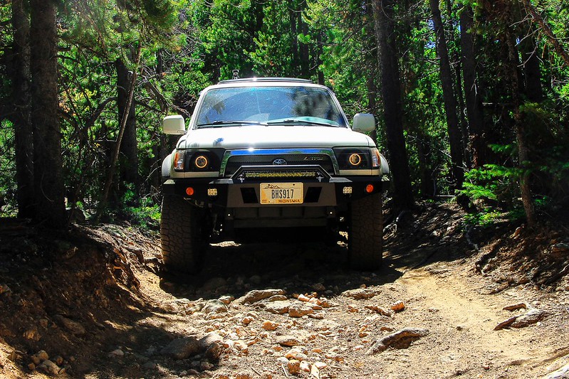

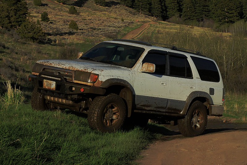

I continued on down into the St Mary's area and decided to head down the road a bit and run Barbour Fork. This was a super tight trail but the last few obstacles I spent some time playing on were a lot of fun and really impressed me as to what the 4runner was capable of.
Creeping through the woods
IMG_4614 by Phoenix Black, on Flickr

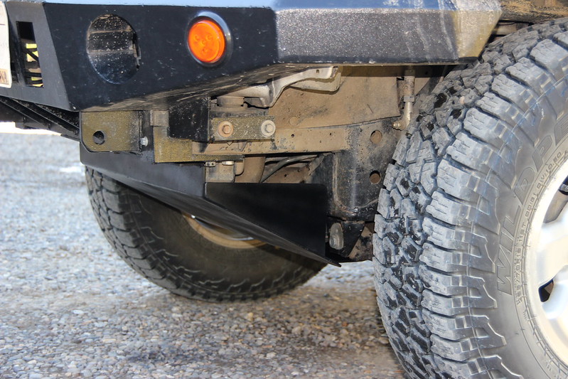

This was my favorite obstacle of the day. The line I took required I go around the rock my passenger rear tire is on with the front, then cut hard passenger and use the slider to push the rear end up onto the rock. Did it all with zero wheelspin.
IMG_4621 by Phoenix Black, on Flickr
Also got to put the skids to the test, they preformed flawlessly. All in all a great day with no body or mechanical damage and I managed to only almost lean the truck over into a tree once.
IMG_4622 by Phoenix Black, on Flickr
