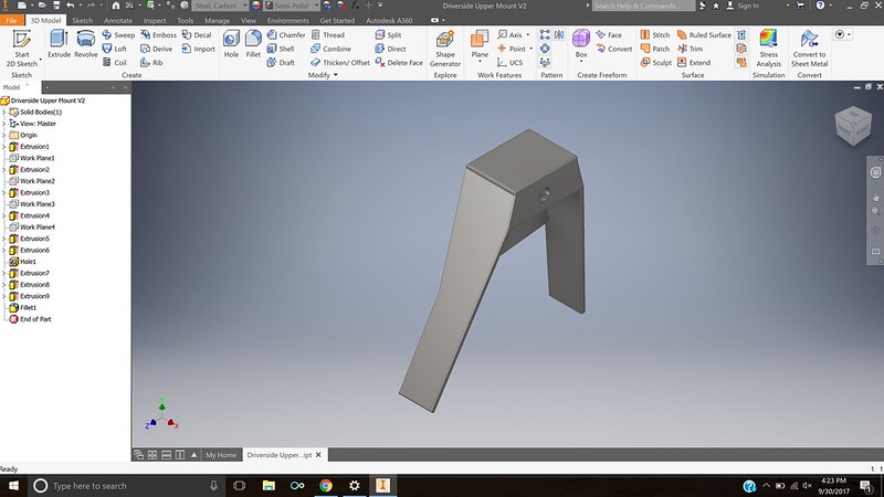

I also finished the first model of the rear shock mounts. Ill be notching the frame by 3/4 of an inch to avoid running wheel spacers with the stock rims. The mounts will then be welded into the frame to hang the shocks
Shock Mount by Phoenix Black, on Flickr
