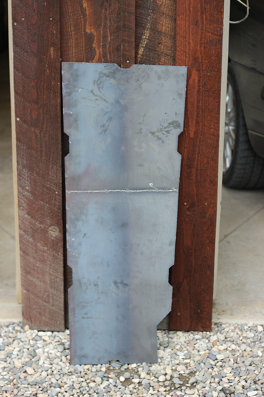

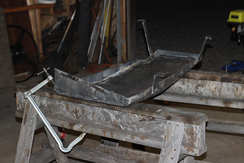

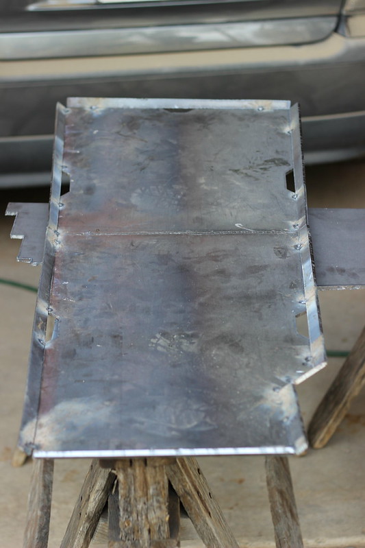

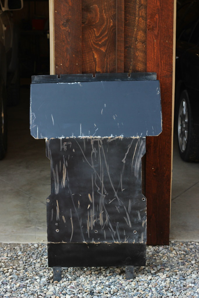

Over the past week I have been working on building the new gas tank skid to solve the issue with the driveshaft contacting the skid and shearing off the slipjoint zerk. I used 3/16 just like the front skids for added strength. I tried to keep it as close to the tank as possible while still leaving some wiggle room. It isnt perfect and Im sure some things will get refined in time but it should do for now.

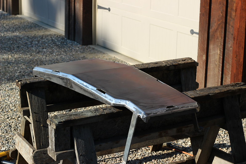

Started by cutting out the base and putting a slight bend in it.
IMG_5462 by Phoenix Black, on Flickr
Then added some small angled sides
IMG_5463 by Phoenix Black, on Flickr
Finished it by adding vertical sides for strength and added the mounting points
IMG_5466 by Phoenix Black, on Flickr
IMG_5474 by Phoenix Black, on Flickr

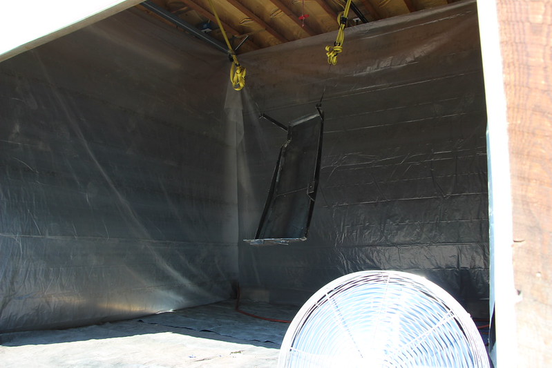

My make shift paint booth
IMG_5477 by Phoenix Black, on Flickr

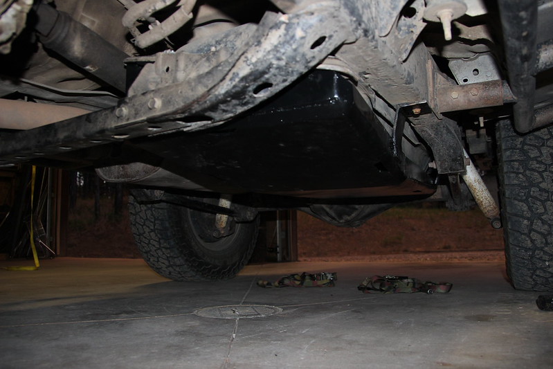

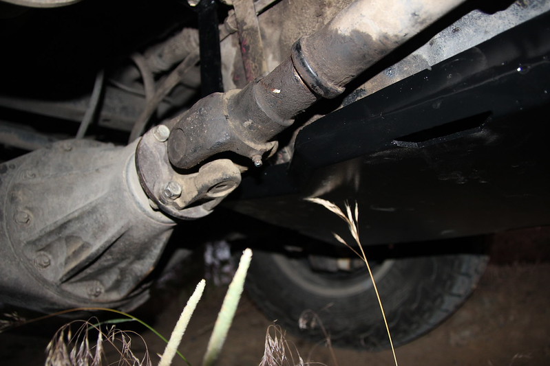

Installed
IMG_5494 by Phoenix Black, on Flickr

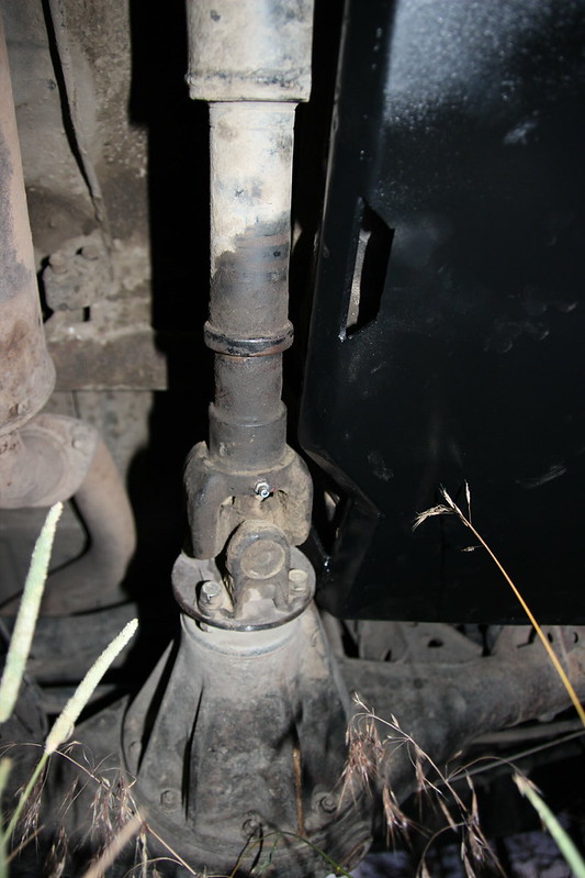

Finally have some clearance at the driveshaft. This was at full flex with the driverside stuffed. I think I may replace the zerk with a panhead bolt just to make it smoother and only reinstall the zerk to grease it.
IMG_5499 by Phoenix Black, on Flickr
IMG_5500 by Phoenix Black, on Flickr

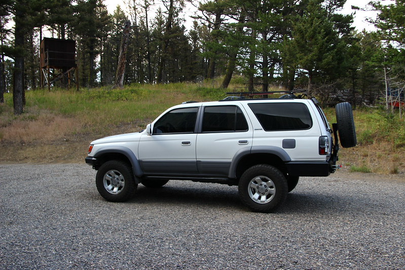

Also gave the 4runner a quick wash, Im loving the stance and look it has now.
IMG_5489 by Phoenix Black, on Flickr

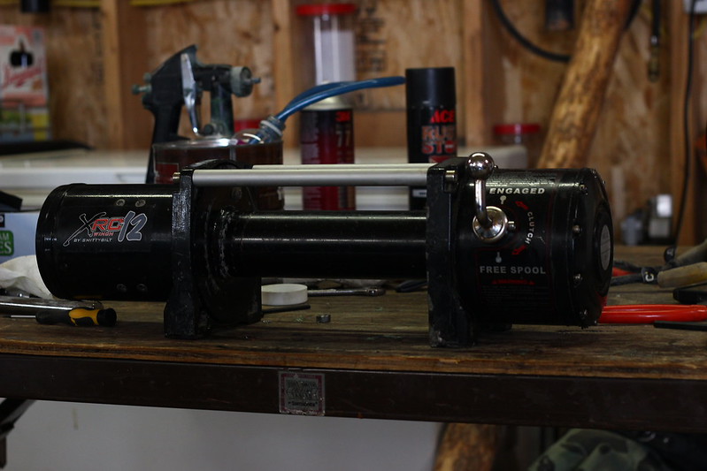

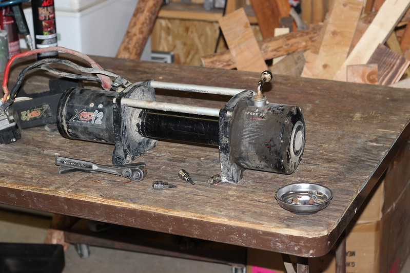

The winch with cable removed before I started the tear down.
IMG_5506 by Phoenix Black, on Flickr

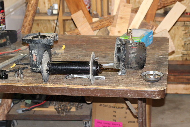

Cross bars, motor, and gear box separated...
IMG_5509 by Phoenix Black, on Flickr

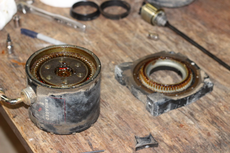

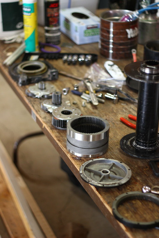

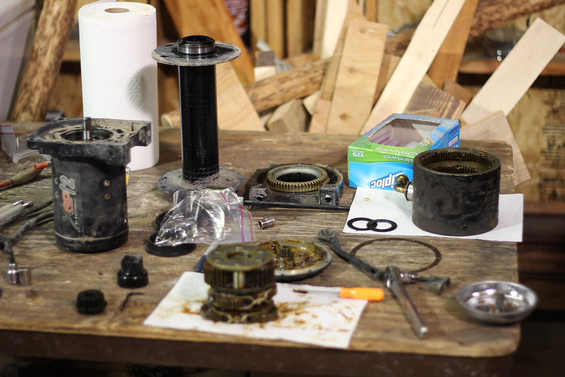

Next I began to disassemble the gear box, scraping off gobs of thick sticky grease as I went.
IMG_5514 by Phoenix Black, on Flickr
IMG_5517 by Phoenix Black, on Flickr

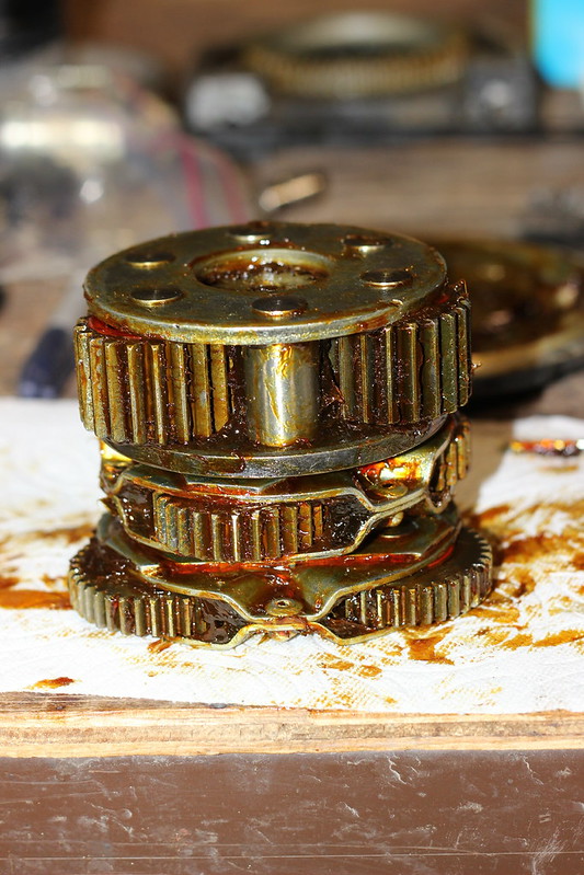

Planetary gear set...
IMG_5518 by Phoenix Black, on Flickr

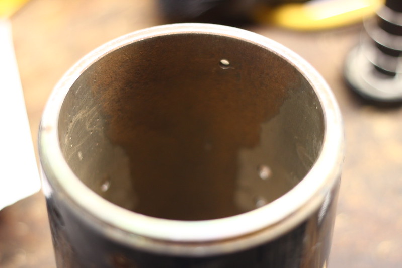

After the gear disassembly I needed a break from the mess so I pulled the motor apart, inspected it, cleaned up some corrosion in the housing, and reassembled it making sure to waterproof all the wiring terminals and case joints with RTV. I also split the solenoid apart and sealed it up with RTV.
Inside of the motor case after removing corrosion...

Then it was back to degreasing. I picked up a gallon of purple power from autozone and used almost all of it but was surprised at how well the stuff broke the grease down.
After six hours of scrubbing, scraping, soaking, and wiping...
IMG_5581 by Phoenix Black, on Flickr

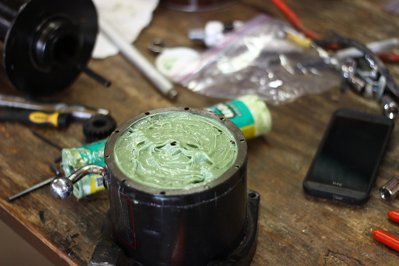

I then repacked all the gears and the box and reassembled it sealing all the joints with RTV. This was the messiest part and I only got one picture.
Freshly packed and ready for service...
IMG_5587 by Phoenix Black, on Flickr

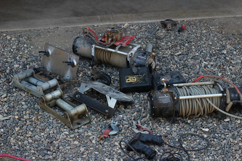

After finishing this I went to get the XRC8 ready to resell, out of curiosity I tried freespooling it and was barley able to because the grease was so sticky. On the XRC 12 I can now spin the drum with one hand.

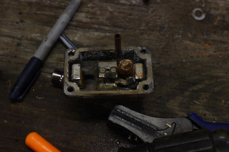

Unfortunately the XRC 8 solenoid leaked and it froze up completely so I hooked it up with the other solenoid and was able to make it run so I will be selling it without a solenoid. Oh well.
In side of the solenoid...
IMG_5597 by Phoenix Black, on Flickr

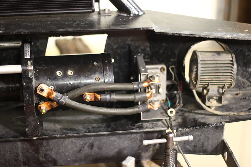

I got the electrical side of the winch completed and installed in the bumper this weekend. I did my best to upgrade everything I could to make it reliable and get the most performance.

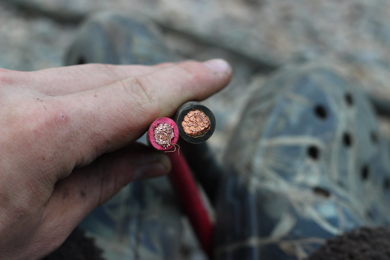

I opted to replace all the cables that carry the 300 plus amps that the winch draws at full pull because the guy who I bought the winch from did a poor job installing it so the cables had begun corroding inside the insulator for the entire length of the cable. Rather than buy new 2 gauge I decided to use the 1 gauge 600v flexaprene welding cable I had left over from a past project. It's a very high quality wire and should be more than overkill for this application.
Original 2 gauge on the left, new stuff on the right. and yes I am wearing crocs, theyre my go to wrenching shoes

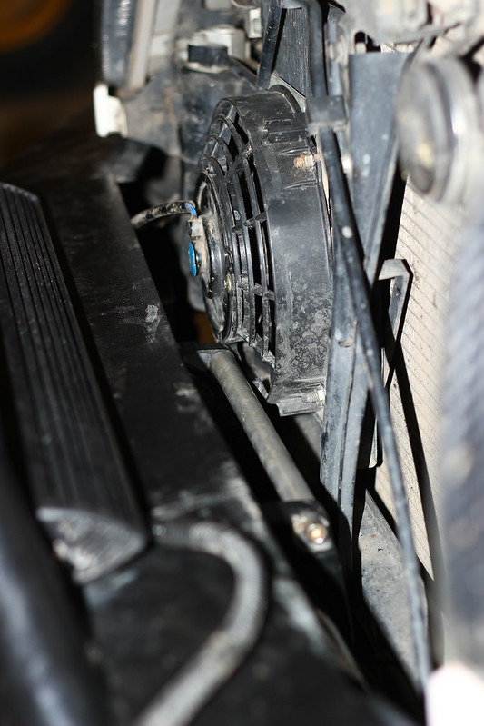

Before I could start on the wiring though I needed to make sure the winch was actually going to fit in the bumper. I ended up having to tweak the transmission fan location, clearance the fan guard slightly, and enlarge the access holes in the front of the bumper but nothing too major.
Clearance between the fan and winch, it's really tight...

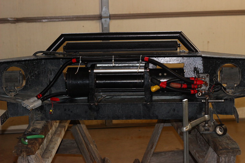

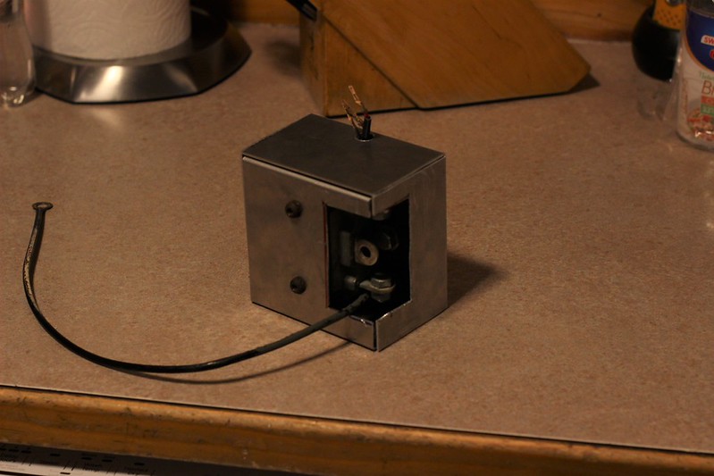

I then bolted the winch in and decided where I wanted to mount the solenoid. I decided on going right next to the passenger fog lamp but I needed a new solenoid box to mount it how I wanted. So I headed to the scap bin at work and sheared and bent up a quick box out of .063 aluminium.
IMG_5612 by Phoenix Black, on Flickr

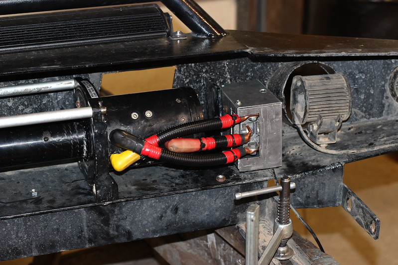

With the solenoid mounted and winch having a home secured in the bumper I started working on the wiring. First I made the short wires that go from the solenoid to the winch for the in and out controls. I followed the same process for all the connections, solder, punch set , shrink tube, electric tape, loom, one more layer of tape for color coding, and then a small zip tie to prevent the tape from unraveling
IMG_5621 by Phoenix Black, on Flickr
All wrapped in loom, color coded for positive, and I was still able to use the original terminal covers.
IMG_5627 by Phoenix Black, on Flickr

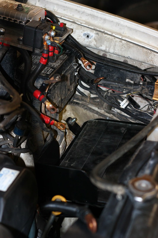

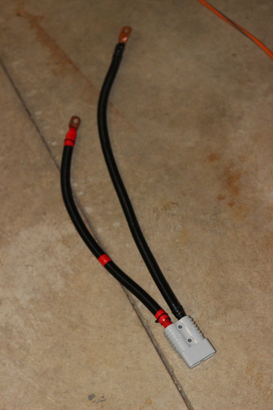

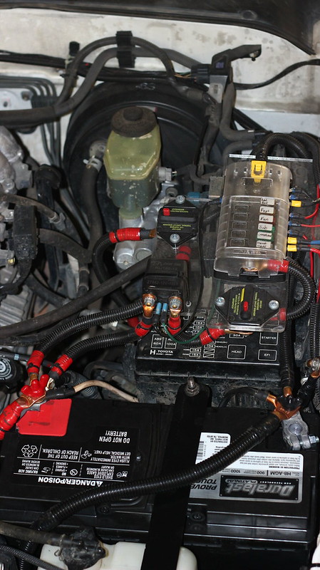

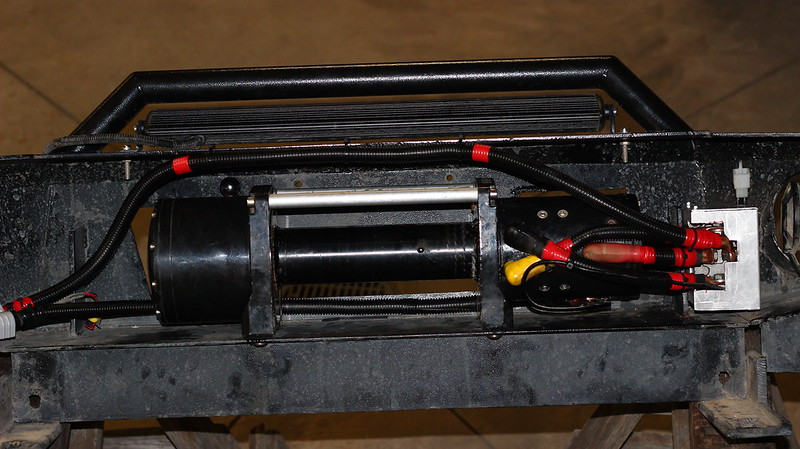

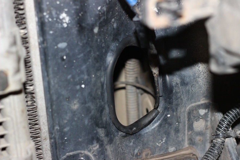

I then made the main positive and negative wires that run to the battery. I terminated them at the core support with an Anderson Power Products quick connector to make removing the bumper in the future easier.
IMG_5631 by Phoenix Black, on Flickr
Test fitting everything...
IMG_5629 by Phoenix Black, on Flickr
I also wrapped the hole in the core support with some rubber hose to add another layer of abrasion resistance.
IMG_5632 by Phoenix Black, on Flickr
I then did the final assembly making sure to give all the connectors a good coating of dielectric grease to prevent corrosion.
IMG_5634 by Phoenix Black, on Flickr

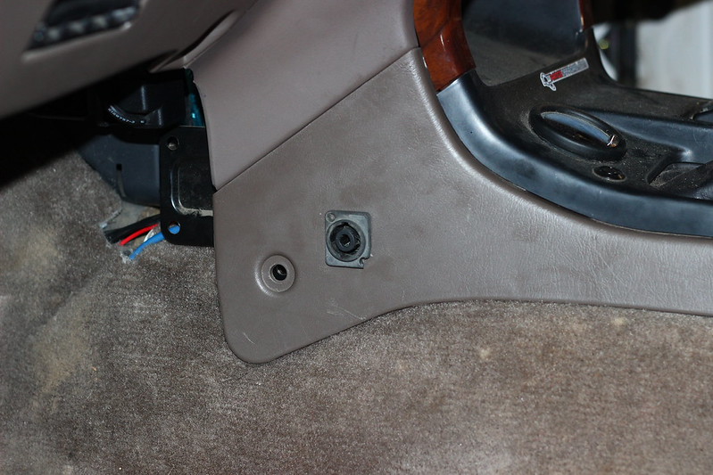

Lastly I ran the original remote connector into the cab giving me both in cab controls and out of the cab controls when needed. The winch runs like new and the added wiring from the big three really helps the alternator try and keep up, emphasis on the try. I think I am going to add a big deep cycle battery though to make the electrical a little more stable. Im looking at this one
IMG_5637 by Phoenix Black, on Flickr

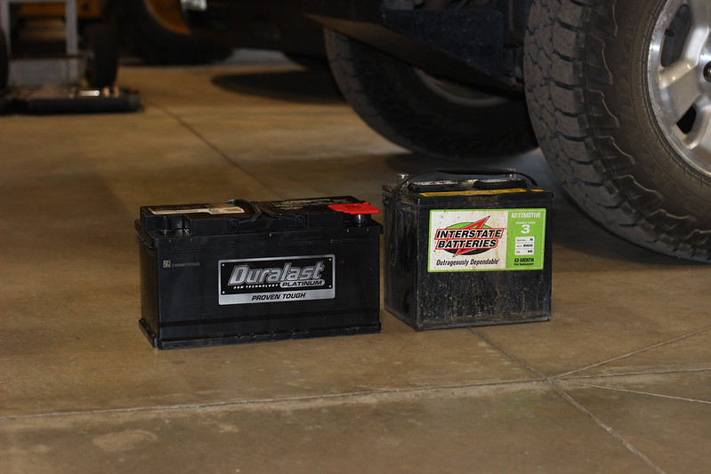

So I got a new battery, a big one, I got the new one because my one year old battery I had was already leaking from the lids and it was a little small to be running a winch off of. I decided on getting the Duralast Platinum AGM battery in the H8 group 49 variety because the price difference between this and the next size down was basically nothing, bigger is always better right? and I can get it replaced basically anywhere in the country. Its the same one [MENTION=67615]Dirtco[/MENTION] is running in his 99.
Heres the specs:
Stock:
CCA: 640
CA @32 degrees: 800
RC: 100
H8 AGM:
CCA: 900
CA @ 32 degrees: 1000
RC: 160
So it is a lot more powerful and wont leak but the downside is its a lot bigger so its a tight fit and I had to make a new tray for it but otherwise it went in nicely.
New VS Old...
IMG_5653 by Phoenix Black, on Flickr

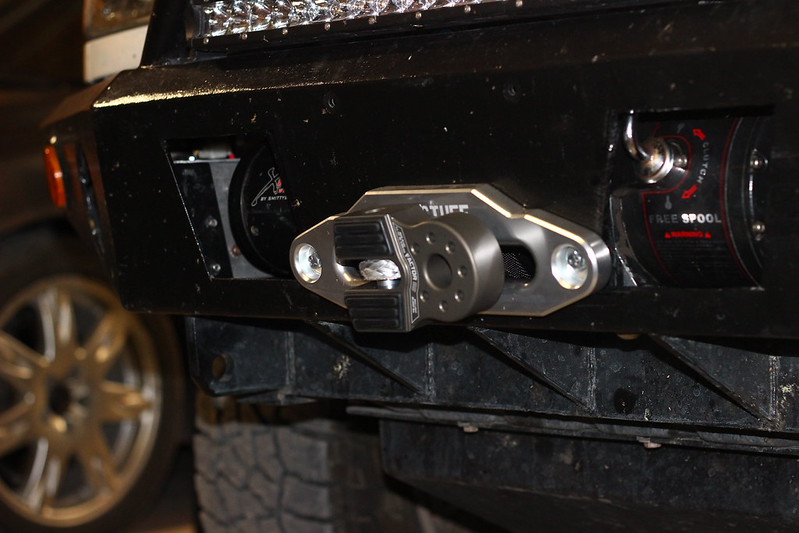

The winch line also showed up unexpectedly along with the Factor 55 Flatlink so I got those installed and was pleasantly surprised that when running the winch line on the voltage never went below 12.2 volts and the motor hardly got warm. Now I know it by no means had a heavy load on it but its a good sign that the electrical system is up to snuff. I also tried out the free spool and it is straight butter. So glad I changed out the grease.
IMG_5648 by Phoenix Black, on Flickr

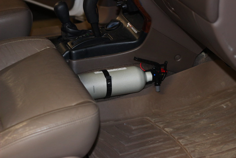

Also installed a fire extinguisher in the passenger foot well just for safety and a bit of cheap insurance should something ever happen.
IMG_5651 by Phoenix Black, on Flickr
Thats all for now but there are a few big things in the works right now so stay tuned for that.
Nice electrical upgrades. What did you use to mount your fire extinguisher? How is it secured to your truck? This is on my to-do list for this week hopefully.
I got a kiddie automotive fire extinguisher so it came with a plastic bracket and I just took some 1 1/2 self tapping screws and ran them into the transmission tunnel. So far its really solid but if it starts moving around Ill just swap the screws for some bolts but I dont see the need right now.
