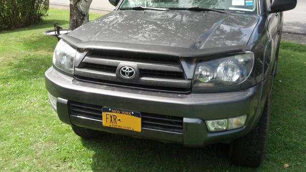

Blacked out Headlights 06' Sport DIY
Very nice write up! I got the same color truck but my headlights are different. I don't think anyone has blacked out the 2004 sr5 lights. Also does it seal back up well? I'd be worried about moisture getting back in. I like your plasti dipped emblems and grille!
should be the same as your headlights

Can I just spray over the chrome. Is sanding the chrome a must? I'm wanting to do this mod on Saturday And I'm just worried about the oven part. Mainly the putting back together. If I put it back in the oven and then hold it down with clamps will that work?
Thanks in advance
Thanks in advance
Scuff the chrome with some 600. Don't be lazy
The oven part was scary for me too. I didnt have the money to get new headlights if I broke these but I jumped into it. Followed the instructions and bam to this day no issues just perdy
I used easy off oven cleaner that someone else recommended and I didnt have to sand a thing. Gives you a nice clean surface for the paint to stick! Just spray on and watch while you drink a beer..
Heading over to lowes tomorrow to pick up the paint and sandpaper and doing a late night attempt at it. What's the best black paint to use. And should i also use a clear coat of something afterwards?
