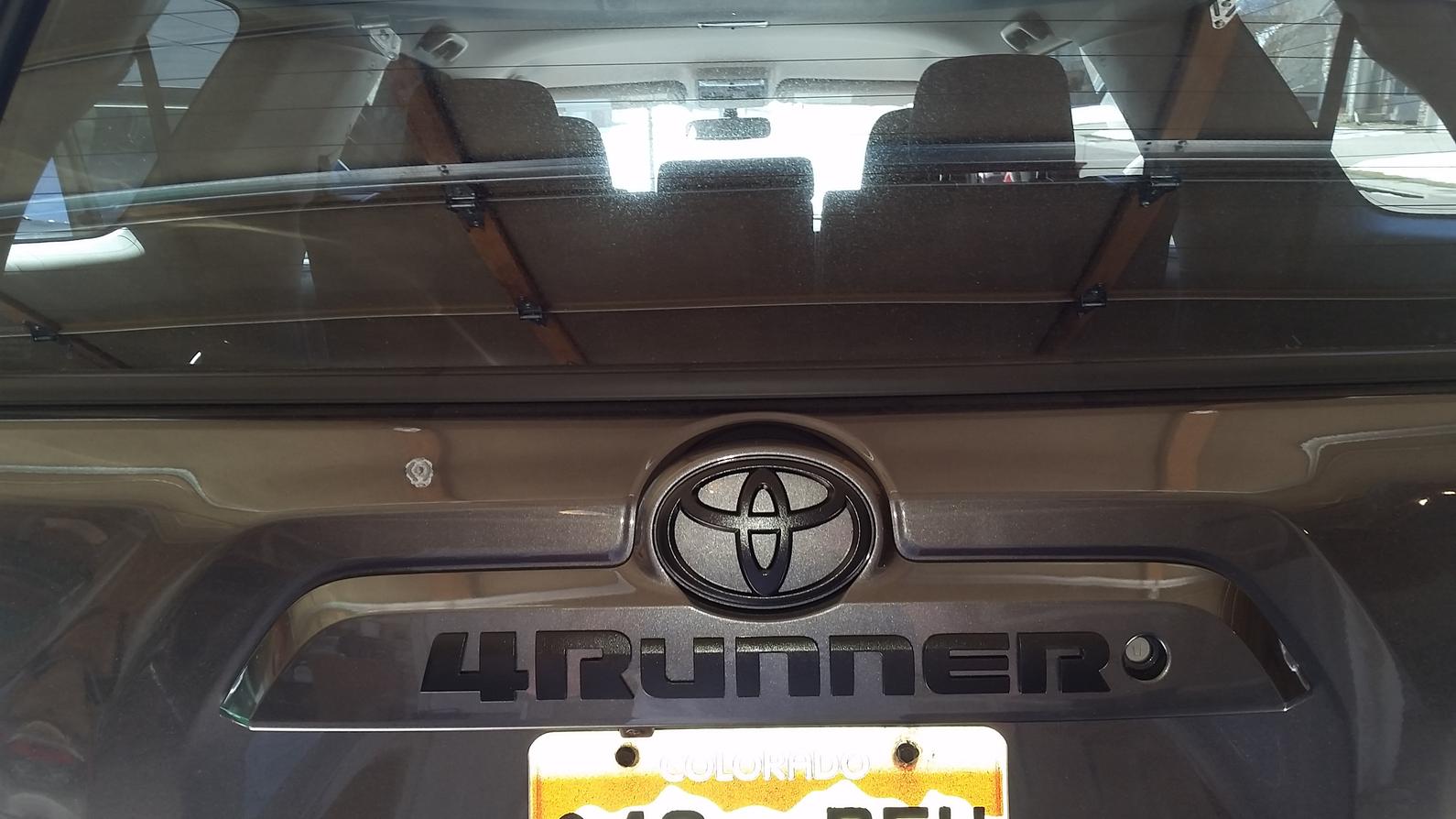

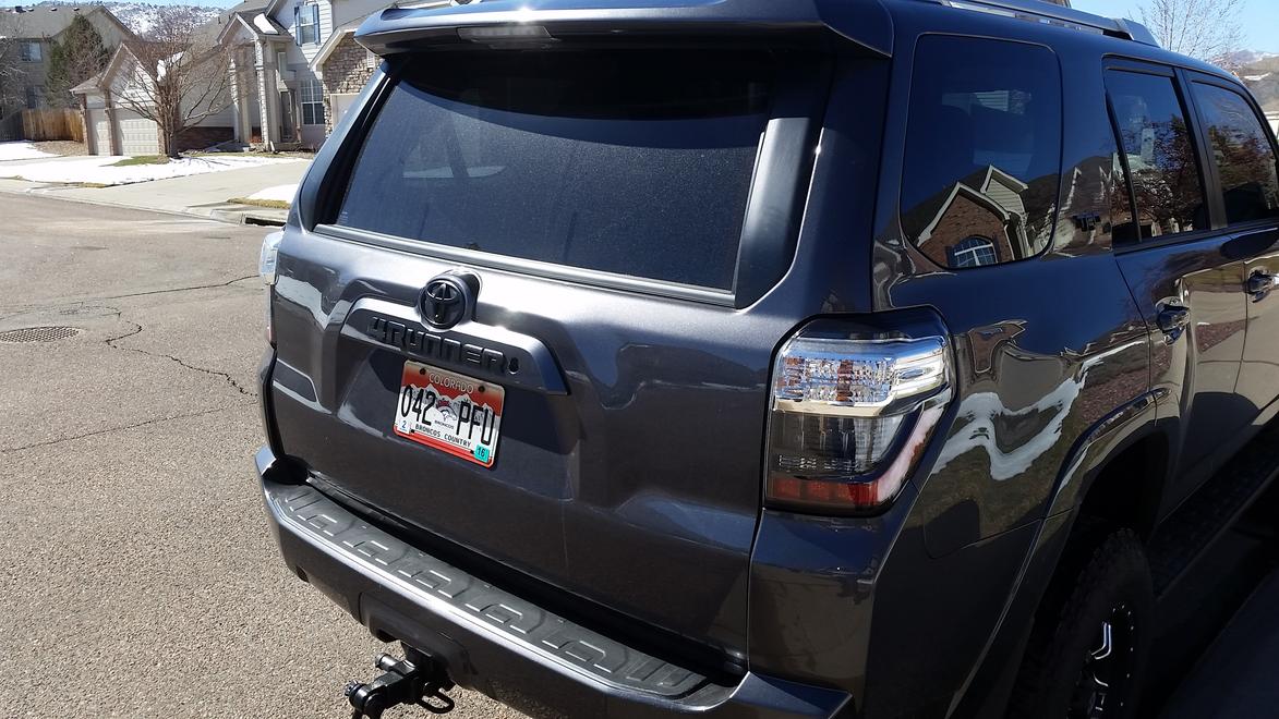

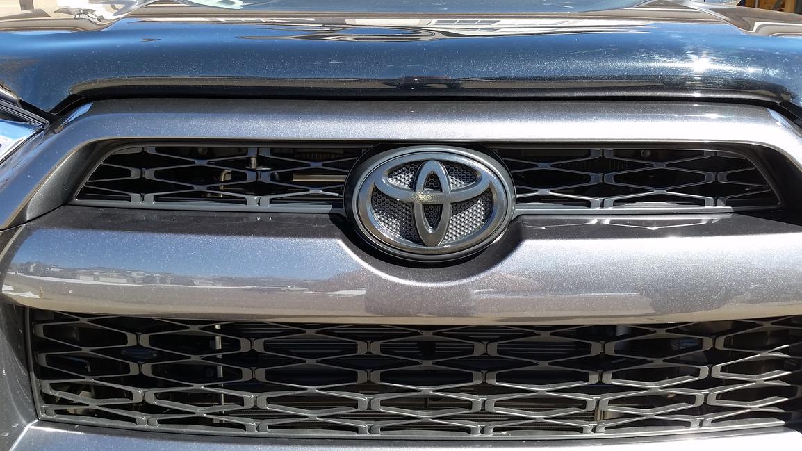

I plasti dipped mine today! I also used a couple coats of the plasti dig gloss coating for a slight sheen and UV protection. Came out AWESOME!
Bro that is a clean job!!! I just dipped my rear emblems couple hours ago and I didn't get the end result that I was hoping for. Did about 5 coats with 10minute intervals and i don't think I applied enough dip during my coats (even my wife was nagging saying I didnt.) so when I tried to peel off excess, it didn't come off too clean. Got dip stuck in between letters and such. Just wondering your process on how you did yours?? Any feedback would be amazing!
Thanks man! I did 4 light coats and 15 min between them and 2 light coats of the Plasti Dip Glossifier which adds a bit of a sheen and UV protection so it doesn't fade and IMO looks better and more of a finished look. I also used and exacto knife and lightly cut closely to the letters and emblems so the dip was easly removed with crisp lines. I did remove the front emblem from the truck cuz that was easy.
