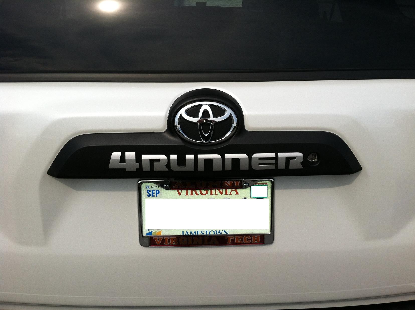

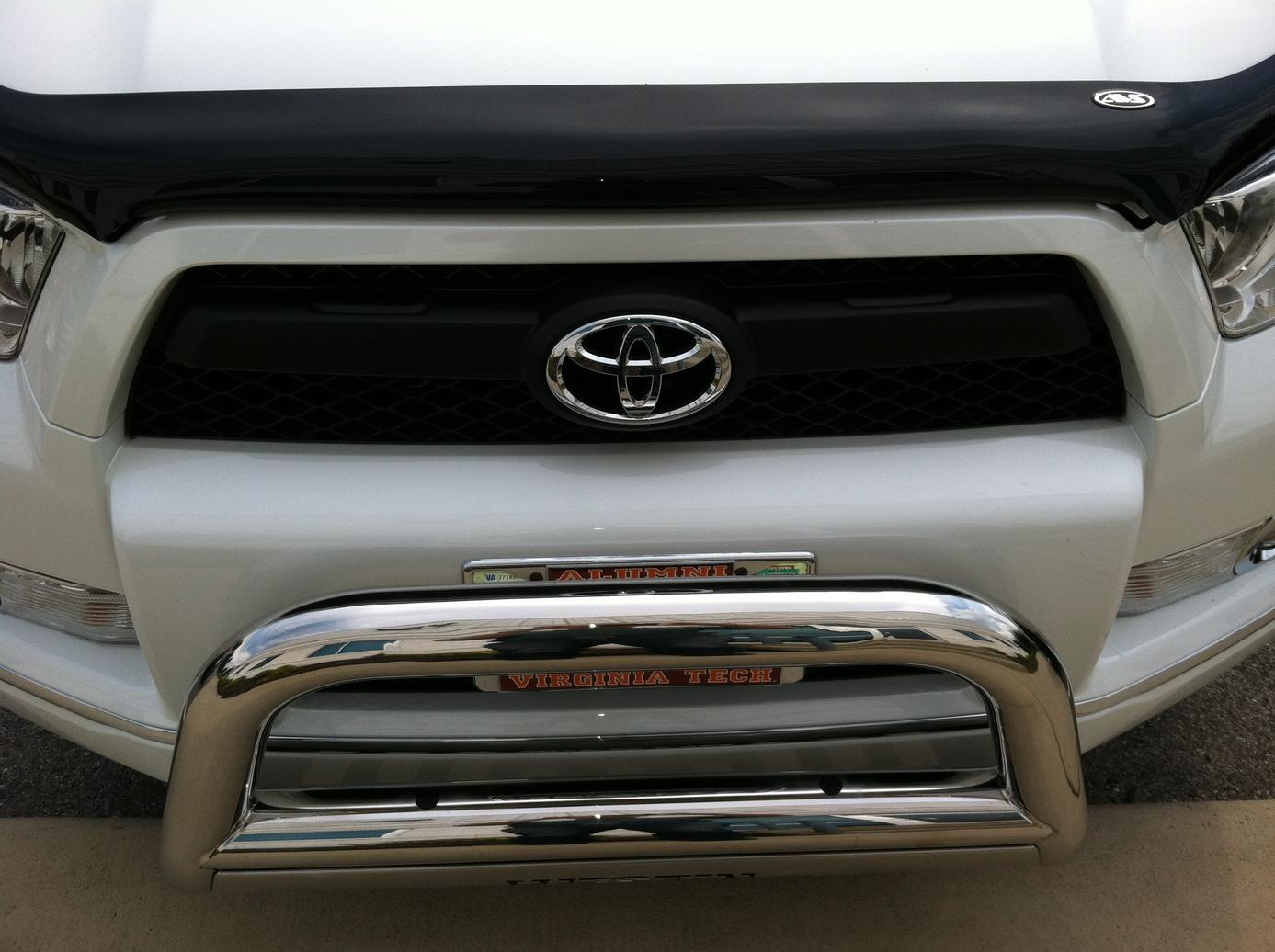

Plasti-Dip Succesful
Took the plunge with Plasti-Dip. Love how it turned out. Ran out of time on Saturday during my 2 year olds naptime, but I got 3 more cans in the garage! Chrome strips are next...maybe a TE conversion w/ Plasti-Dip.
