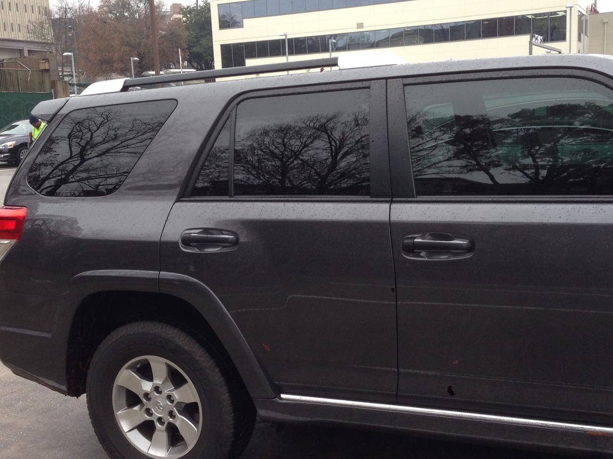

Plastidipped all the emblems on my '12 trail and something didn't feel right everytime I drove so finally git rid if the smallest chrome emblem ! same procedure as before except took a sewing needle to carefully break the plastidip in the emblem to tear and remove !

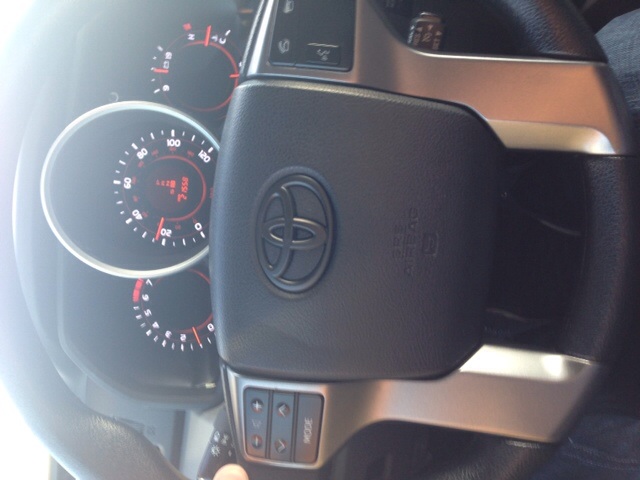

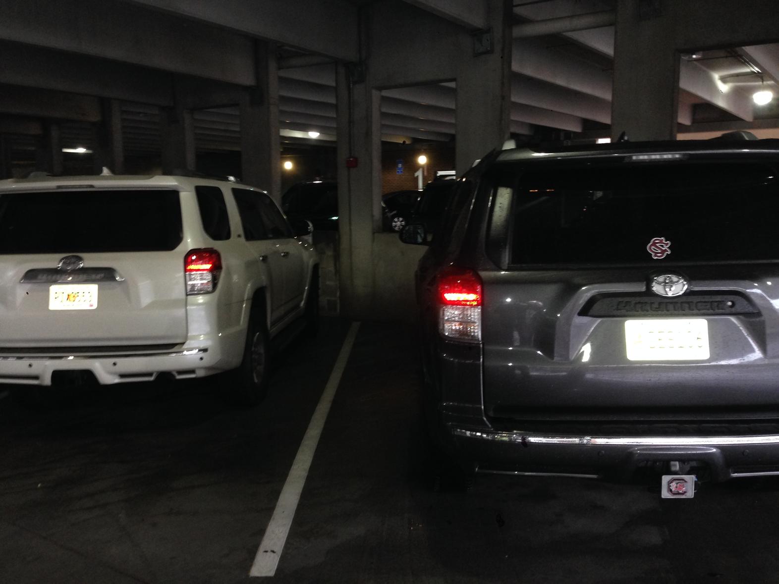

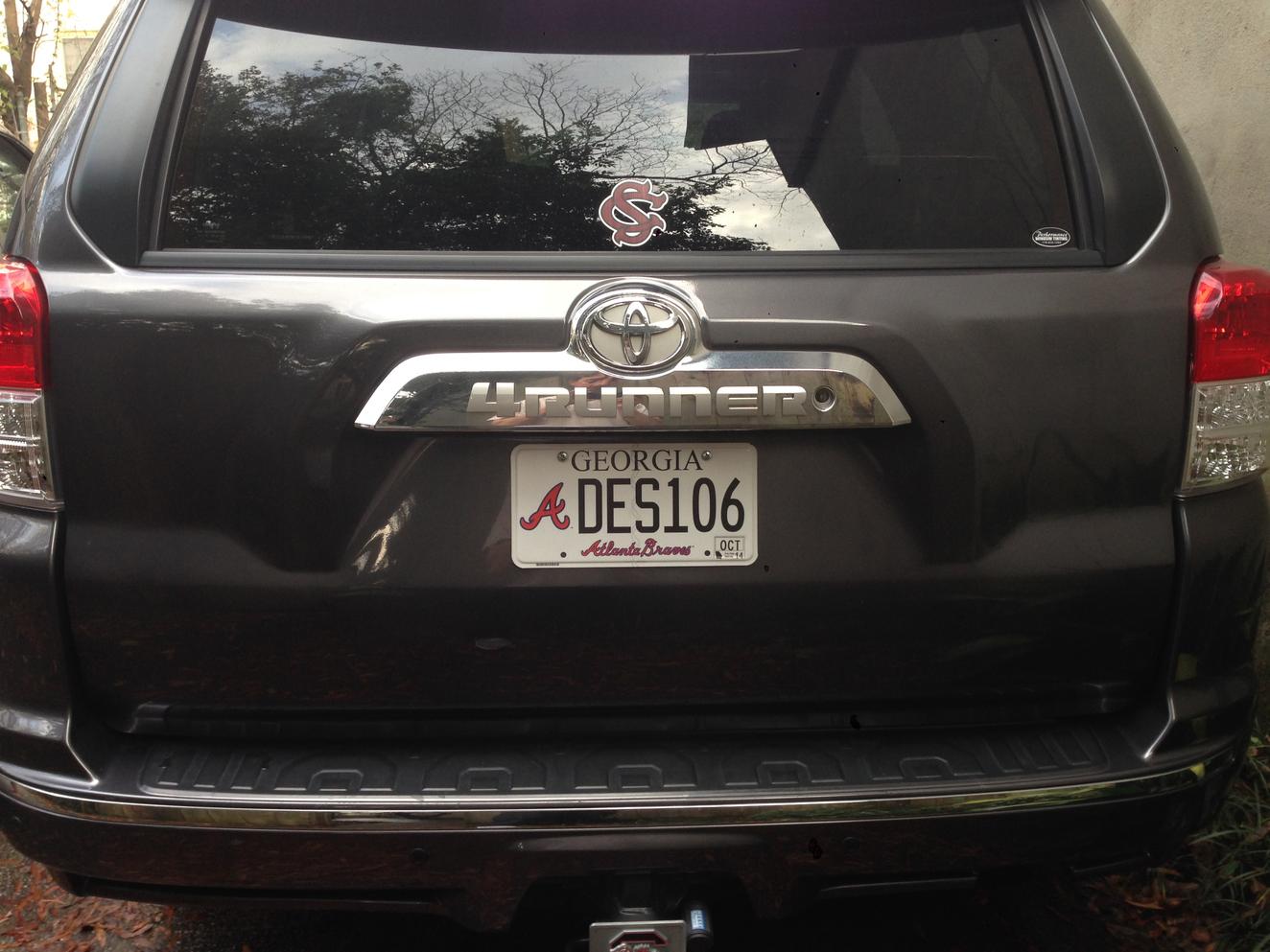

As a lot have posted as well I am not a huge chrome fan. Starting painting these last week. Going to go ahead and paint the end caps on the roof rails tomorrow. Can't quite get the feel for the two tone. Anyway its been done many times on here but wanted to share my pics.
