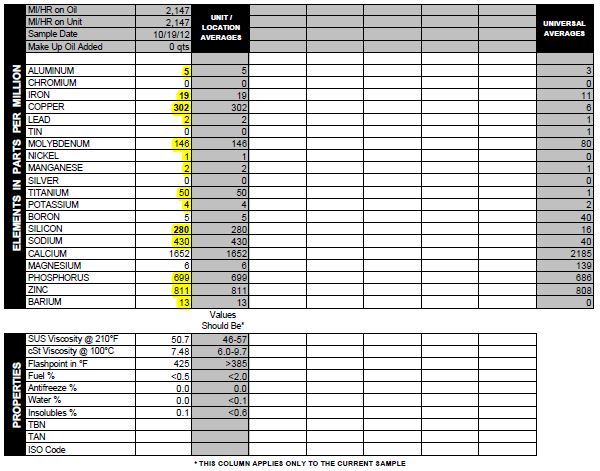

Since the 4Runner was new I decided to change the oil at 2000 miles and will change again at 5000 miles. The first 5000 miles will be where most of the wear occurs. After the 5000 mile oil change I will change again at 10,000 and see how it looks.
As you can see from the Blackstone Lab report it shows a lot of wear metal as to be expected. Which is the main reason I changed it at 2000 miles.

Blackstone and the folks at Bob is the Oil Guy have a lot of documentation on this. It tells you a great deal about how your oil, your engine, and and your fuel interact.
For instance:
1. If silicon is detected in the oil, you probably have either a vacuum leak somewhere or your air filter isn't seated right. You'll see higher levels of wear in other metals too, since silicon particles are abrasive.
Result: You realize there is an issue with a loose vacuum hose or your filters before it can increase long-term wear in your engine.
2. If a lot of sulphur is detected, you might be running fuel with enough impurities in it to overwhelm the protection package in the oil you're using. Since compounds of sulphur tend to be corrosive, you'll either want to evaluate a different fuel or shorten the OCI. LPG and CNG engines get this, as do some types of diesel engines. Some gasolines also have higher sulphur content.
Result: longer engine life
3. The total base number is lower than expected. You're either running the oil in question too long, too hot, or you have blowby that's causing fuel to accumulate in the oil, thinning it.
Result: Now you can talk about perhaps switching to a thicker oil.

Very good! Also it will show trace amounts of water or antifreeze if you are having problems.
I actually don't like your silicon count, at all. It's possible that the OEM oil had some sort of silicate compound in it, or some dissolved sealant, but if your next change throws that number I'd be undertaking a really intensive audit of your vacuum hoses and post-air-filter intake.
