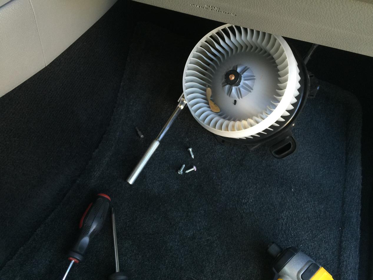

I just changed the cabin air filter and found many leaves stuck in the filter and several that had gotten past the filter into the fan. I recommend you pull the filter and take a look into the fan, which is just below the filter and easily accessed once the filter is pulled out. It will take less than 5 minutes and is worth a look for any foreign objects stuck in there.

Somewhere on here there is a picture someone posted of them using a little dental mirror to find a leaf that was stuck on the top of the blower motor housing.

This was much cheaper than expected. Motor not going out. A leaf was in the blower making that noise. 15 minutes spent. I wonder what a shop would have charged me?
