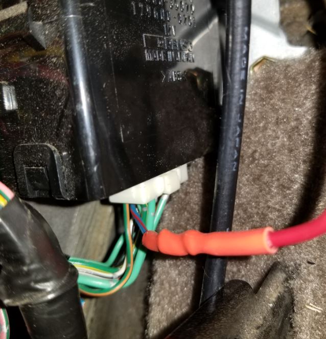

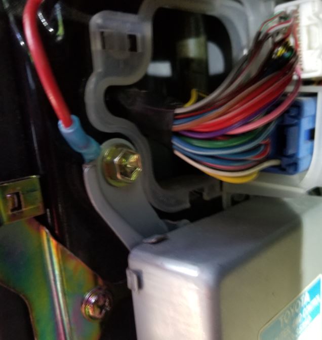

Mine doesn't seem to work.
I followed the directions to a T. Did I miss something?
yep one of my favorite early mods.
wrong color wire, supposed to be blue or gray :) Otherwise looks good.
However, I myself would never use red for a ground. Red is usually. a power source
Black, brown or green are the most common manufacturer grounds.
But it s your car and you know its a ground and thats all that really matters
enjoy the mod

Sorry, I should have written that out more clearly. It doesn't seem to work in any gearing, 2H, 4H, or 4L. I tested it before I bought it and I could hear the actuator engage in 4L. Now, I seem to have screwed it up altogether.
I couldn't find my spool of black wire and happened to have a red wire that was already cut to the right length. I found the spool of black right after I finished. The truck itself is probably scoffing at the color choice though. She's an earth tone type. The red is too bright for her style.
Did you figure out the issue? Are you sure it has a good ground that brkt looks painted.
