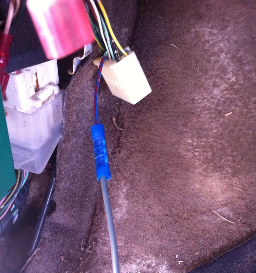

Ok so I was reading up on the blue wire diff lock mod and I am a little co fused on which end of the wire I'm grounding. The end coming from the harness? Or the end coming from the plug? Just need some clarification. Thanks

image.jpg was actually the first mod I've done on my runner, spliced the blue and red wire coming from the harness and just ground it out, I used a grey wire since I originally found this mod on a Tacoma forum lol

Yes ground the end from the plug!
And just for giggles I capped the other side of the cut wire.
