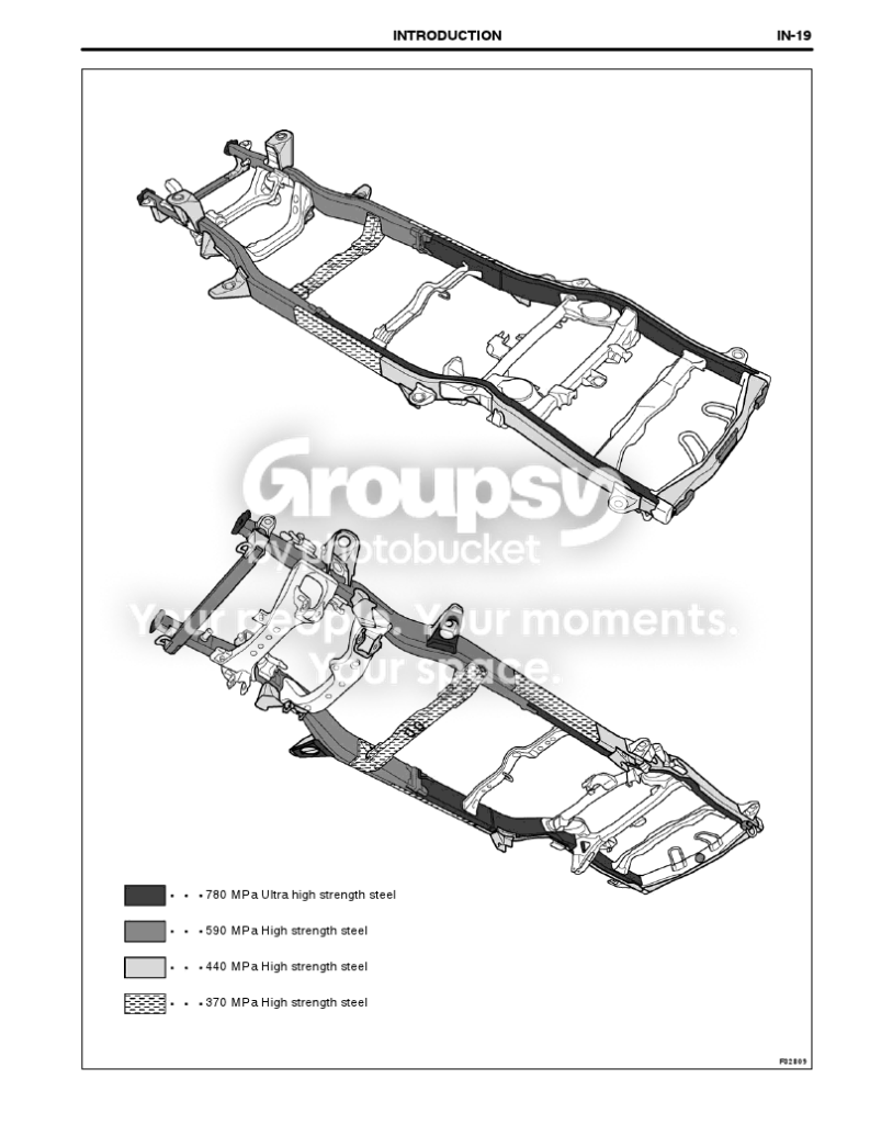

frame.png~original
Harper I realize this is an extremely old post but I am curious where you found this picture? I've been looking for this type of information for the 5th Gen and possibly the 4th Gen as well.
Post Note-
Found it in the Collision Repair manual for the 5th gen, unfortunately it does not appear under 4th gen's collision repair manual.
