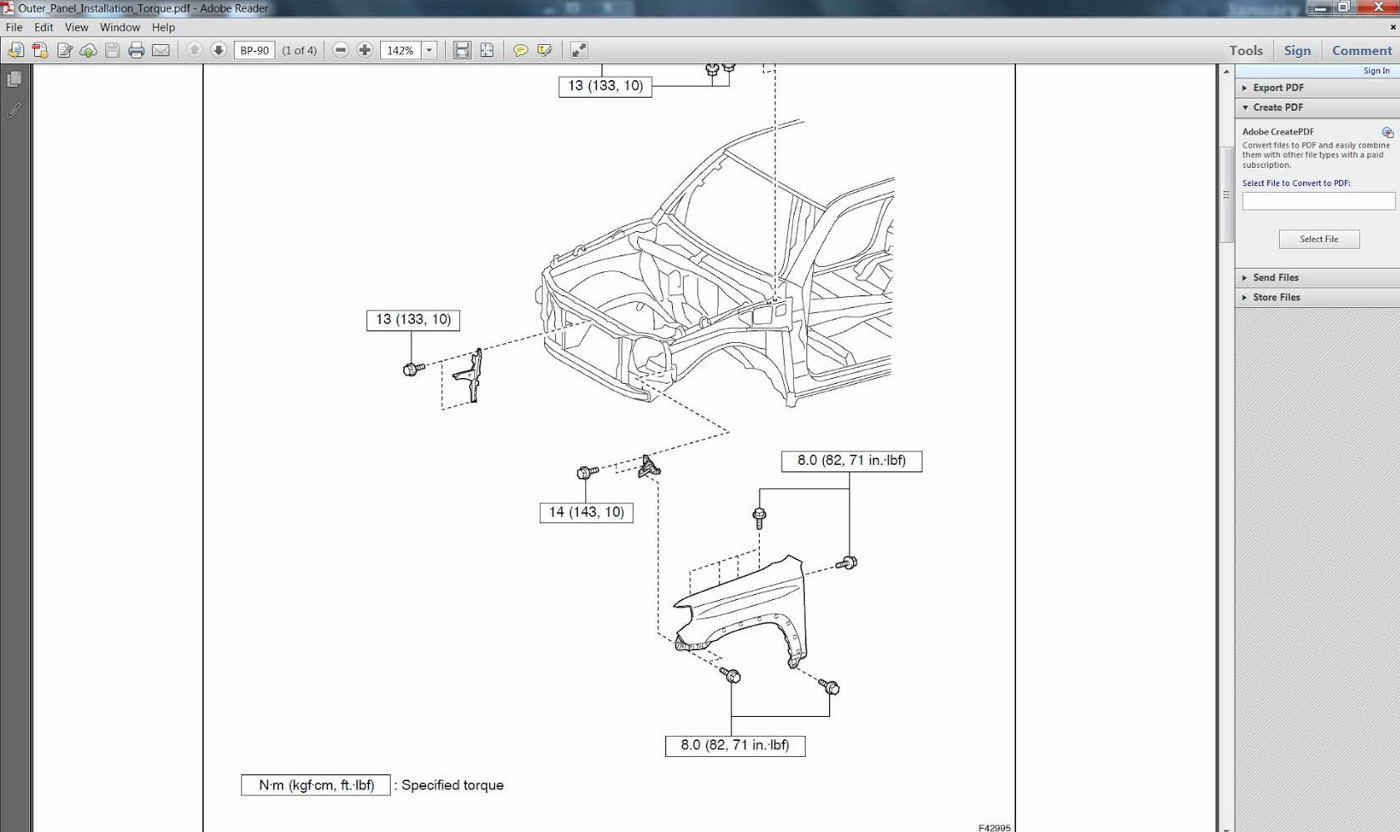

Has anyone taken off any body sheet metal? I have taken the front bumper off but I am looking more at the front wheel well/front side quarter panel. I know there is the Service Manual and in there is the Repair Manual but neither cover where the bolts are located for removing these pieces, the Repair Manual is for welding and true body work.
I'm trying to get the passenger side front wheel well off to do some modding and service to the antenna. I tried to do it via taking out the wheel well liner but I cant get up there far enough to work comfortably and would rather take the whole thing off and put it on a work bench.
Thanks for any insight.

There is a bunch of things you have to take off first to get to these 8 bolts of course but this is the only thing I could find on the front fenders......

Yeah, that's the one I found. Didn't know if any "bumper makers" or body guys had actually stripped it down that far. Looks like it's gonna be a fun weekend!
