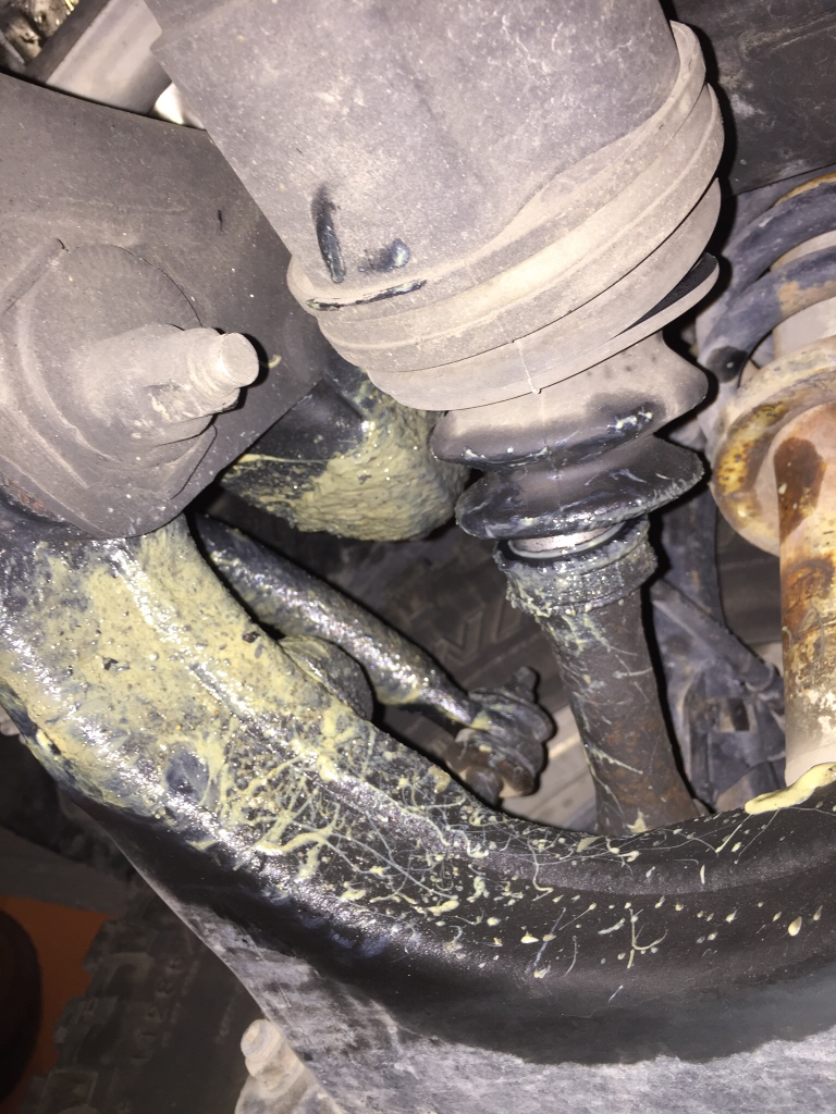

Took a look underneath and found this mess. Too late to fix or does it need replacement? If replacement, OEM or do you recommend another brand.
It needs rebooted. But u need longer boots or stretch them or they will keep failing due to your lift.
Thanks! Safe to drive for two more weeks till the parts come in?
Yes. Just avoid mud and water so it stays clean inside.
Ive been driving on torn boots for 5 years I would say. So far no failures.
