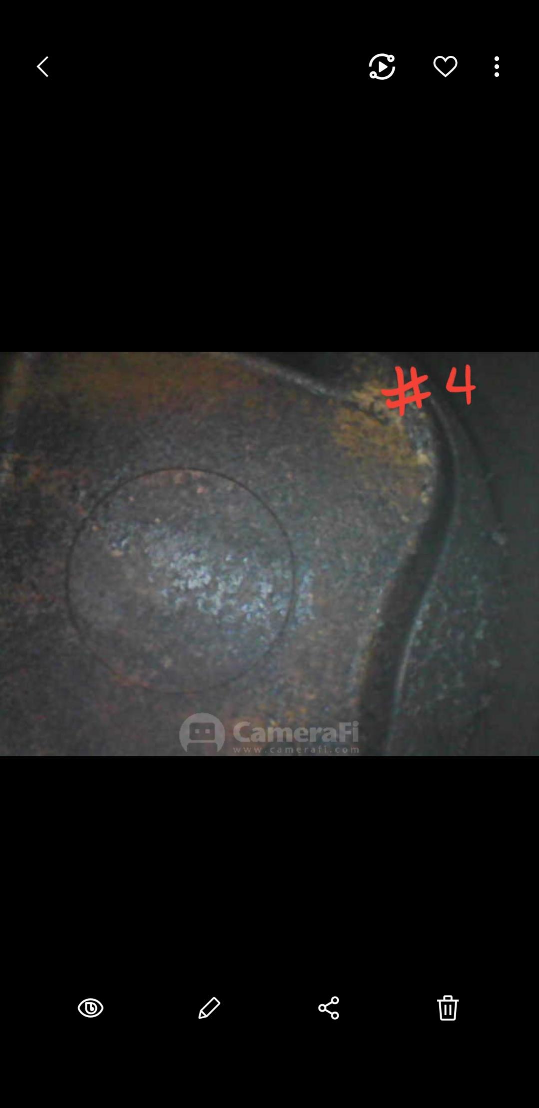

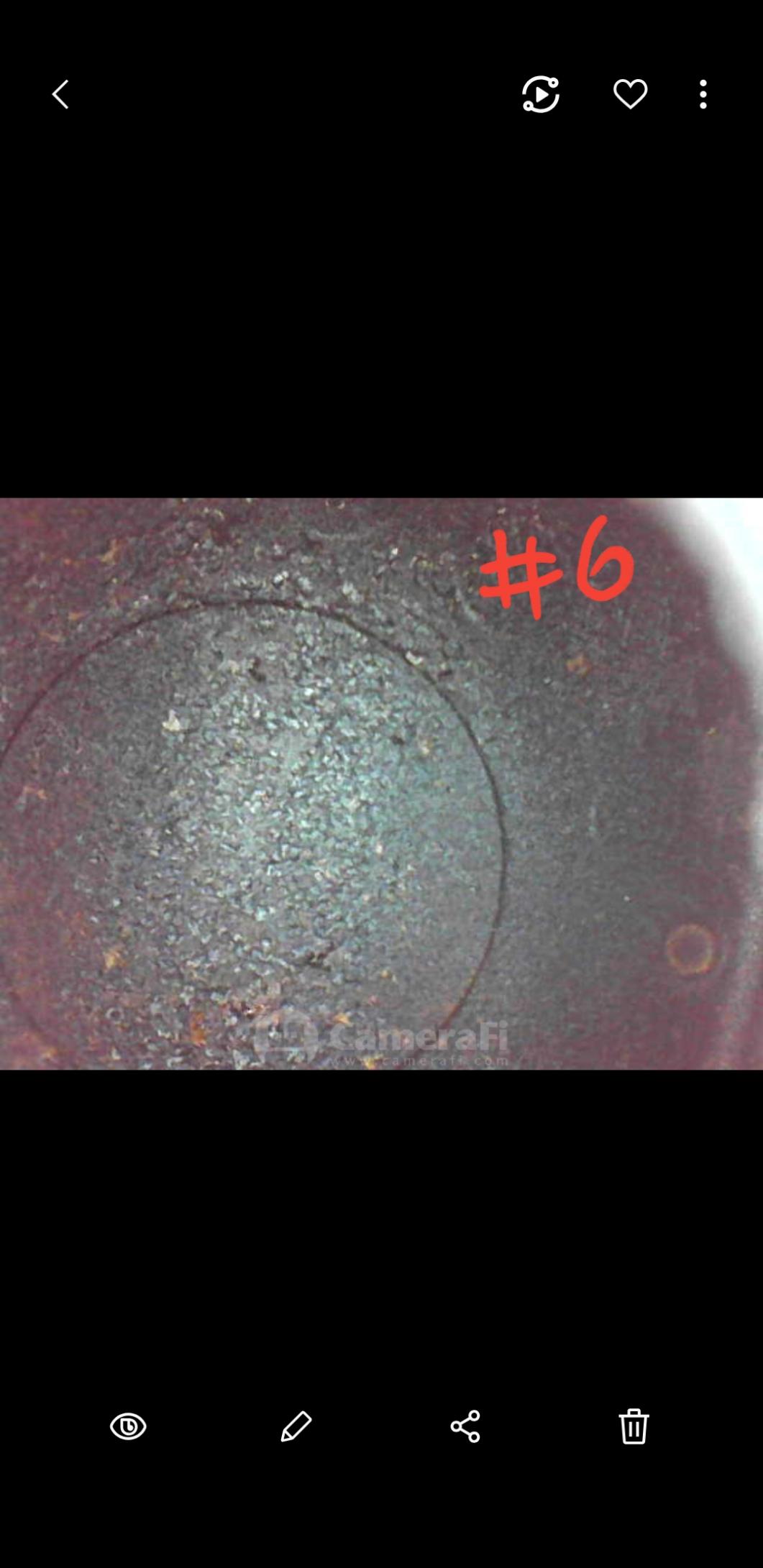

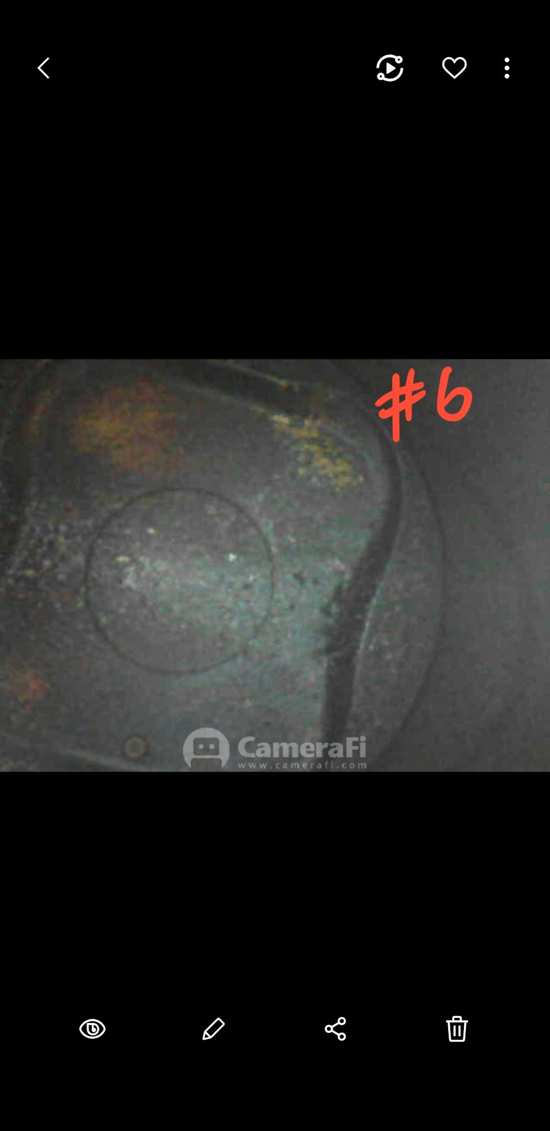

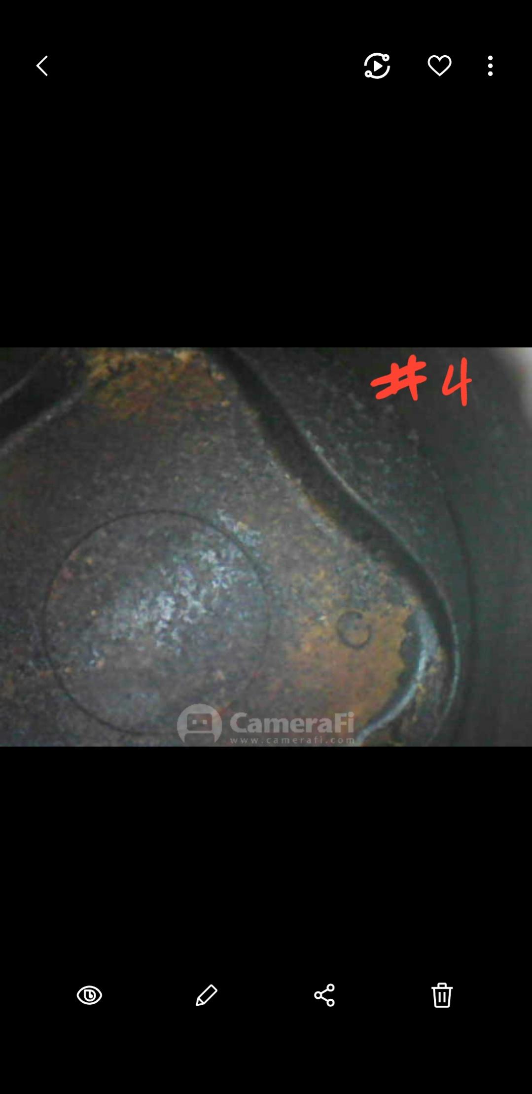

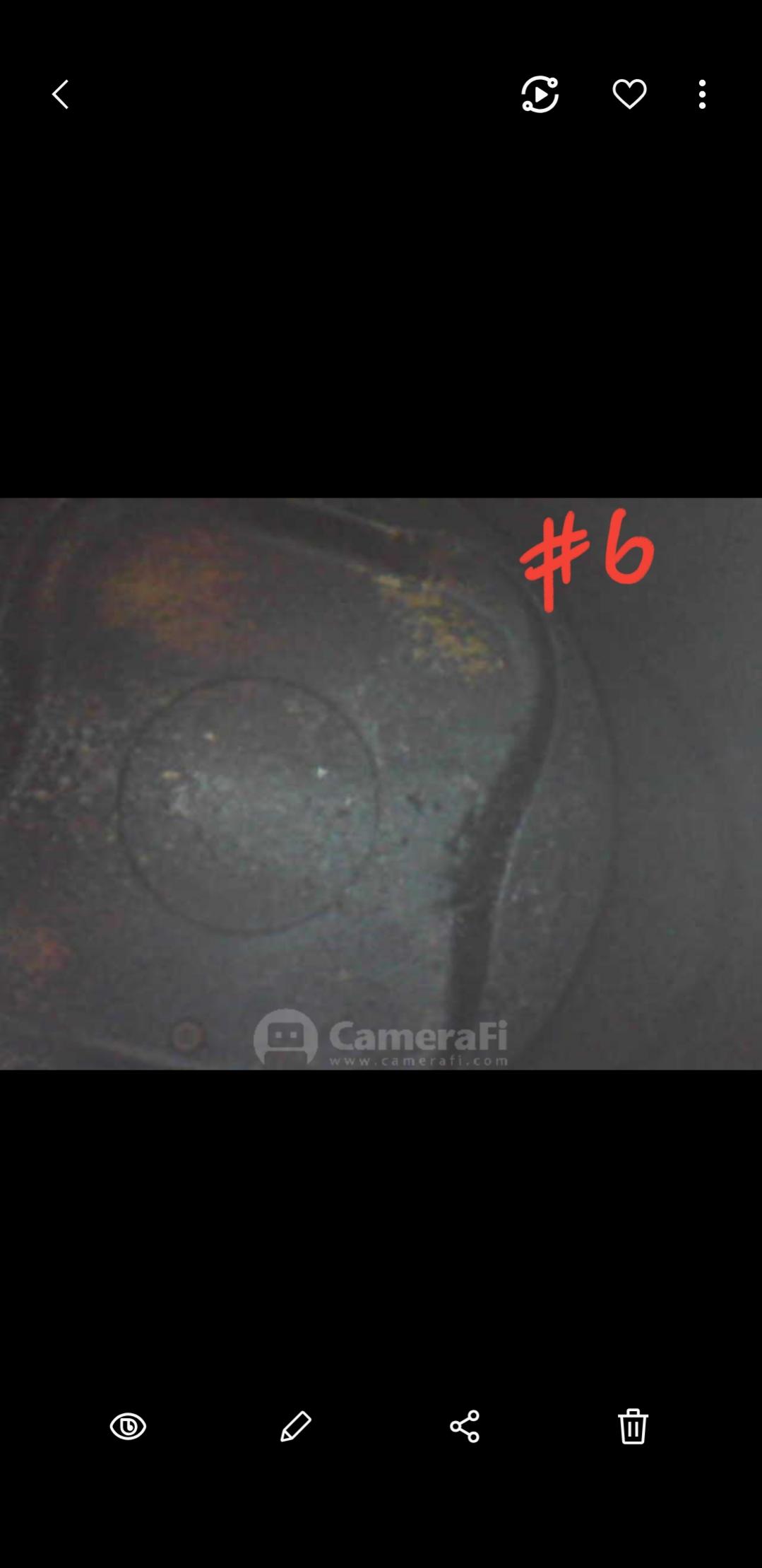

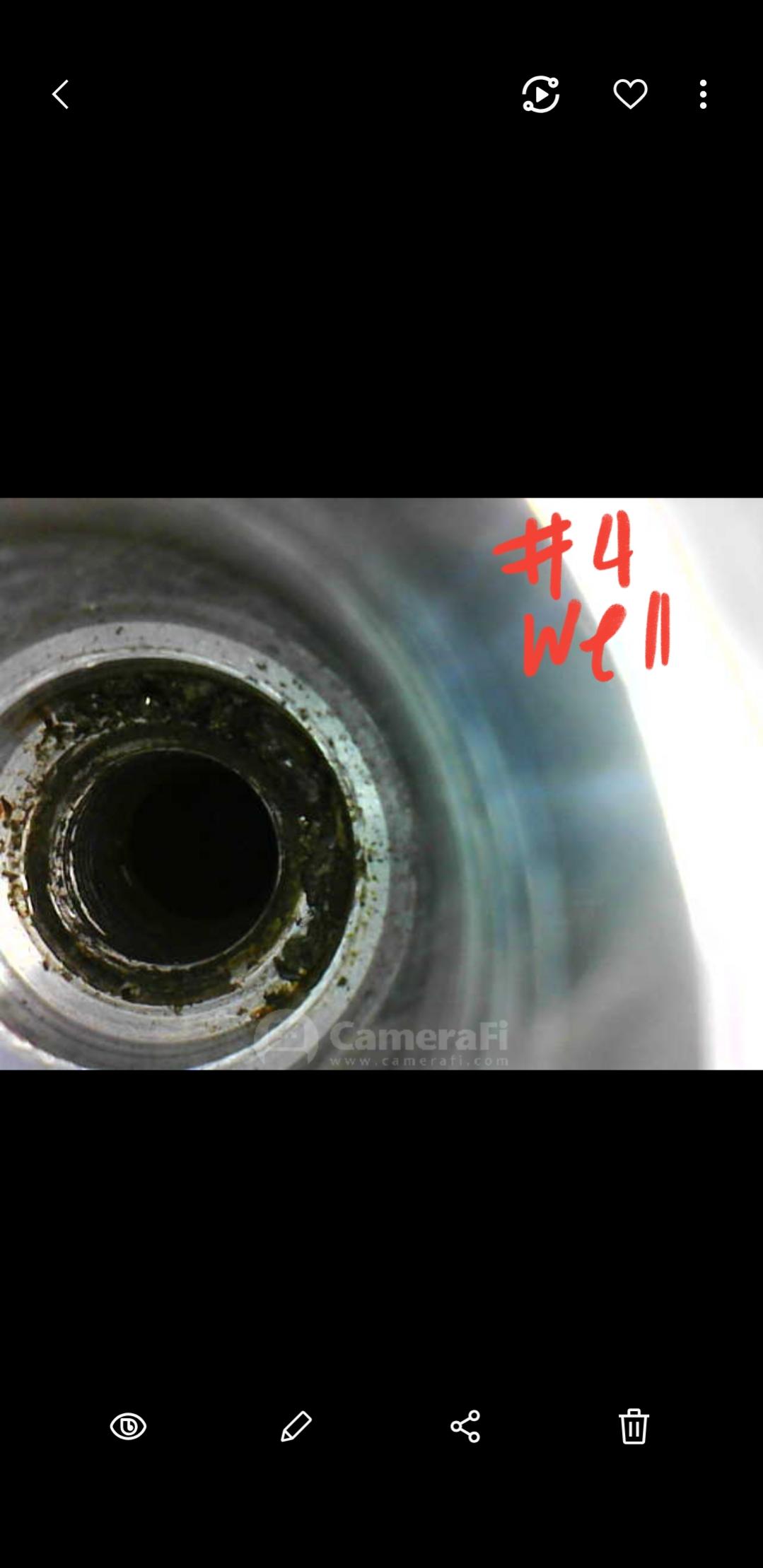

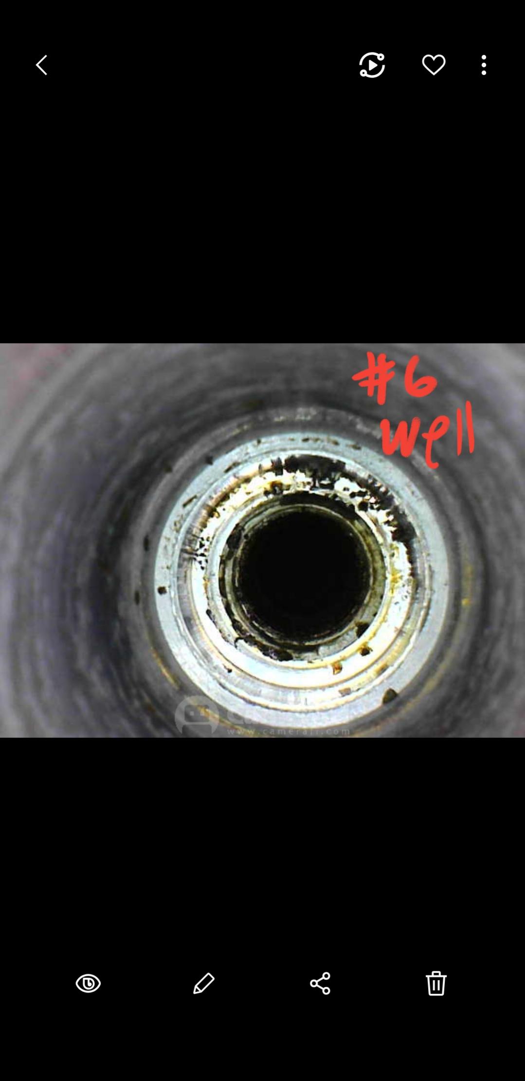

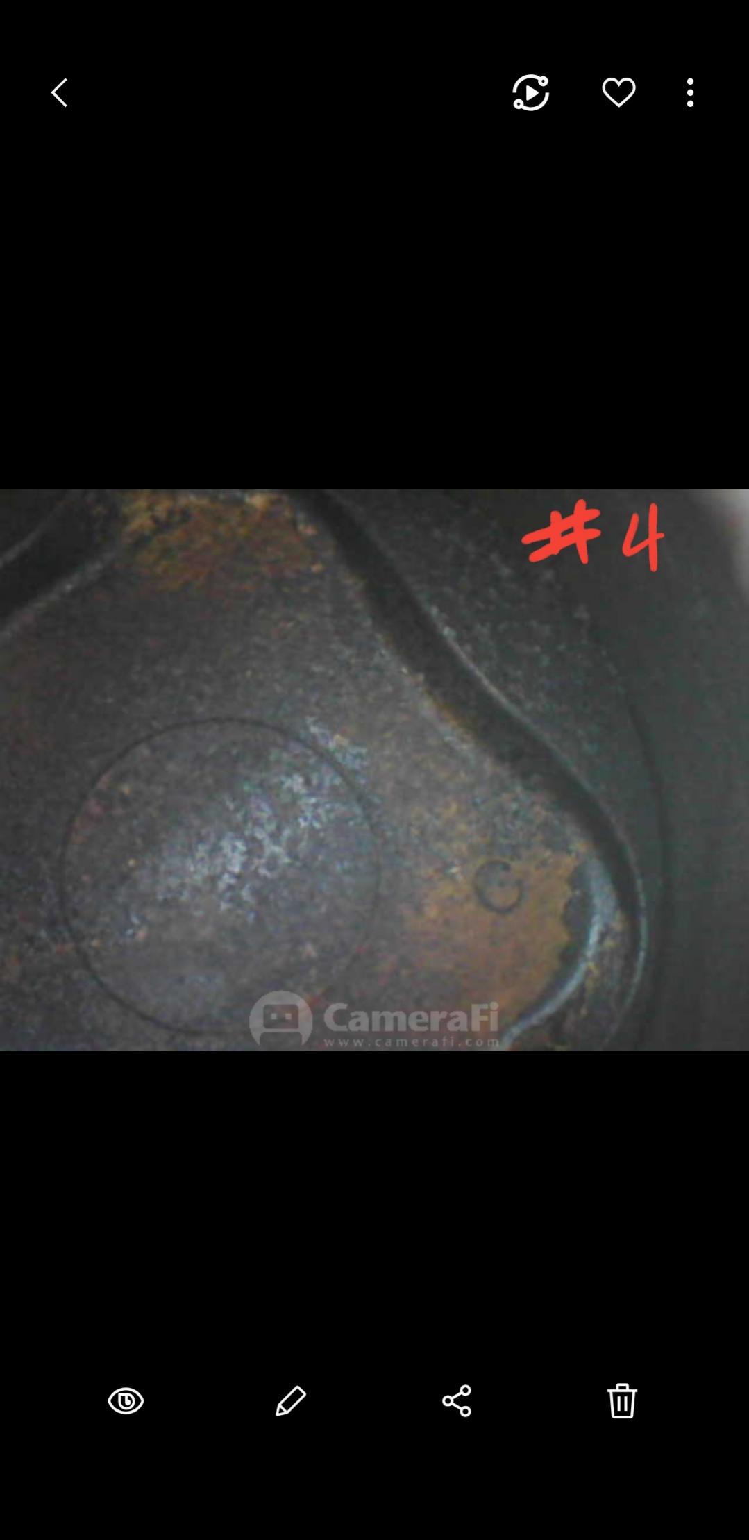

In a previous post I mentioned I just purchased an 03 4.0 v6 a few days ago. The coolant in the reservoir was low, and upon checking at home with a combustion tester, realized that the coolant was low in the radiator (could not see any upon removing the cap). It passed the combustion test (used one of those fluid testers). Has no codes, normal idle on cold start. No film under oil cap, tranny fluid is clean. Haven't investigated for radiator/water pump leaks, but haven't seen anything noticeable. Decided to pull #6 and #4 spark plugs and put a borescope inside to check for coolant in the cylinders.
I am not familiar with HG leaks, or what a healthy cylinder looks like. I did, however, get a few pictures of the spark plug wells, and inside the cylinders. The wells were dirty at the bottom, and there was this greenish liquid about midway up the outside of both of the coil packs, it didn't smell like coolant, just smelled like combustion. #4 spark plug well looked dirtier than #6. The heck is all that gunk? It doesn't look like there is any liquid inside the cylinder, but the tops of the heads look a bit corroded/rusty? Like I said, I have no experience.
Here they are.

The spark plug hole photos wouldn't have any indication of head gasket failure, what I see in those photos is just a bit of a small possible oil leak from where the tube seals inside the valve covers.
The other photos of the top of the pistons dosen't seem show any coolant on the pistons, which is what you would be looking for as one possible indication of the V6 head gaskets failing.
To follow up I would test the coolant for any exhaust gases contamination, which is a tell tale sign of head gasket failure for the V6, if you find no contamination in the coolant I would say the gasket are still holding up at this point.
Most common issue is misfire upon cold starts because coolant pools in the combustion chamber over night. Might want to pull all the spark plugs out, get a cooling system pressure tester and apply about 15-18psi to the cooling system and let it sit like that over night. In the morning bore scope the cylinders and see if any of them have coolant pooling in them
All the photos of head gasket failures that I've seen had nice clean carbon-free pistons because water cleans out the carbon. I think you should flush the system and put the proper Toyota pink coolant in there and watch for leaks.
Agreed on the above - head gasket failures that allow coolant into a cylinder will create a steam blast that will clean pistons to an almost new looking condition. If you find a cylinder that is super clean - there is your leak. I used to have to shut the lights off in the shop and use mirrors to see down into the cylinders to verify suspected head gasket leaks. Now, a simple and cheap USB camera will give a decent picture of the guts inside with no more than simply removing the spark plugs and dropping these tiny devices down inside for a look. Wish we had half this technology back in those days - but then again, vehicles were also a whole simpler.
