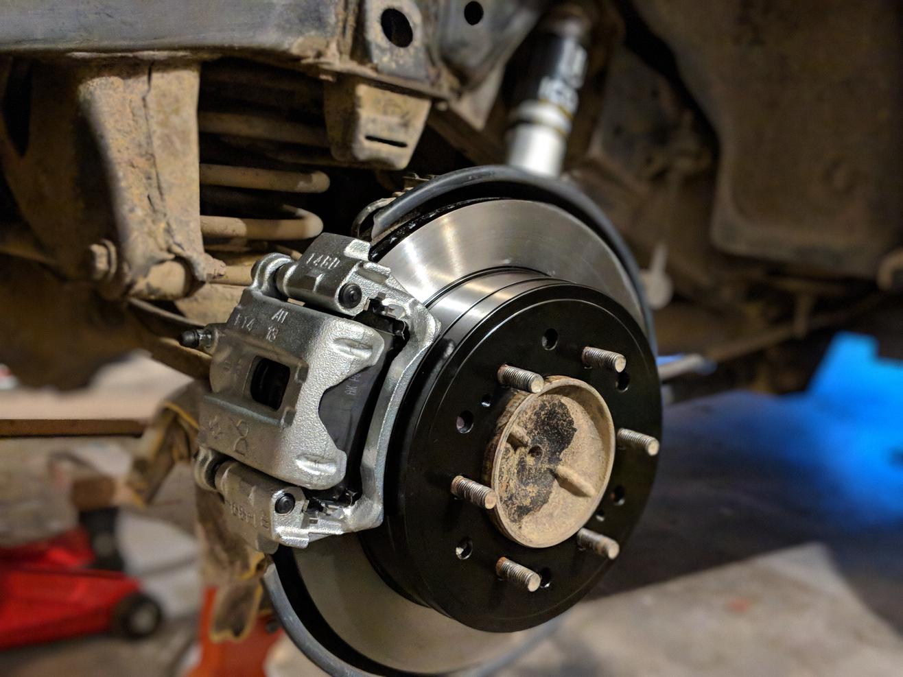

Just the rears right now -- Got OEM Calipers (they were a steal @ $150 for the pair!), Akebono Ceramic Pads with Wagner Rotors (I read that Wagner is an OEM Manufacturer). So far, even just the rears, the brakes feel much better. I was surprised that it would make much of a difference in the rear since it's essentially all the same. Maybe it's just new vs old, and sticky vs. smooth operation haha.
