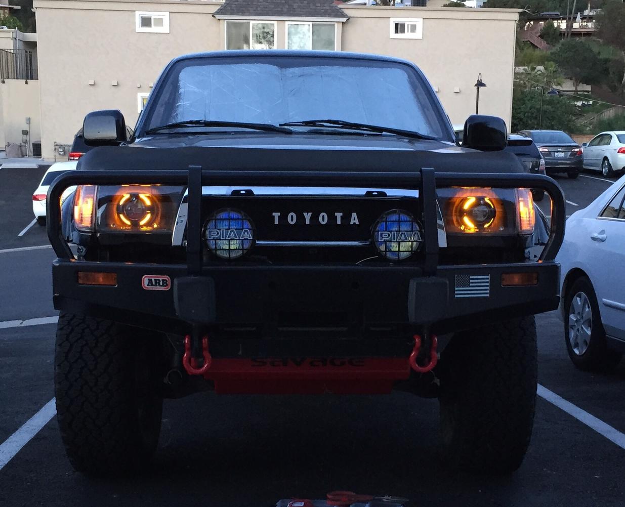

Update for those following this. Quoted from my build thread, linked below.
Pictured here is the next step on my Retrofit, now installed.
What has changed in this picture?
Two things:
1) put Amber led bulbs in the corner lights. These are 6 way LED bulbs but I blacked out the front facing bulb so it doesn't shine straight ahead.
194 AMBER 6 LED HIGH POWER 360° | 1 PAIR
2) In the retrofit I installed rear facing Amber halos to complement the front facing halos. Also I trimmed the shroud a bunch more so it would let out more orange light.
The only remaining step will be once I get my 12" Amber LED strips and mount them to the ARB at a slight angle to follow the lines of the bumper. Unfortunately even though I already ran the wiring, those won't ship until next week.

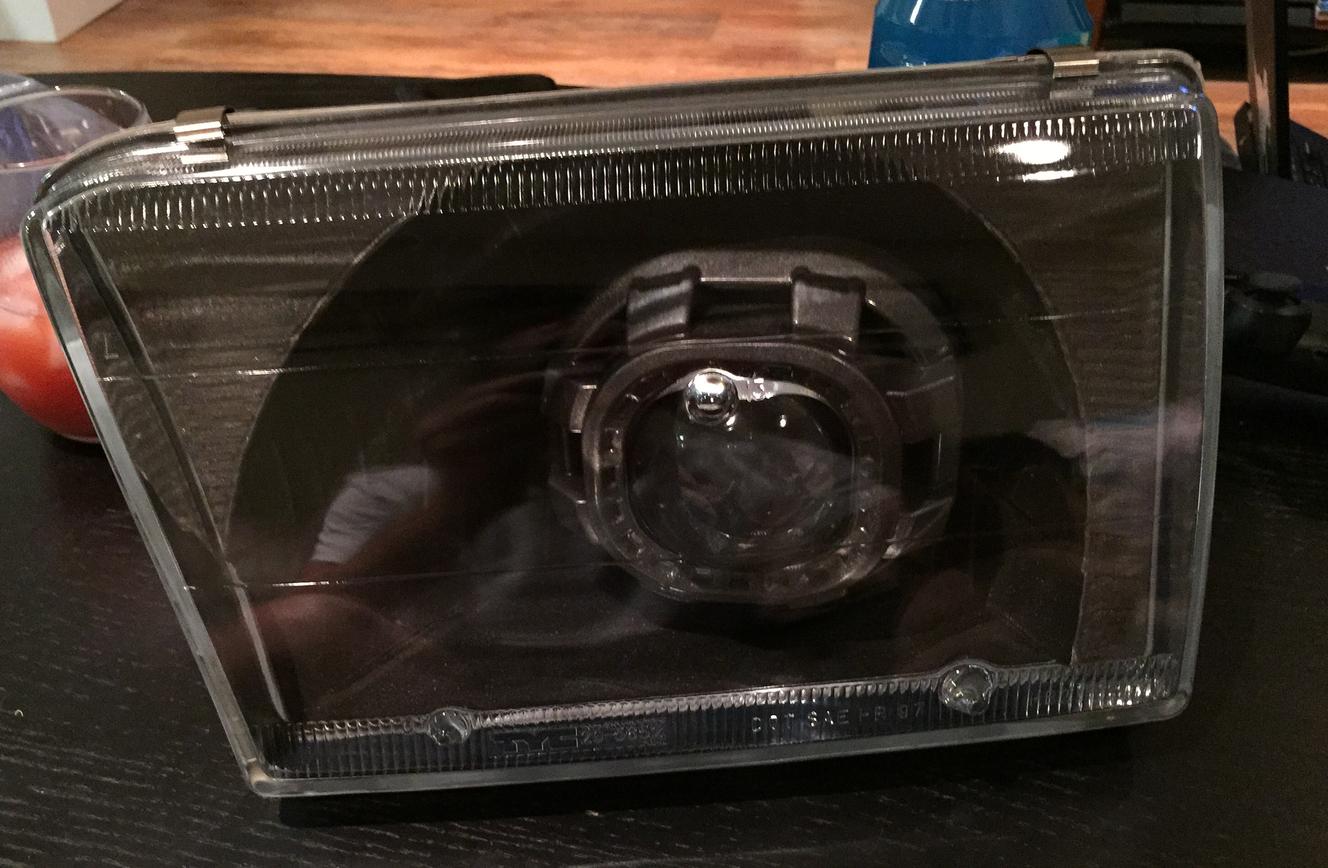

Hi,
Here are the results of my FX-R retrofit on a 97 4Runner. I previously had a full retrofit kit with Lexus Projectors done by a semi-pro. It was quite a good kit but I wanted to build one on my own that was painted on the inside and had amber halos. This is my first retrofit attempt. I don't really think of this as "write up", it is more of a project report. I will try to be as thorough as possible.
For anyone trying this project - I would highly recommend reading at least the first two pages of the thread and not just the initial post. I made several important updates below that you will find useful.

* Bake Lights in oven at 275 F for 7 mins, do this ONE at a time.
* Remove each lens with two screw drivers, it should pry off with a small amount of pressure.

* Snap the shrouds (with halo inside) onto the face of the projector - don't scratch the lens. I chose not to glue the shrouds onto since the fit was so tight. Gluing is unnecessarily permanent for this step (don't glue them onto the projector!)
* Use the oven to reseal the headlight lenses back onto each headlight, be sure to wipe of any fingerprints first.
* Install. Op-Test.
