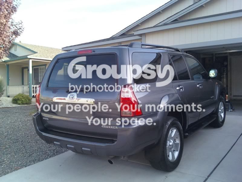

Love the rigid lights has anyone tried putting the flush mounts on the 4th gen bumper? I have a set of rigid duallys on the back of my 88 pickup they are brighter then my headlights.
I was going to flush mount in my 4th gen, but bumper is not flat enough and won't sit right. Rigid Cree lights is what I have. I'm still trying to come up with something I will let you know if I figure it out.

Like many others, I'd like an option that seems integrated rather than bolted on. I was looking at my back end, at the molded-in notches on the bumper, like this guy's. Since the center one on mine is notched for the trailer hitch, I was wondering if there was a purpose for the other two beyond just simple aesthetics. Is there enough room behind the cover to mount something in that space?
Image-2.jpg~original
@TiN had a really cool 3D printer project retrofit he sells for forum members, I myself went through with it and it fits well into the 03-05 bumpers, and not to mention has tons of light throw with the superbrightLEDs it's made for.
http://www.toyota-4runner.org/4th-gen-t4rs/188840-quick-easy-rear-bumper-led-cube-retrofit.html
I saw that! It's a beautiful job, really, and a genius use of what's already there. It's one of the reasons I was wondering about the other indents on the later 4th gens.
