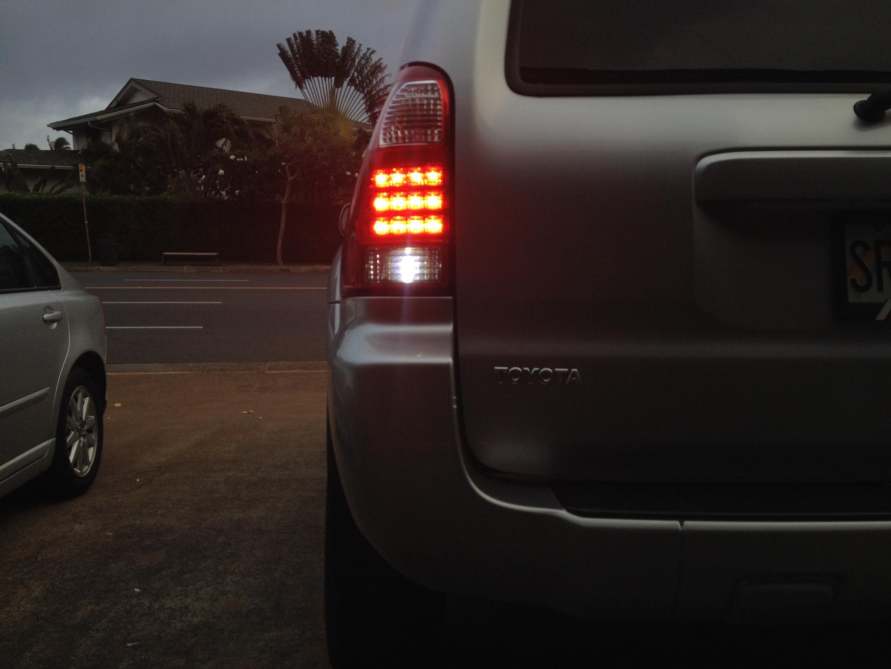

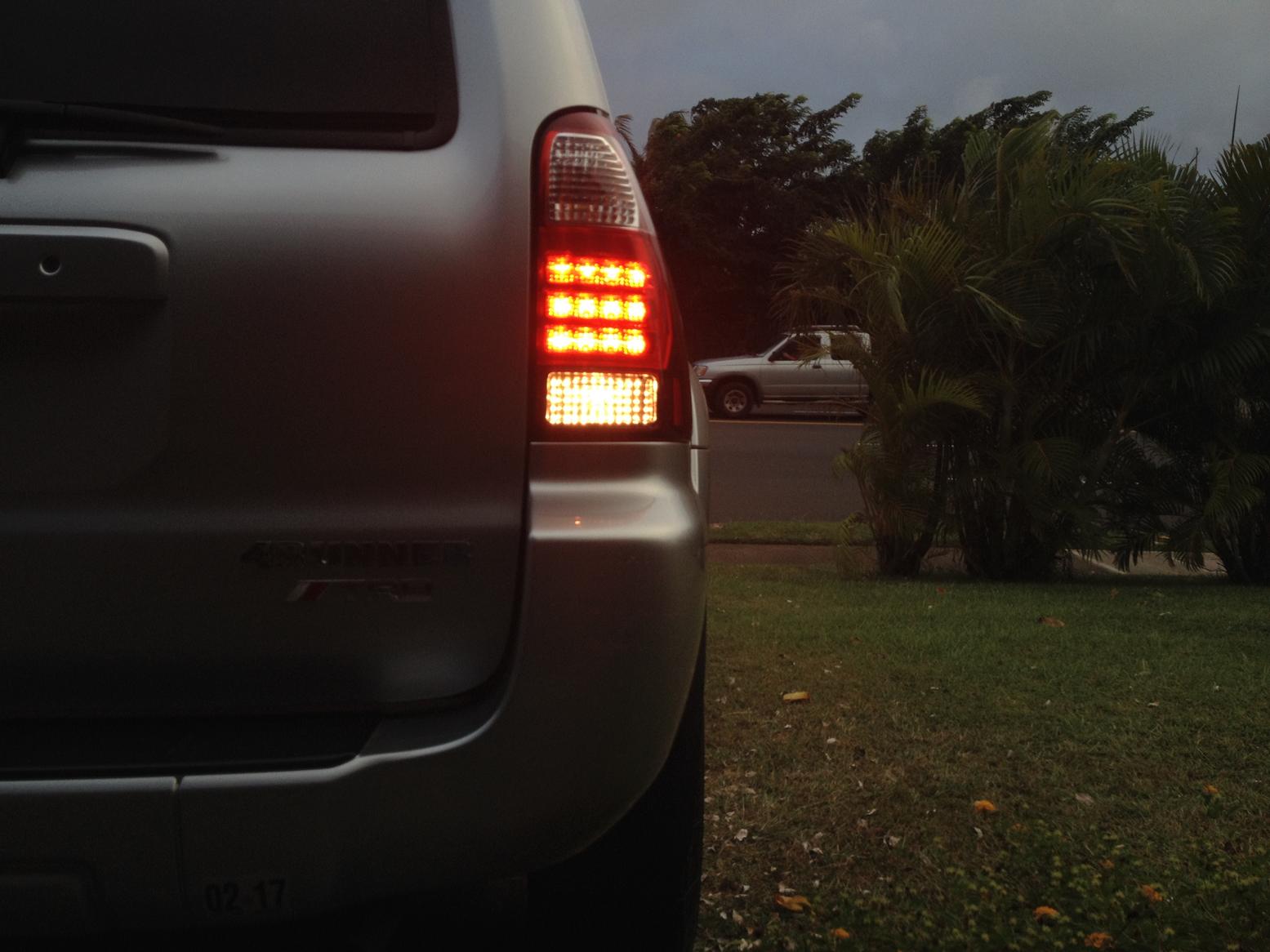

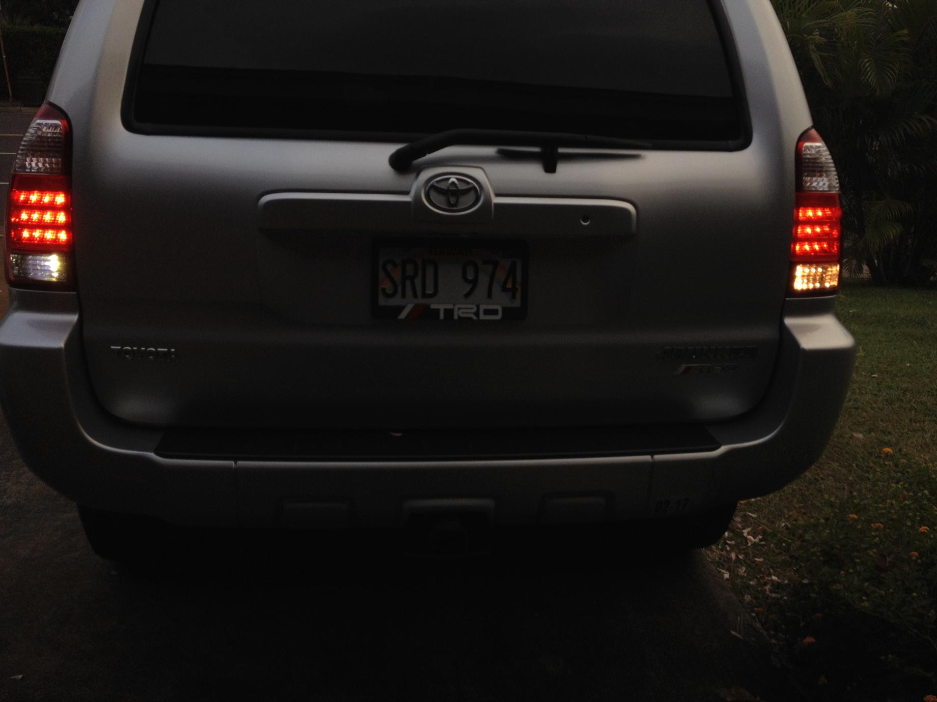

i swapped my stock reverse bulbs today with some Morimoto XB LED Bulbs. The Morimotos only project light outward which i thought would be better because you get more light where you need it, but I'm not too sure. You decide which is better.
Edit: so i concluded that these bulbs are better than stock, but not by much. You can see some light out the back. maybe just as bright as brake lights or just slightly brighter, where as with the stock bulbs, you couldn't see any light out the ba c k

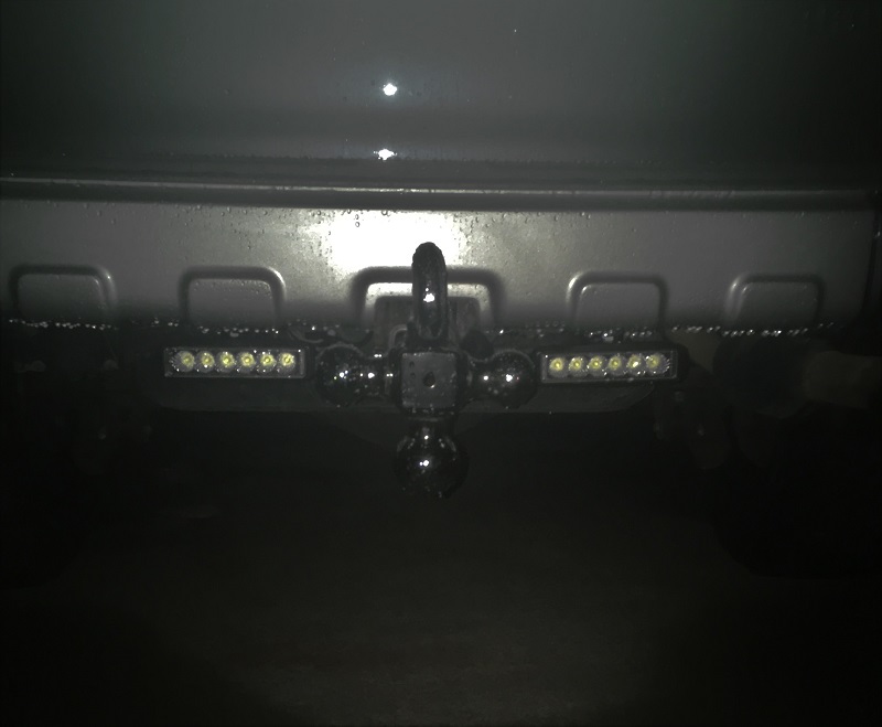

Just completed this mod a few days ago. I got the light bars for $15.00 and a complete BAJA Lighting wiring harness from Auto Zone which worked out perfectly. I had to buy 12 extra feet of wiring from Auto Zone as well, so I have about $45 into this mod. I will be doing a write up on this in my build thread ASAP. Note: the lights aren't on in my 1st picture, and I apologize for the poor picture quality.
:flamethrwoer2: Out-put shot from the driver's side:
