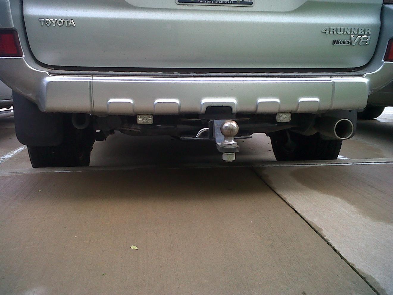

My Vote goes to” add on” backup lights… you will get what you pay for (money or amount of labor wise), see picture below for what I have.
They are mounted to metal sub frame of the rear bumper; they are turned on (trough relay) with normal backup lights as well as independently by the switch on the dash. BTW those are $20.00 lights from Wal-Mart; they work great!
