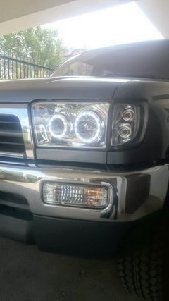

Where do I get these headlights? I saw them once in a post from Russia. Also saw some dual bulb corner markeres.
He wrote he got them from Rumin sports. And I do have them too. But as the plasic of the lens holder did not match my expectations I replaced it with somethig more solid. And put real HID in.
The truck looks gorgeous with those headlights :-)
