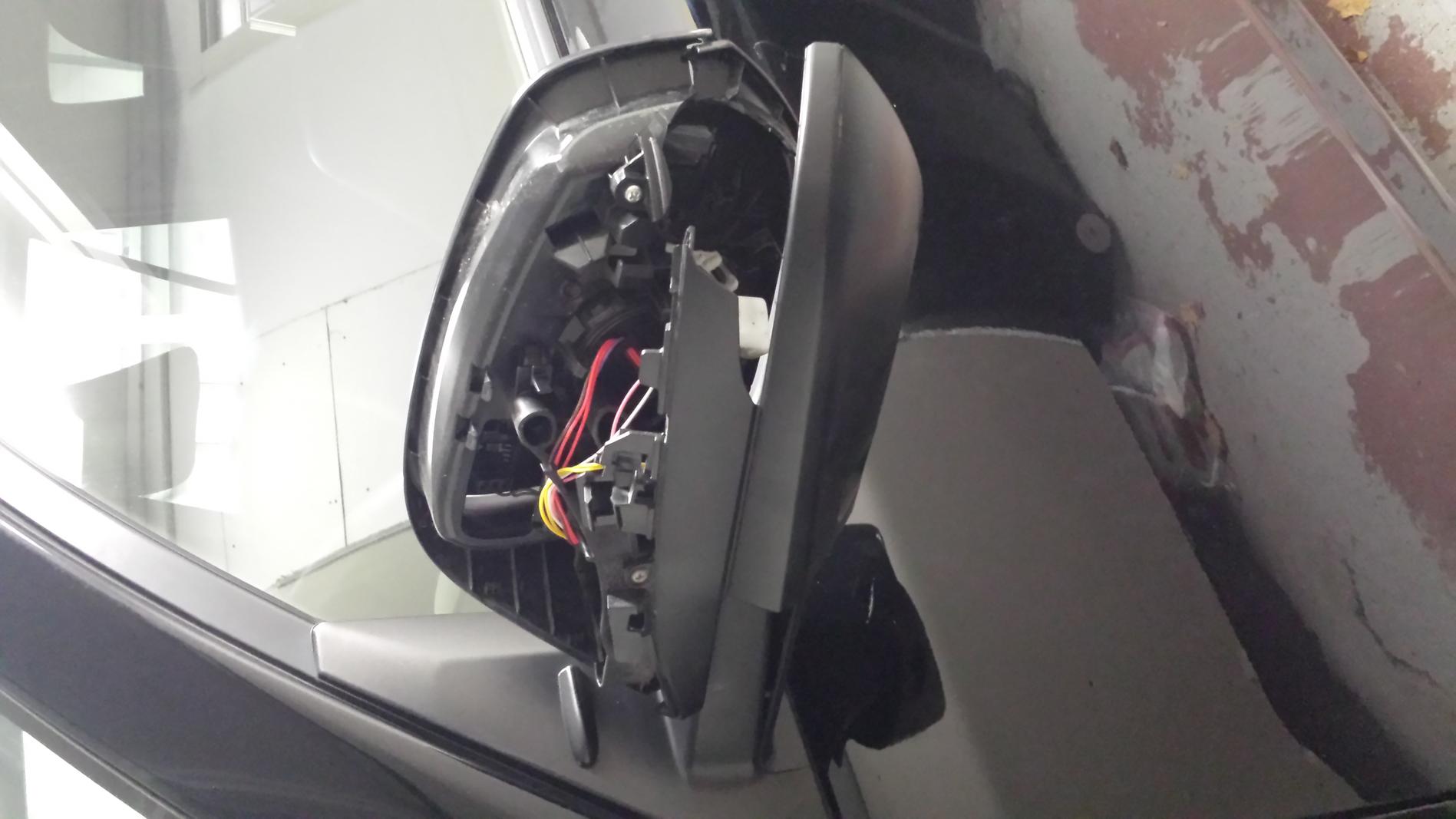

Ok, so I was backing up into my garage tonight and barely clipped my drivers side mirror on my 2014 Trail and the whole backing broke off, including the LED turn signal. The mirror itself never bent backwards like I thought it should of. Regardless, I need to get it replaced. Do I need to buy the whole unit? My mirror and motor are fine. I can move the mirror with no problems. Obviously, no turn signal. Where do I get the part for this and is this something a novice can do or do I need to go to the stealership? See pic of the damage....Thanks guys! I have no idea why the picture comes out sideways.

I replaced one on my neighbor's Lexus LX-460; piece of cake! I was able to get the parts e.g., mirror glass, shell, motor assm...etc on ebay for a fraction of the (Lexus) dealer parts dept cost! Here's a "How To" video on removing the 'Puddle lamp' bulbs (Toyota or Lexus) but just follow the procedure of removing/replacing the mirror glass; it's the same thing on the 4runner: https://youtu.be/FaScaGV1bbs Very easy!
PS: ...As far as painting the shell, you can have the new one painted BEFORE you install it. Just drop it off at a local body shop and give them your VIN number so they can match it up.

Thanks for all the great info. I would rather do it myself and save as much as I can for something easy. Appreciate all the tips! If my mirror and motor are still working, do you have any idea what parts I would need? Seems like I just need the casing/housing and the turn signal light as the LED broke when I hit it and the puddle lamp is toast. Will have to check e-bay and see if I can find what I am looking for.

IDK Scott,
I could be wrong but judging by the photo that you've posted, it looks like you'll need the whole mirror assembly e.g., mirror carriage, outer shell, motor assm (two motors; 1 for up/down 1 for L&R), Mirror glass... However, these mirror assemblies can be obtained very cheaply online because the 'Salvage yards' have joined the race to sell online too! There's a vast supply of 'Wrecked' Toyota's on these salvage supplier's stockroom shelves these days so shop around!

Thanks all. I found a "high quality" aftermarket one for $80 for the whole asseembly. I see that Partznet sells the shell already painted for about $40 so I think I will go that route. My shell only has 1 broke tab on it so unsure if I could reuse it or not, but will try. Don't need it flying off though either. Hopefully the install is as easy as they all say.

Install was easy. Just had to take my time as you have to take the door inside panel off to get to the wiring. Other than that, it was just 3 screws holding it onto the door itself. Good as new and no problems.
