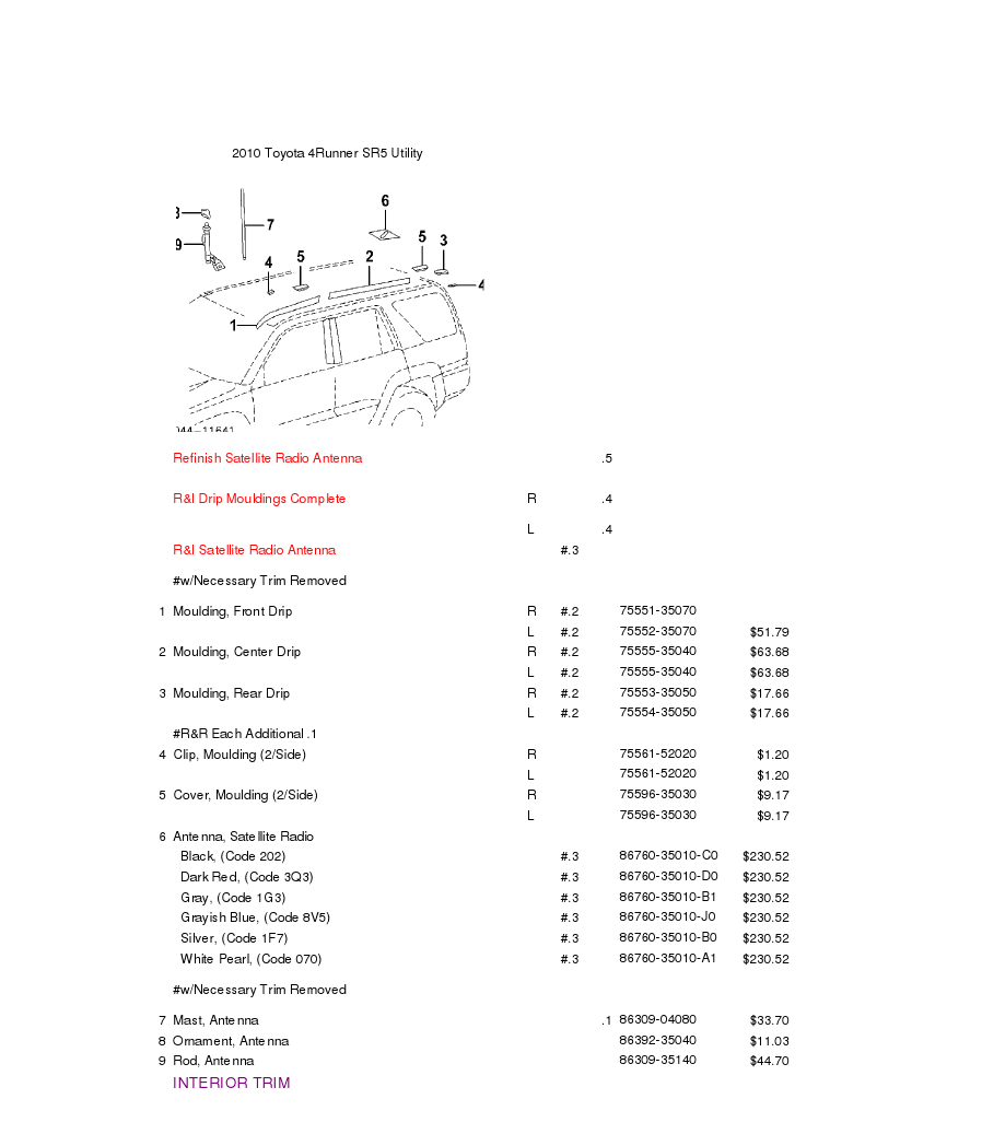

We have the repair manual and parts manual here on the forum. Your probably going to have to replace the receptacle.Here's the parts and numbers,but not sure if you need #8 and/or 9.
