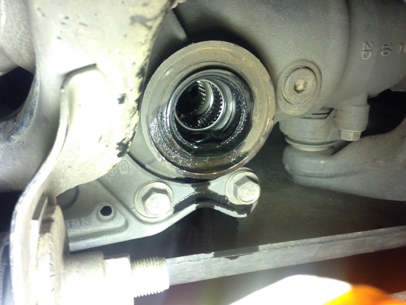

I got the blown CV out but the outer lip of the internal seal is torn. It doesn't look horrible but I'm not a expert. Should I replace? How the hell do I replace it?
Thanks for all the help, this community is great. I'll post the carnage picks of the CV in a couple min.
