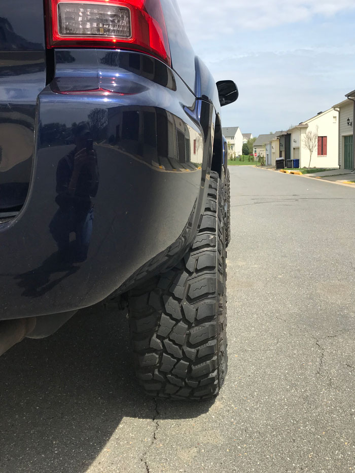

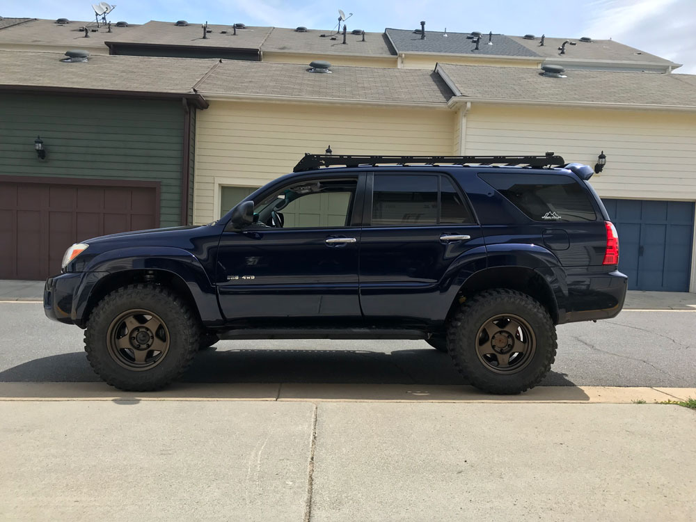

How big are you going?
Don't think it's the same blue, but...
SCS F5 Matte Dark Bronze
17 x 8.5
4.3 BS
-10mm offset
Cooper STT Pro 285/70/17
JBA UCA +4deg
I had to BMC, YMMV
edit: fixed tire size, I wrote 285/75, I'm running 285/70
