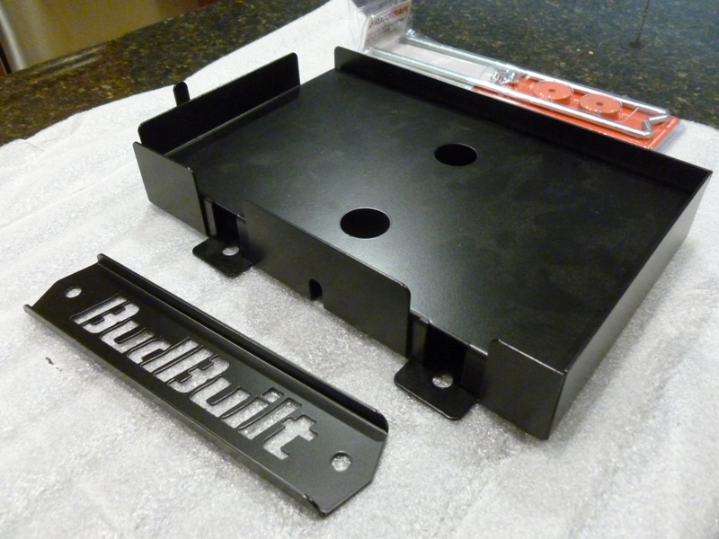

Told you guys it was really really close, lol. Let me sort out the details and do a test fitment and write up, so that I can give everyone some concrete and detailed answers/pictures.
Right off the bat, I think I can safely say that this would only work on 2010-2012, unless you guys figure out how to relocate that smog pump taking up all the space behind the passenger headlight. Sorry 2013+ folks :ohwell:
I must say this whole tray system is a VERY clever design and well thought out. Should be 100% bolt-on with no hacking of your OEM P/S bracket; and the best part is, 100% reversible (this was one of the reasons holding me back with the ABR tray).
I now understand why it took a while to get this bad boy to fruition, but I have to say it is well worth the wait, IMO :)
Hold on to your wallets a little bit longer and stay tuned guys! I'll try to get on it ASAP :usa2:

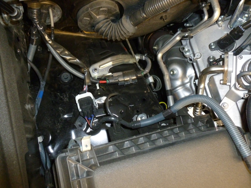

The good news: I got my BB Battery Tray in the mail!
The bad news: My 2013 has the smog pump in the way.:rant:
It looks like the smog pump can be relocated to the other side of the air filter box by creating a new mounting bracket to tie into existing threads coming from the sheet metal in that area. The wiring harness is plenty long enough and comes from the near the firewall so the only tricky piece would be running a new hose from the pump to the Tee near the front of the engine. Other than that, it looks like Bud designed in a bracket mount for the power steering reservoir.
Here is my pump:
Here is where I'd like to relocate the pump.
Now I'll have to figure out a bracket to fit down there and move some of the cable harnesses out of the way.
I won't be able to work on this for a few months though so hopefully someone will come up with a clever design by then.

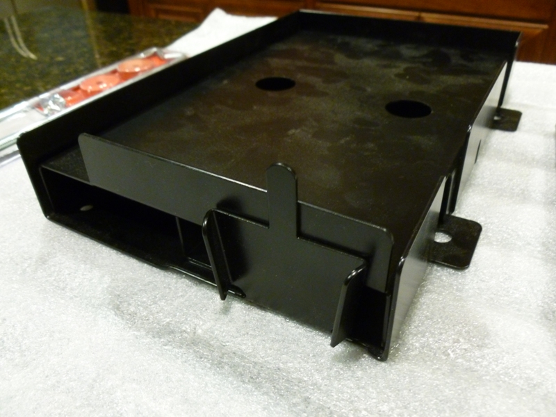

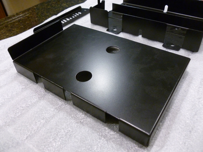

So it looks as if the base is two pieces. Do you bolt the lower piece in then drop the upper in and set the battery on top of that? Also how tall is the base? Is the space between the top and bottom designed to be used for something specific such as routing wires or mounting something?
I think it was ~1" taller or so? It was really late last night when I got around to unpacking and I got too tired to mess around with it, but I will get specific measurements and all that good stuff for you, hopefully over the weekend.
I don't think the space is designed for routing wires, probably just to clear the a/c line rubber isolator thing. And yes, you bolt the bottom plate down to the chassis and the top piece sits inside it. Then the J clamps hold the two together.
