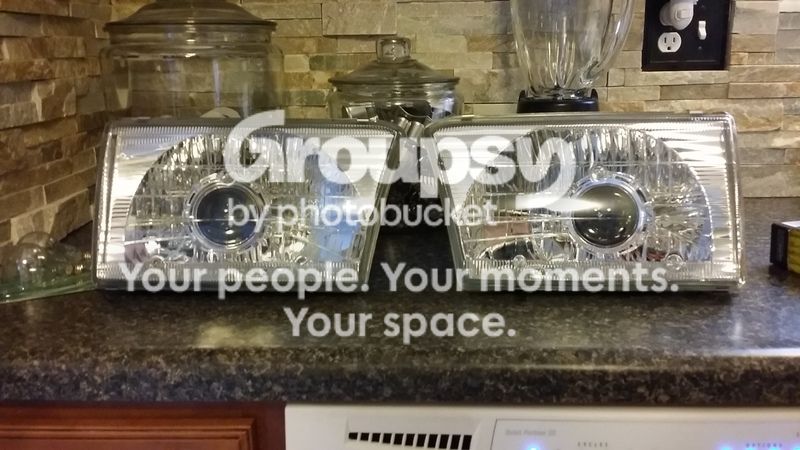

So, I finished these up tonight. Several notes about them.

1. Make sure you put the damn things in the right way the first time. There's a reason they're cheap. I had to order a second set of projectors after the nut on one of the originals decided to cross thread on me while trying to remove it.
2. The instructions that come with all of it SUCK. Basically, you get none. The High/Low Harness basically replaces your factory setup. This is how it works:
-Unplug the stock lights
-Plug the High/Low harness into the drivers side socket and connect it to the positive lead on the battery.
-Plug your ballasts into the harness, then your bulbs into the plugs from the ballasts. There are two wires on each bulb harness you can get rid of. They're the blade connectors that are supposed to plug into the factory sockets. The high/low harness negates all that.
If you're like me, and you don't know all that, you'll stare at it for about 20 minutes and get pissed off and just start plugging stuff in until it works.

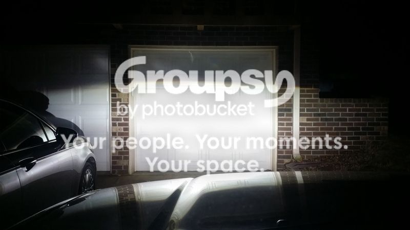

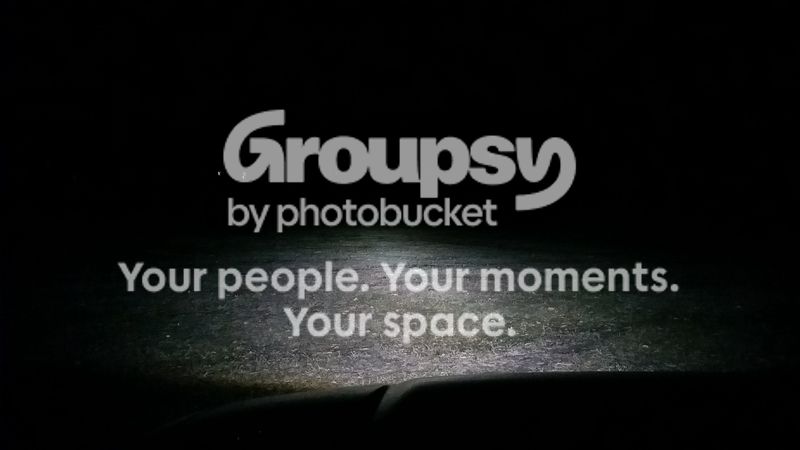

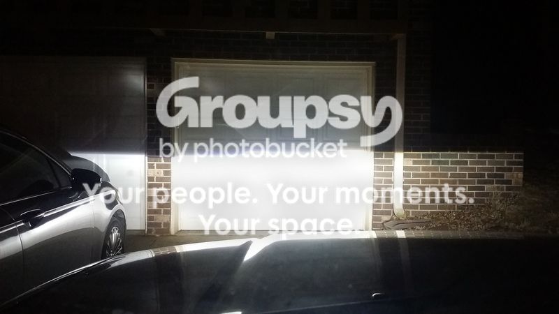

Now that that part is out of the way, let's talk about the final product. So hey, I'm not unhappy with them. There's some MINOR halo's up top, but overall I think the cutoff is pretty clean for 40 bucks. Focus is pretty solid as well for, again, 40 bucks.
20160214_204527_zpsc5wrzj5m.jpg~original
20160214_204523_zpsy6jlnbgd.jpg~original
20160214_204225_zpsl3gx1jgl.jpg~original
I could do a little more aiming, get a little more spread if I really wanted to, but I'm not positive it's worth it.
I don't have anything to compare these to, retro kit wise, but I'm very happy with the money I spent and what I got for it. If you're looking for something that isn't 800 bucks, you can do yourself with virtually no special tools or crazy epoxy jobs (you will have to change the terminal on the power supply wire if you want to fit it on the battery post), these are a solid choice I believe. YMMV.

Most would say yes. I didn't drive very far last night, so I can't say for sure if I gained distance. I will say the coverage is far better than my picture shows.
