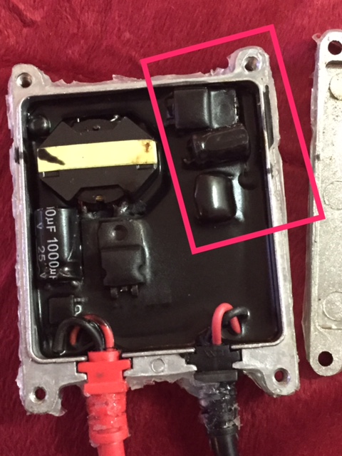

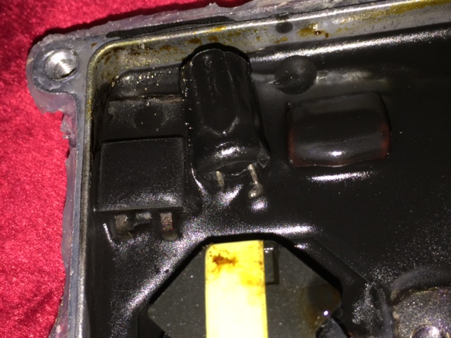

UPDATE: Within a week, the passenger headlight died. Troubleshooting lead me to believe the ballast went bad. Cut through the silicone I added around the seam, unscrewed it, and boom! Something blew inside, leaked black crap on one side of the ballast (not the black material covering the entire inside of the ballast), and smelled like a strong electrical burn. Not sure what could have happened, but got on the horn with the company. They shipped out a new ballast, no questions asked. Should be here this coming Tuesday.

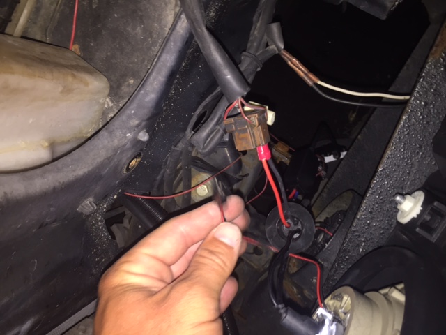

sorry if this has been covered already but with the two wires that come from the projectors themselves where do they plug into? also when tightening the locking nut you want it to not be able to move correct? or is a little wiggle room okay?
The two wires are the solenoid for the brights. There should be a corresponding jack on your harness for this.
Less wiggle is better. You don't want your headlights wiggling around while you drive.
Less wiggle us better. You don't want your headlights wiggling around as you drive.
Sent from my Nexus 5X using Tapatalk

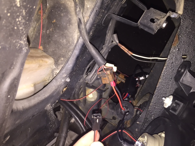

i can't seem to figure out where it goes everything seems to plug and play besides this
Pics?
so i have no clue where to plug any of these into the original harness on the runner i think the one set is correct but don't know where the two from the actual light go sorry about the crap pictures

never mind just got an email that my missing harness has shipped, thought it had everything but clearly now it makes more sense haha dumb me
