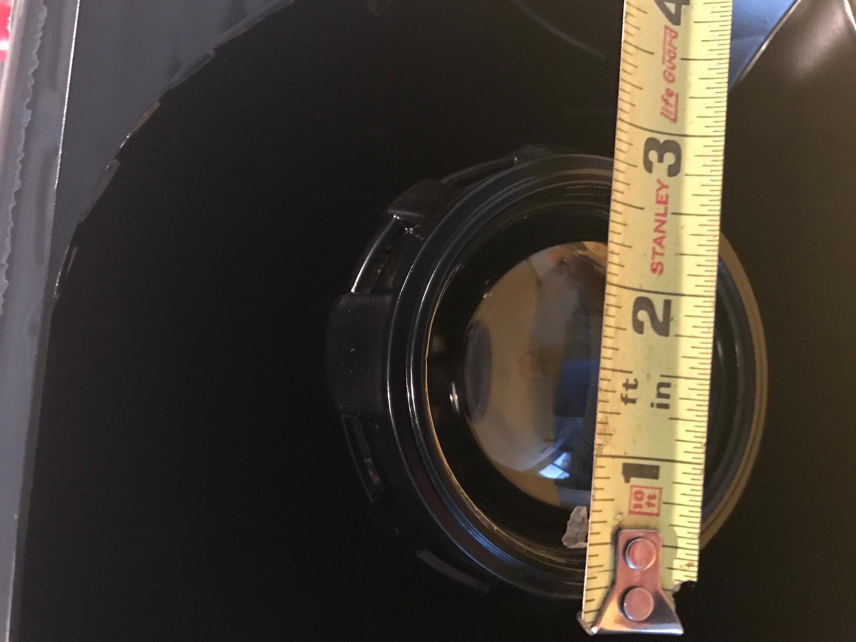

Thanks for the measurement [MENTION=145916]dustxking[/MENTION]
I may order these up and try to wire in the halos as the DRLs. I'll let everyone know how it goes when I get around to it.
I am almost positive these will be 70mm angel eyes, I cannot say for sure. Based on OP's picture, it looks close to 2.7" so, that would make it 70mm, possibly 80mm. Anyone?
