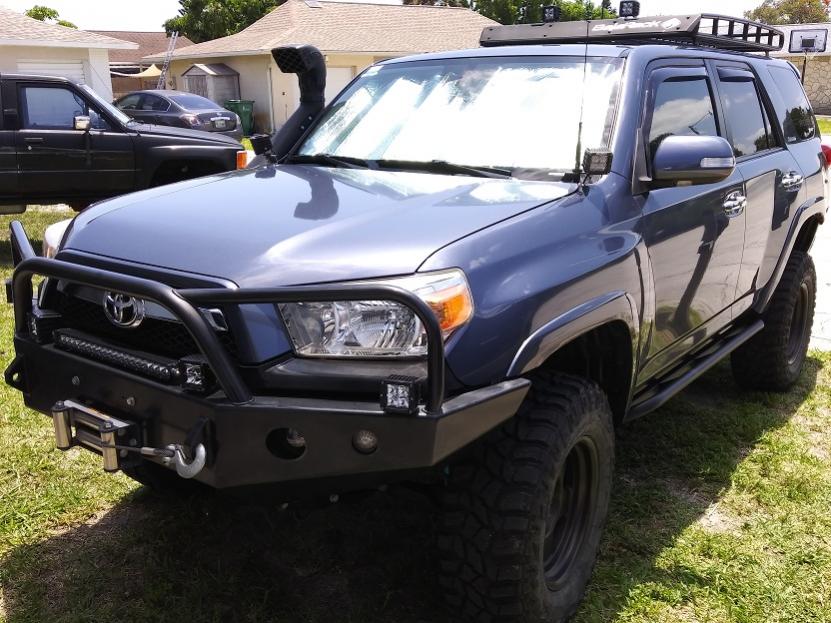

Ha there is not much actual speed involved with this truck. The holes are actually more functional for washing out all the dirt that accumulates back there.
Plans for the Bumper? More stickers. I might have something very light fabbed up as a tire carrier as the truck is heavy enough (over 5800lbs w recovery/tools), but the rugged unfinished look is growing on me. It kind of represents me in a nut shell, rough around the edges. Do Not miss that plastic crap though. The Dark Bronze was the best color choice I ever made. Really goes well with the Shoreline Blue.

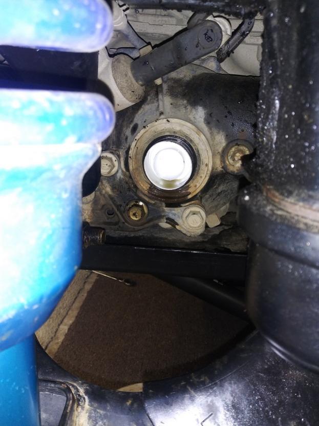

What's underneath the bumper cover on the bottom side. Anything that would get mangled/caught on a rock?

Thanks!! Been pretty happy with the SW Bumper. I like these headlights too. Sooo much better than the 4th gens.
As far as under the bumper cover? There is the inner fender, some pinch welds and a vent that allows the pressure to equalize when you shut the door that could get damaged. I don't think there is anything critical under there. It's just an open gap under the location where the OEM jack is stored. If you hit a rock hard enough, even with the cover on there it would still take some damage.

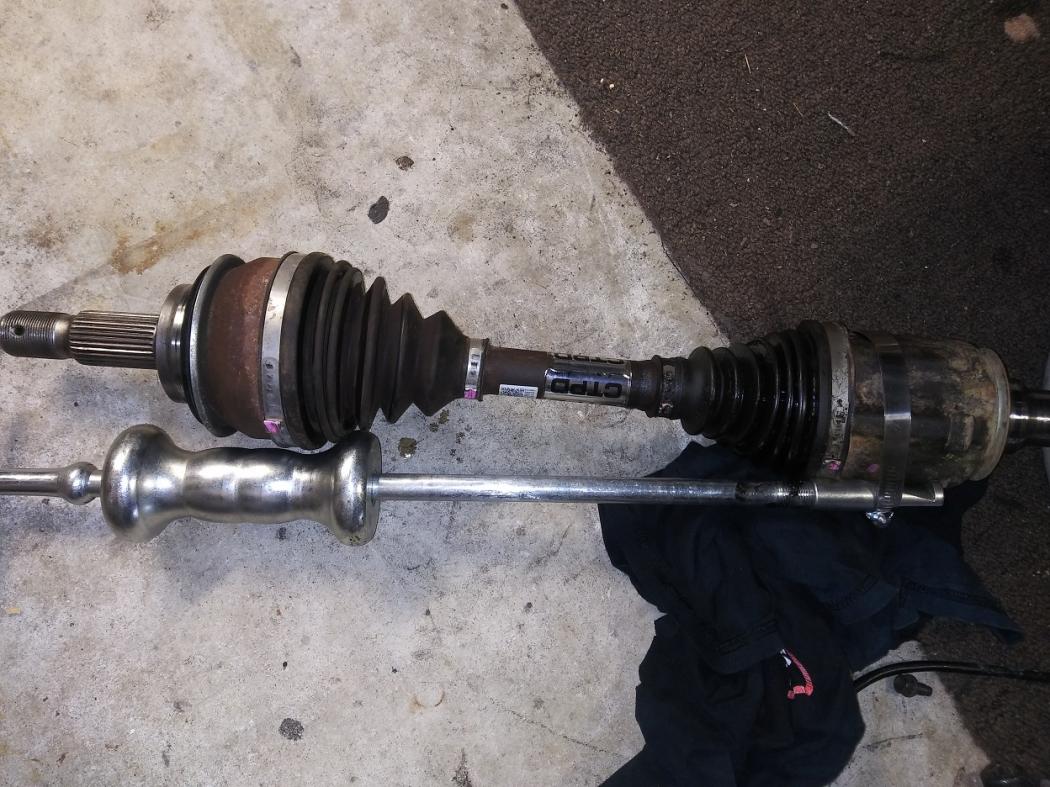

CV Axle
I had been bragging about the Toyota remans I got at the dealer for $150 ish, but not anymore. Inner boot tore pretty early. The only thing I can say in their defense was I just rebuilt my Kings last fall, maybe I damaged it some how. But after looking at the tear, the boots aren't very thick. No fooling me twice. Pulling these axles with a full Shrockworks skid plate is no fun, so I had heard of the body puller method and it worked pretty well. Small aerosol cap to plug the diff fluid works pretty well too. Now to clean up all this F*&%ing grease.

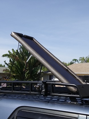

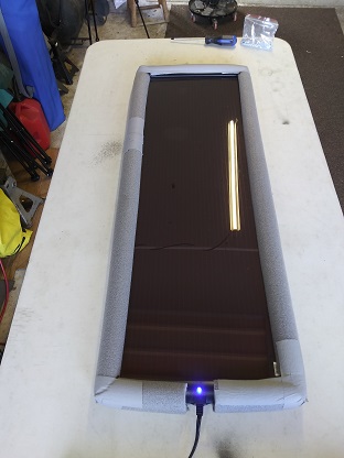

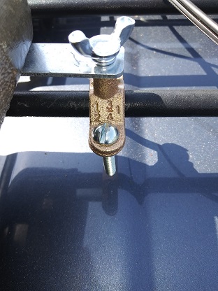

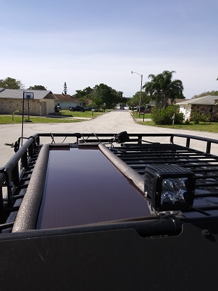

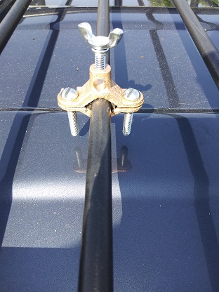

I purchased one of the Harbor Freight Thunderbolt Panels in early March. After liberating it from a 30 day Covid quarantine, I've been going through ideas on how to supplement my secondary battery, but in a convenient way. This is what I've come up with so far.

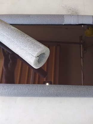

The panels come in 25W sections that you can fasten together, so I figured one wouldn't take up too much space on the rack. They're framed in plastic so I wanted to cushion it some, and had some of this HVAC insulation noodle. Cut it in and Gaff taped it, then painted it to give it half a chance of not deteriorating in a couple months.
Grabbed some electrical ground clamps and some wing screws with a piece of fuel line rubber to protect the rack and two of those will secure the back end. I will just wrap a bungy on the front, and then it can still be secure with the ability to move it around. It can be quickly removed completely if I come up with a good connection point. Not sure if I want to use this cheap controller. More to follow...

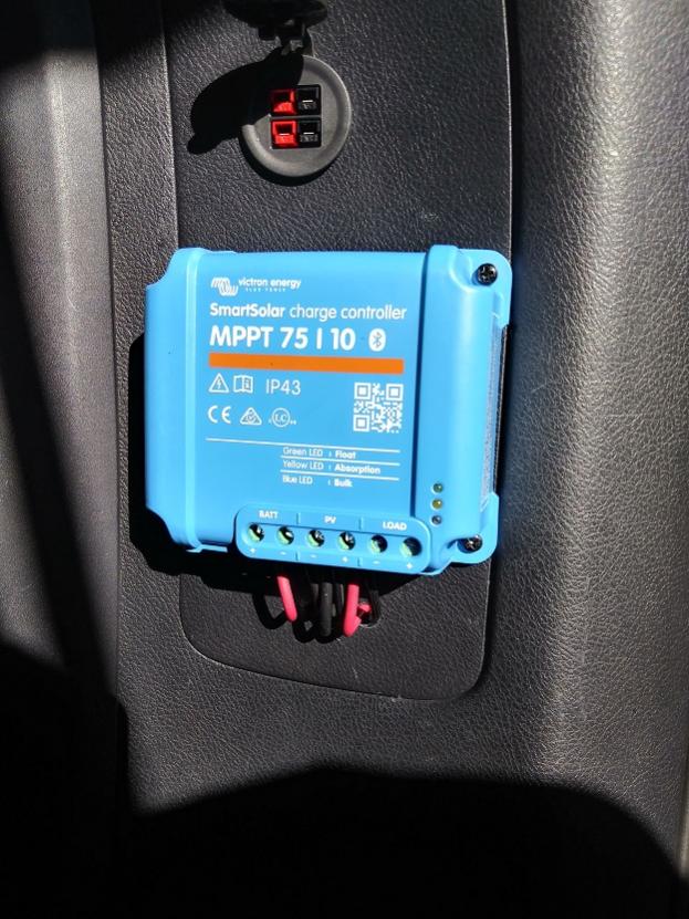

So after several msg exchanges with [MENTION=144483]Bumbo[/MENTION], who is quite the bad ass when it comes to DC power and Solar. Check out his You Tube channel, he has some amazing portable battery solutions that really pack a punch. He also wants to do some T4R related electrical mod videos in the future, so jump on there and give him some encouragement!
YouTube

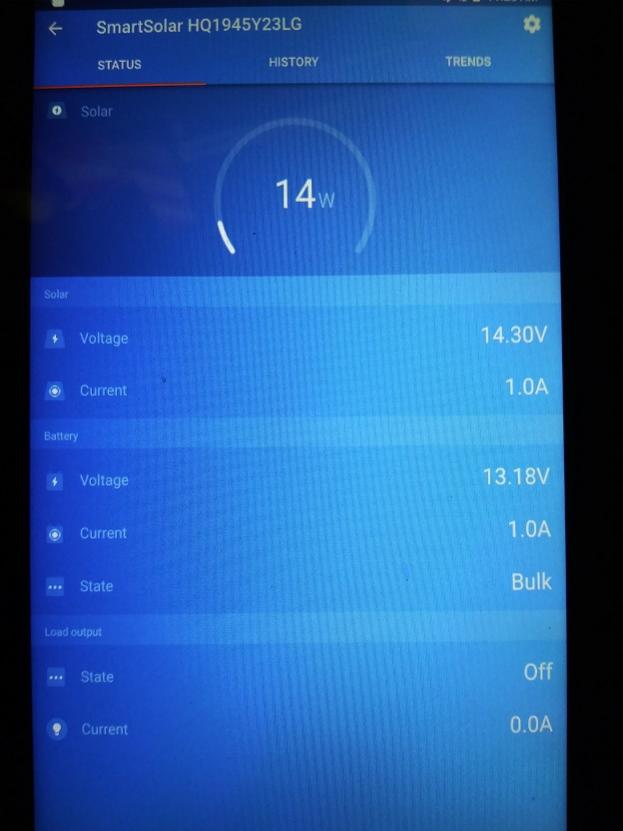

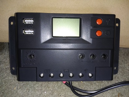

Anyway as I mentioned after our msgs, with room for only one full time HF 25W panel on the roof rack, Bumbo recommended going with a Victron Smart Controller. The MPPT controller will get better efficiency out of this little panel than the cheap PWM that comes with the HF panel. I also installed some Anderson connectors tapped into the "PV in" terminals, so that when I'm stationary in camp, I will have a plug and play option to add my Renogy suitcase panel to get a full 100W out of this array.
Testing the HF 25W panel, it only put out 16W/1A for pretty much the whole day with not a cloud in the sky. So I will be shopping for a better one that will fit in the space allowed. But in the meantime this panel will help with the load of the Fridge while underway, lessening the load on the alternator. I also installed an alternator voltage booster to accommodate the AGM batteries I run.
The Victron controller works really well, as does the BT app that allows you to set up the parameters and monitor the system from your IOS or Android device.
