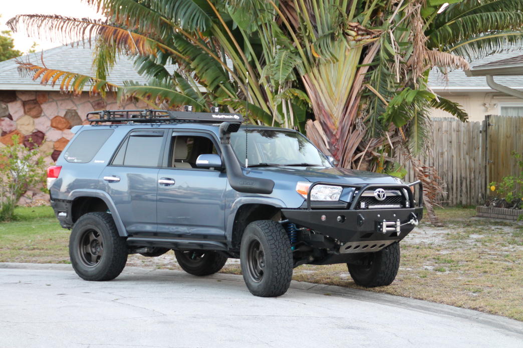

LE MAE as she sits currently
EDIT: Snorkel Added 5/3/17
Current MOD List:
XREAS DELETE!
King Adj Front Coil overs and King Rear Adj. both w ext. travel
Total Chaos UCAs
ICON Rear Springs, Track Bar, Upper and Lower Links
[MENTION=98153]MStudt[/MENTION] Sway Bar Links
Wheelers Super Bump Stops - front and rear
Safari Armax Snorkel
TRD CAI
URD Y pipe
MagnaFlow 12586
SCS F5 Matte Dark Bronze 17x8.5 w Cooper ATP 285/70/17-swapped to Cooper STT PROs 1/24/18
ARB Rear Locker and CKMA 12 on board compressor
Dual Batteries and ML-ACR
#6 AWG cable for 12v Rear Cargo Power source w TB51 Refrigerator and AC inverter
Rigid Industries
Shrockworks FB, Skids and Rock Sliders
Superwinch 9500
Baja Rack (Standard)
Wet Okole 1st and 2nd Row
Weather Tech 1st and 2nd row and window deflectors.
Rear Bumper Cover Delete.

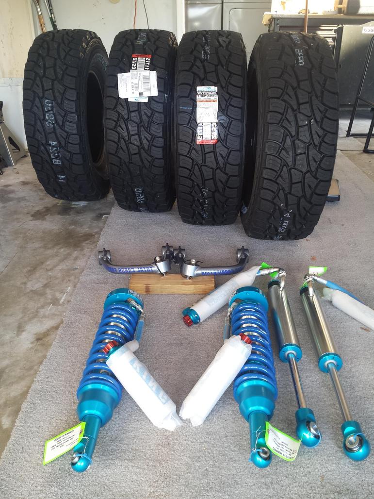

1st Mod Completed: Kings w Total Chaos UCAs and ICON rear.
Sorry I don't have much detail or procedure, but doing this install in a single car garage and working by myself with no suspension experience, I was gettin my old self beat up lol.

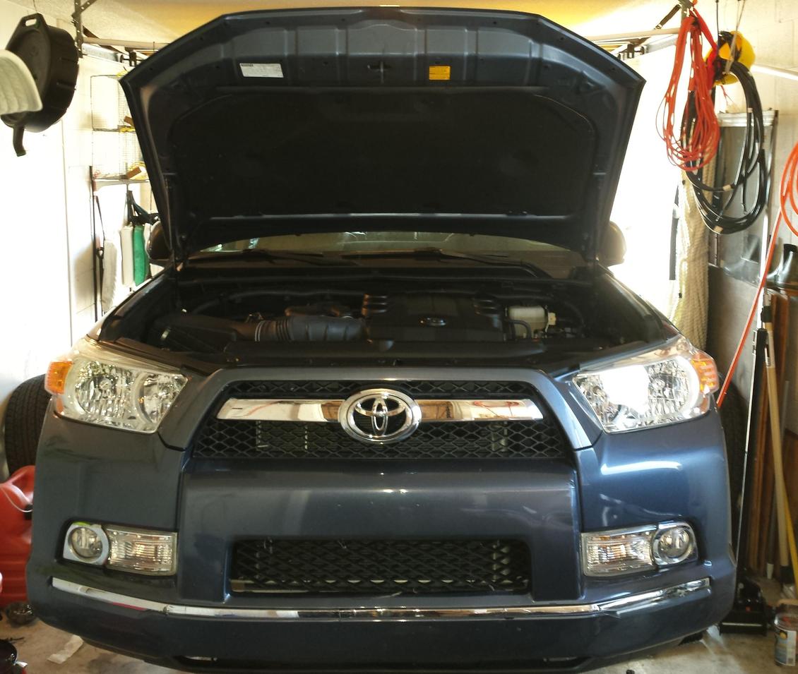

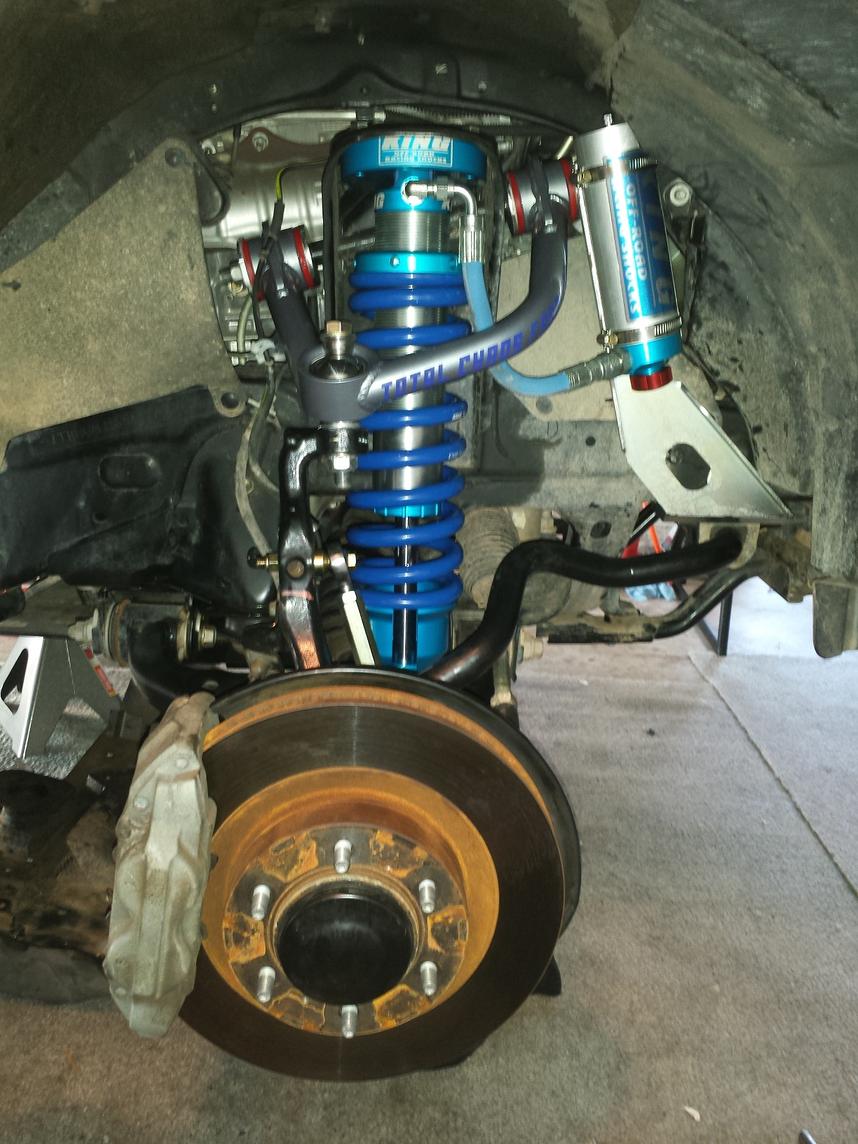

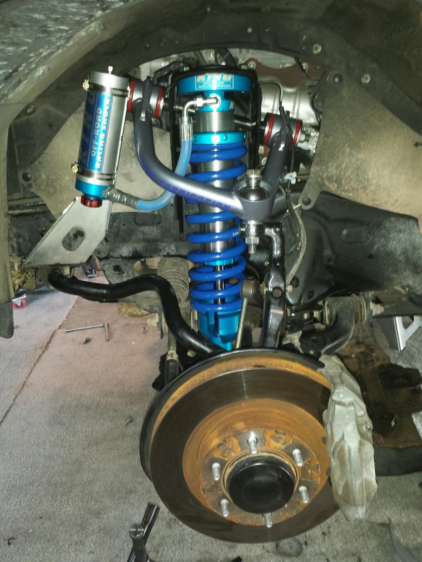

2nd and 3rd pic is front suspension mostly completed.
Still have the driver side [MENTION=98153]MStudt[/MENTION] Sway Bar link to install and check torque on everything, then I'm on to the back end. Putting in King Adj., 2" Icon springs, Icon Trailing arms, Upper Links, Track bar, and MStudt rear Sway Bar links, so any tips, warnings, encouragement, and ugh (criticism) :smow: is welcome.View attachment 247370

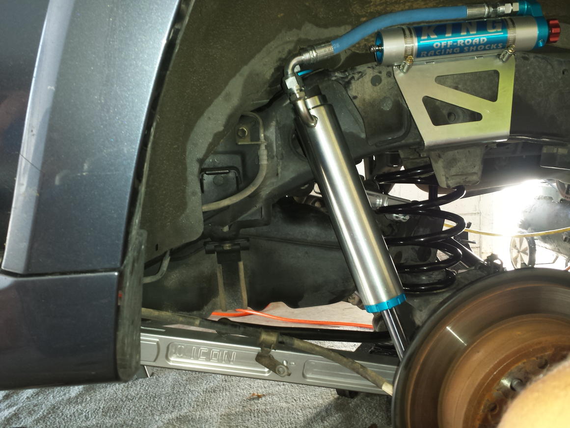

Here is the rear suspension coming together and the new tires and wheels.

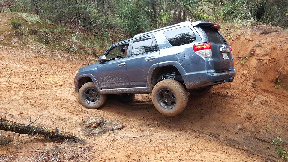

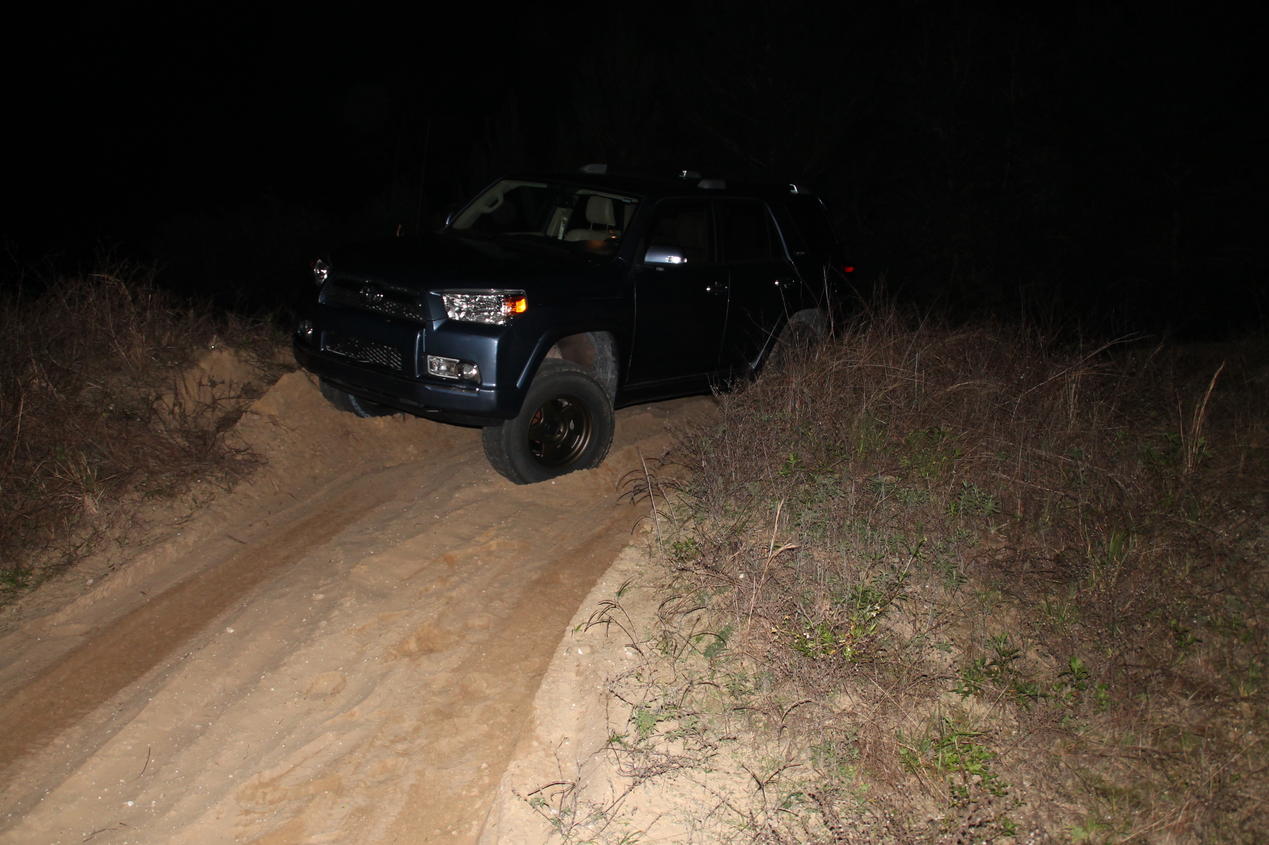

Evening test drive, nothing serious, a little sand to see if anything might be loose. Seems pretty solid. Road manners are good as well. My alignment tech told me the Total Chaos UCAs had the camber/caster in spec, he only adj the toe.

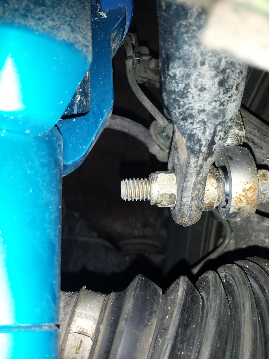

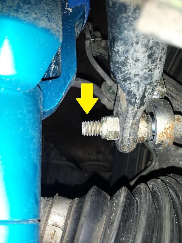

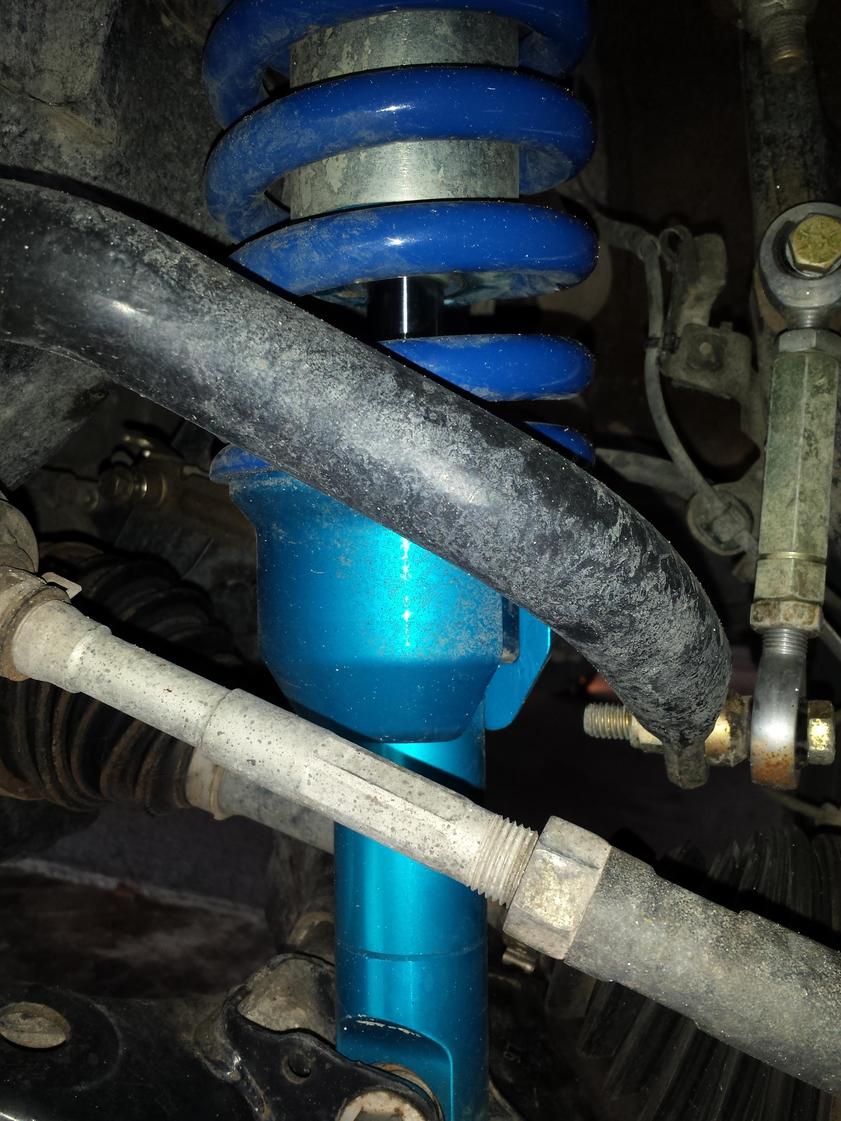

[MENTION=75328]DannyLlama[/MENTION] I have MStudt Sway Bar Links so this configuration might look a lot different than what you have.
The lower bolt of the link sits pretty close, but they haven't come in contact with the coil overs. I didn't measure, but Sway Bar itself has almost an inch of clearance.

Do you feel like the Sway bar links dropped your sway bar a bit or allowed for better fitment of the sway bar and coils?

I refer to my default response, I have a lot to learn about all this stuff lol, but being adjustable the MStudt-Links definitely give you some wiggle room. The King reservoir brackets drop the ASB a 1/2" below stock as well. I just shuffled everything around until I felt comfortable with it. I wonder if this bolt (Arrow) could be replaced with one a 1/4" shorter. Maybe I don't have it installed properly. I haven't played the radio for a couple weeks listening for any errant noises under there. I beat the truck pretty good on the trails last weekend and nothing rubbed, banged or had catastrophic failure. So my installation work seems pretty solid. I'm going with [MENTION=98153]MStudt[/MENTION] Discos anyway in the hopes of some extra articulation. All this being said, this system has dramatically improved the handling on the pavement in the corners and on the hwy. The stock set up kind of wandered at hwy speeds. Hope this helps.
