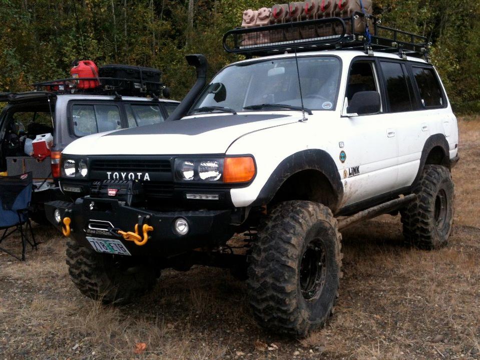

I might as well hijack T4R with my Land Cruiser since I already started going down that path. Let's see...I built some drawer slides for my heavy ass Pelican ice chest. And welded up a 4x4Labs water can rack:
My favorite mod, 37" tires!!!!!!!! 37x13.50/17 Nitto Mud Grapplers. Love these tires. Sounds like I'm being followed by a Cessna. I've been told it will sound like a B52 bomber after about 10k miles.
The day they were installed
I had some rubbing of course. I refuse to lift the truck any higher so that means it was time to start cutting and grinding.
Notched the inner fender and pushed it up to give more clearance
Took 3" out of the outer fender. Instant lift! Next up will be reattaching the inner and outer fender then giving it a finished look. I will also trim the rear fenders.
I also built a roof rack. Spent about $150 in metal. Not too bad! Full details can be seen here: My 4x4 needed a roof rack so I built one! - Imgur

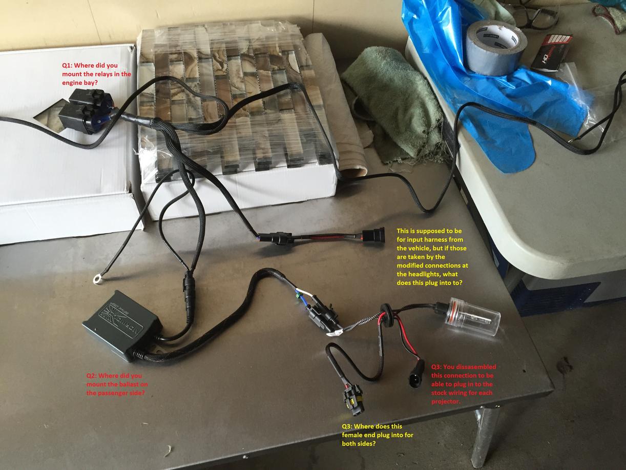

Hi,
Ok I got my flame suite on but I got few different sources and after looking at it for 30 min I figured ill just ask someone who did it already.
I got a question with regards to the installation of the HIDs that you did. So I bought the same kit and everything.
1. Where did you mount the relays?
2. You mounted one ballast on the battery bracket, where did you mount the other one?
3. You made the "custom" connection between the stock wiring harness for the projectors and the male connector that came pre-installed in that rubber ring which mounts into the grey cover of the headlight (I assume this was done for both sides).
Where does the female (yellow) connector at the other end of that little jumper plugs into to for both sides?
Also what does the input "power/signal" to the relays plug into to?
Please see photo attached with questions. Thank you.
