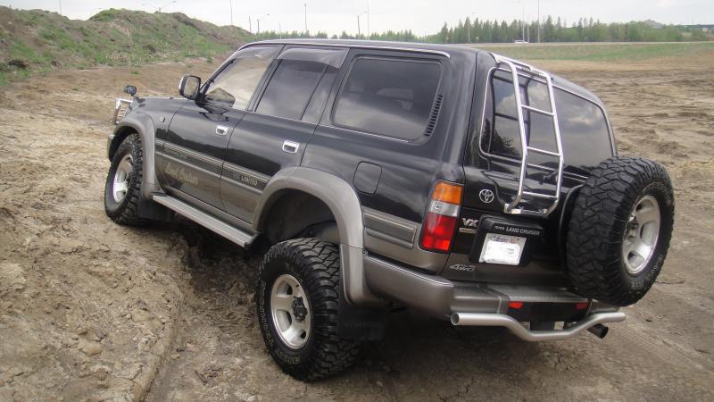

While not related to my pavement princess, it's still Toyota so I figured you guys would enjoy the pics. Went to play on the local lake bed with my buddy in his 3rd gen. Miserable weather but fun times!
wow I love your 80s. I used to have a 1HZ right hand drive with 0 rust and 100,00 kms for a diesel with one previous owner. They are truly great vehicles!
